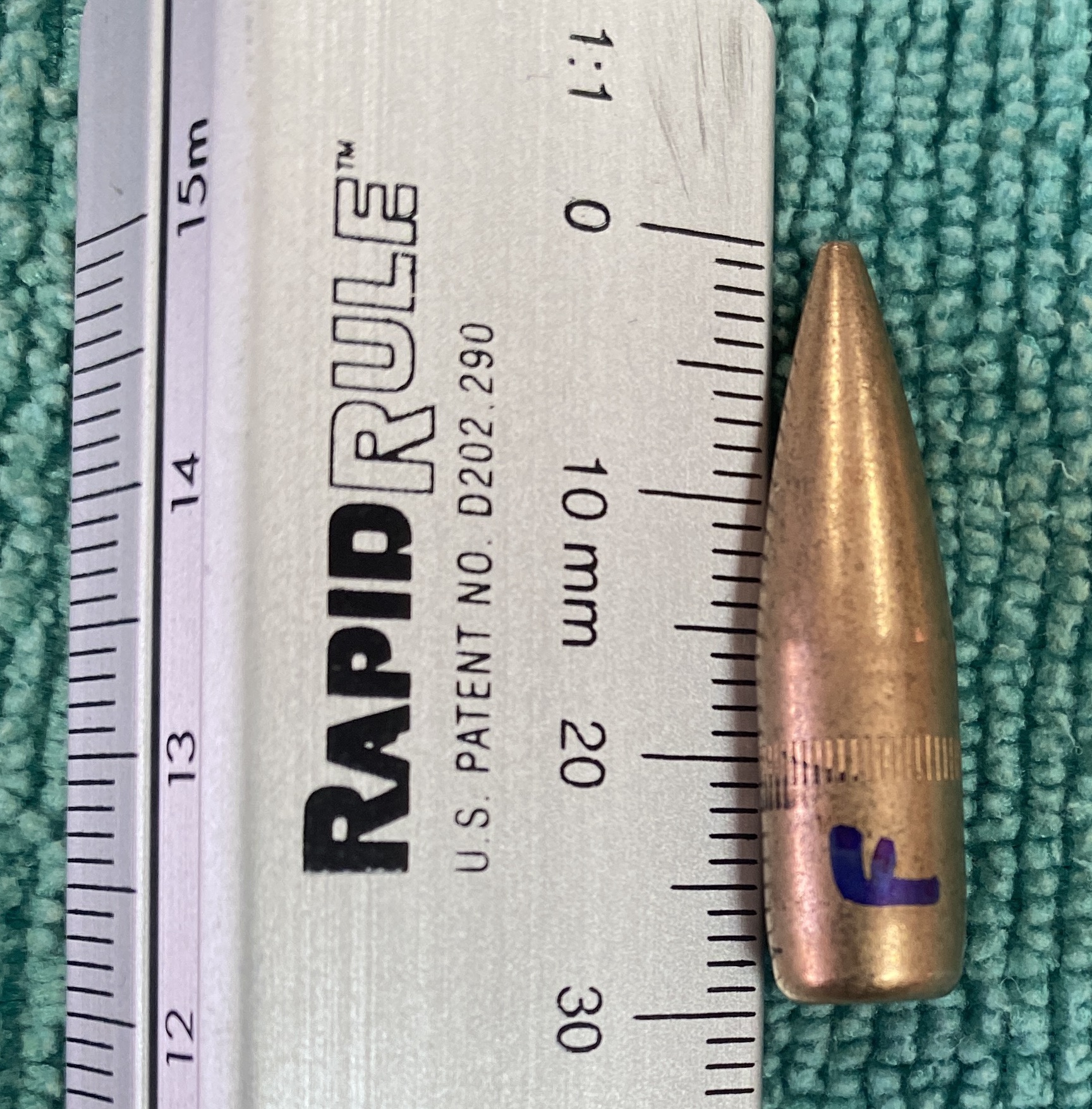

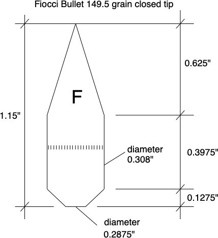

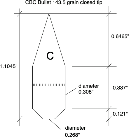

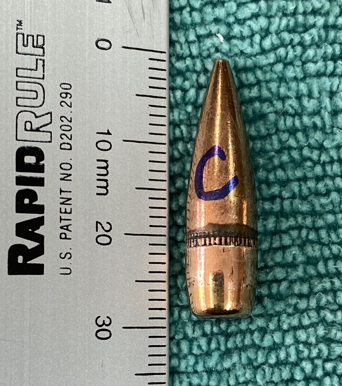

Friends, I e-mailed both factories (Fiocci and CBC) and the best I could get was a G1 coefficient for one of the bullets. Can you guys venture a G7 BC for each of the two bullets below? Even better would be a similar in the Applied Ballistics universe that I could select to use in building my profile. They are modern day bullets from military cartridges sold by the container to governments around the world, so there must be something quite similar in the existing commercial BC's. I drew the tips as triangles, so please look at the photos to get an idea of the shape of the ogive. Weights and other data I added to my lame drawings. Measurements I took with a digital caliper.
I will then use these G7's and calibrate the results with the "Calibrate Muzzle Velocity" on the Kestrel to fine tune a cocktail that works.
As always, I am most grateful for your help!

Why not just use the G1? You can’t get a G7 by just making something up
I was thinking that this might be a thing of matching a known geometry or finding something similar. God knows I have no idea of how a G7 or AB BC is calculated. I ask because that's what I have and you guys (and gals) are the ones in the know.
They use Doppler radar. G1 is basically a formula. Nothing wrong with it. Just maybe not as accurate out of the box. G1 and shoot
