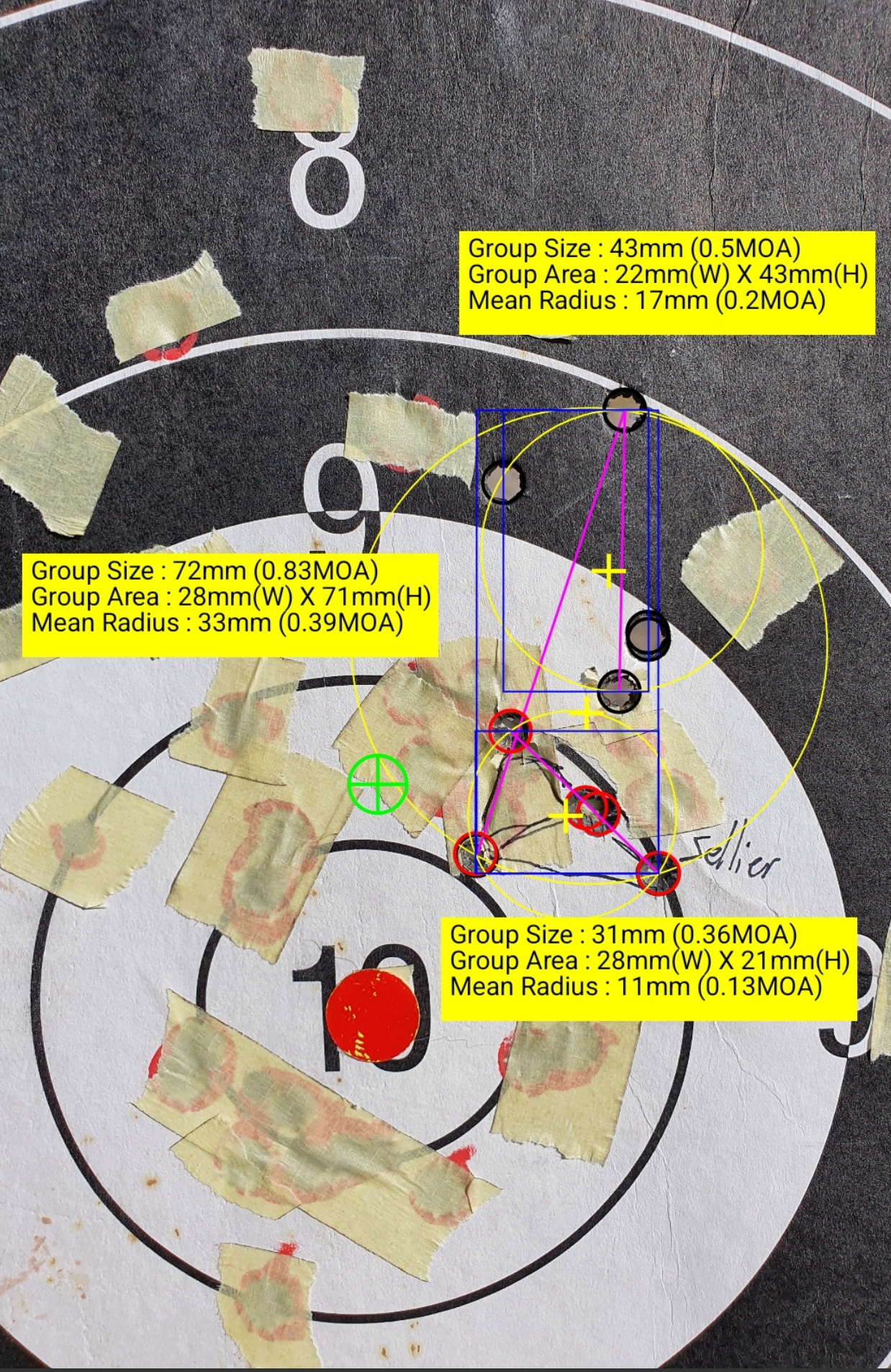

But I know that I was directed off from N555 towards N160 for 136gr in 6.5CM and I am fully enjoying that advice. The N160 plays out really well. I think So far even during load development at 300m I have not struck a bullet (Scenar 136gr) outside 1moa.
This is 2 different cases in test, Sako @2900 and Sellier @2841. COAL 2.737".
