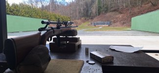

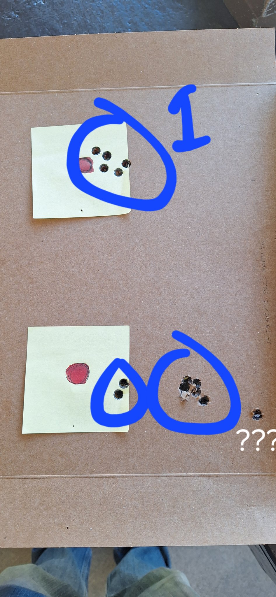

For anyone who saw my thread in the vintage forum and those who didnt, I picked up this Model 70 sight unseen the other week. I refinished the stock and cleaned it up first thing. Today I got the rifle out to the range, I had loaded up 20 rounds.
Imr4064, hornady 168 bthp, petersen srp brass and a cci br4. Loaded as long as humanly possible.
This rifle, per my investigations, is throated for something much longer than the 168s. So I went as long as I could while maintaining concentricity.
The Unertl was easy to set up and the markings on the AO seem accurate. Optically it was more than acceptable. Adjustments were as accurate as I could figure them to be. Generous eye relief and an average eye box.
The stock is way too short, has a less than ideal geometry for bench shooting and the trigger while very light isn't what I'm used to (tikka). The odd carved out grip isn't my jam either, my hands are too big for it.
That being said, once I put a few rounds through it I got myself dialed in somewhat. I was able to pull off that small group on the far left which measures 3/8" at 100 yds. It's only 4 rds unfortunately as I kept having light strikes and for 1 of the shots i didnt reset the scope. Usually i test a rifle's accuracy with a 10rd group. I suspect the firing pin spring is weak.
Is that a fluke group? I have no idea. I need to shoot it more. I only loaded 20 rounds, in case it was a piece of junk. It is however, promising. I'm going to replace the firing pin spring for a start and take it back out after.

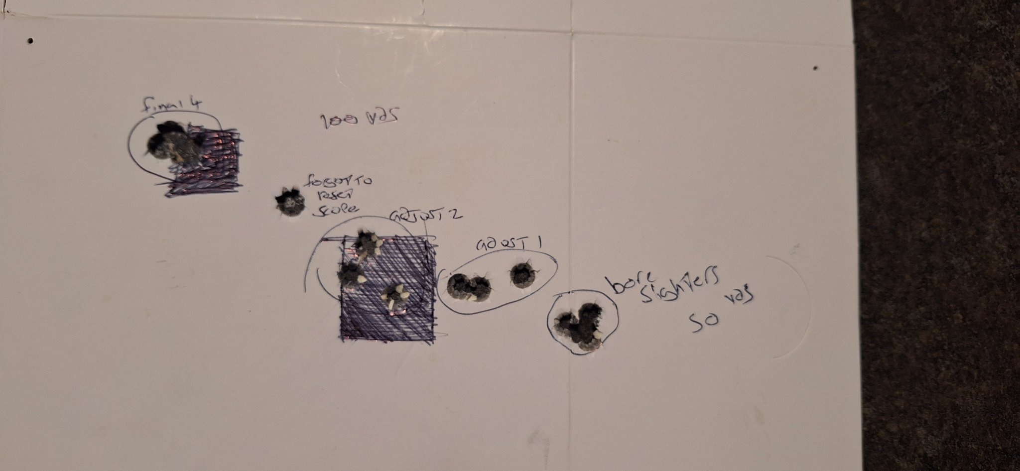

OK I took it out again today
I loaded a few up to test a different primer (fed gmm) and that coupled with a good cleaning of the bolt I had no issues firing.
However the zero felt like it kept shifting after my first group. I shot 5 in the top target, adjusted, next 2 are on the bottom post it. 3rd way off ???
But the last 5 are in that tiny group there with the slight flier (called). I checked my action screws, mounts and bases, all tight. Scope pulled back for each shot.
I've got not experience with the external adjustment scopes. I adjusted it the wrong way clearly as well. Does it just need to 'settle in'? Any ideas?
I have zero issue with modern scopes on modern rifles. My nightforce holds 0 session to session and adjusts perfectly and rtz after dialing.
