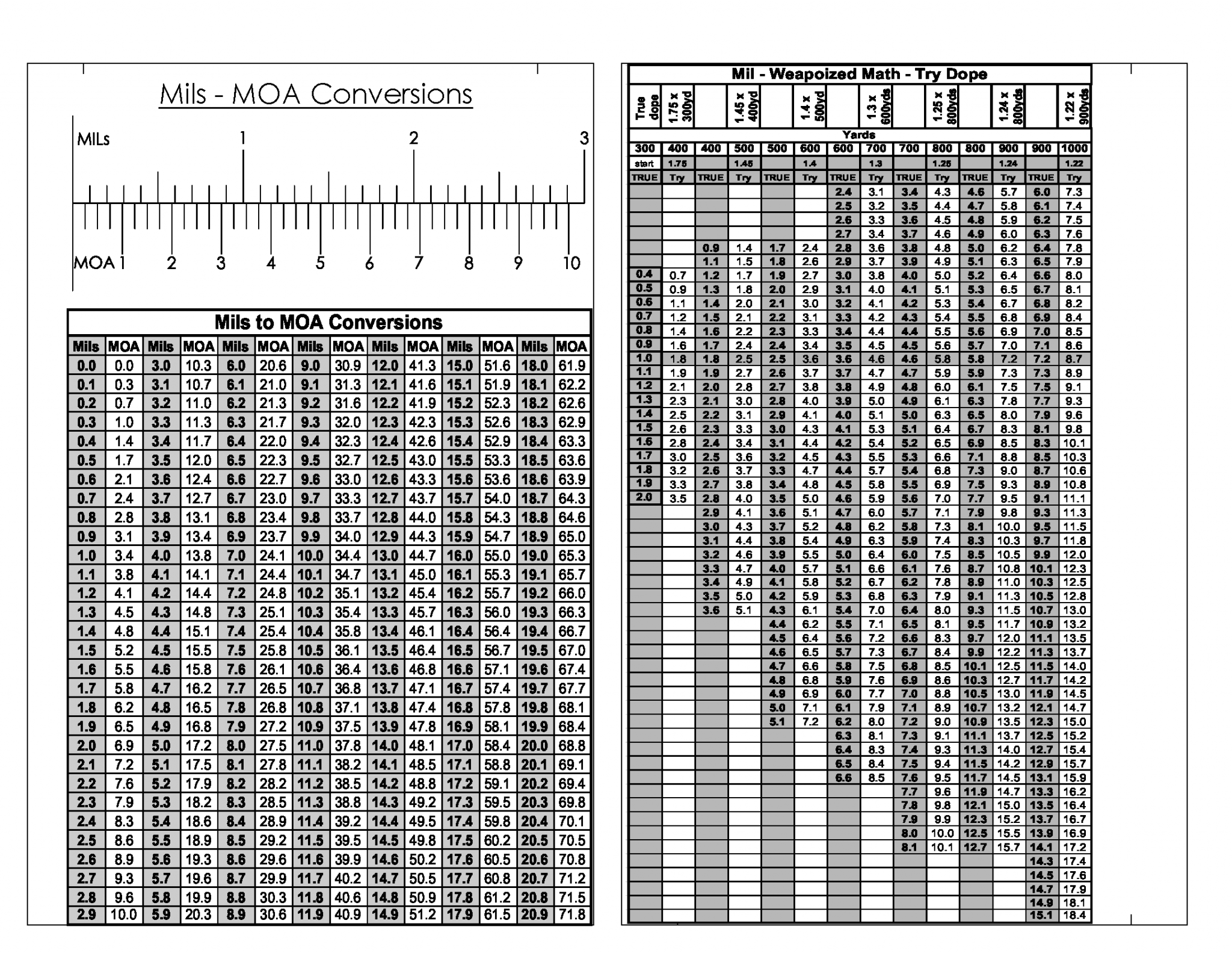

Most calculators have graphs and charts included,
But this is an entire ballistic calculator on one page

And to try to understand how to use those charts, might want to begin here
