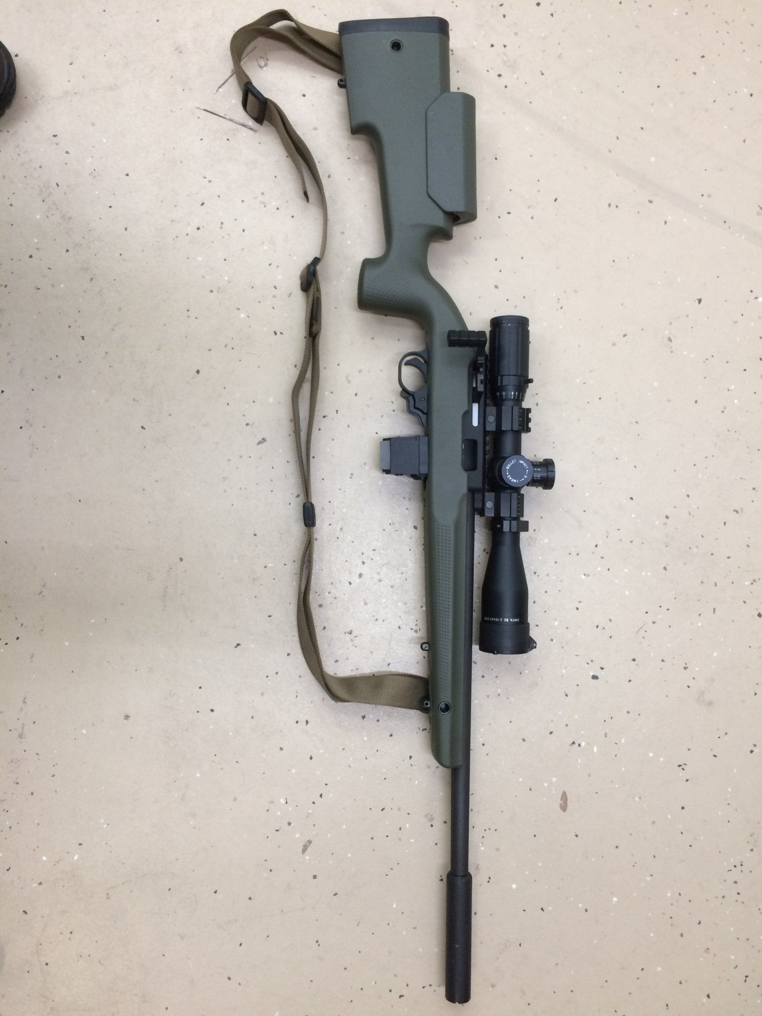

If you can get it to work reliably then the summits are a lot of fun. I fought lever tension and feeding/extraction issues for a couple of years on my summit fedderson build before it got fairly decent. The barrel shim spacing is very critical and summit/volquartsen’s instructions are not very helpful. tried using it for an appleseed event four months ago and wound up swapping it out for the kidd instead. Reliable feeding issues again forced it out of service and I have not touched it since out of disgust.
I might try a different barrel in the future to see if that changes anything. Summit barrel tenon hole is on the tight side as I cant heat it enough to fit a kidd barrel, but it will take a factory ruger or fedderson just fine with a heat gun.
To be fair, one guy at a tac steel match runs an original pws summit with their carbon barrel without any issues, I envy him. I so badly want a fortner action and this is the closest affordable alternative.

Took this out back today and ran 70 mixed brand leftovers as fast as I could through it. No failures at all and only a couple rough feeds that still cycled with a little extra force. No extraction fails either. (Mixed brand leftovers means cci,aguila, geco, thunderturds, sk and ancient federal hi powers. I would bet the high cycle force ones were thunderturds). Startled the neighbors horse a couple times with the supersonic crack of the fed hi powers, suppressor cant hide that.
I think during the appleseed shoot I got out of sequence under timed stage pressure and caused a couple of issues because of my own user error. This rifle has turned into a real love/hate relationship much the same way I love/hate Eley Edge ammo (stack 9 out of 10 on each other and number 10 takes a 1” stroll outside of the group). Today was a great day, but I’m still on the fence with this one. For a competition I’m going to grab the vudoo.
Reliability upgrades have been a volquartsen firing pin, spring and extractor, and a Kidd extractor. Cant remember which extractor is currently installed as I had fte’s with both of them and the factory pws extractor. Think it is currently a Kidd part. Lever torque force is just enough to snap over cam action when closed. Comparing mine to a new factory volquartsen I handled at MHSA my cam over force is about a third of theirs, but that is what it took to get reliable.

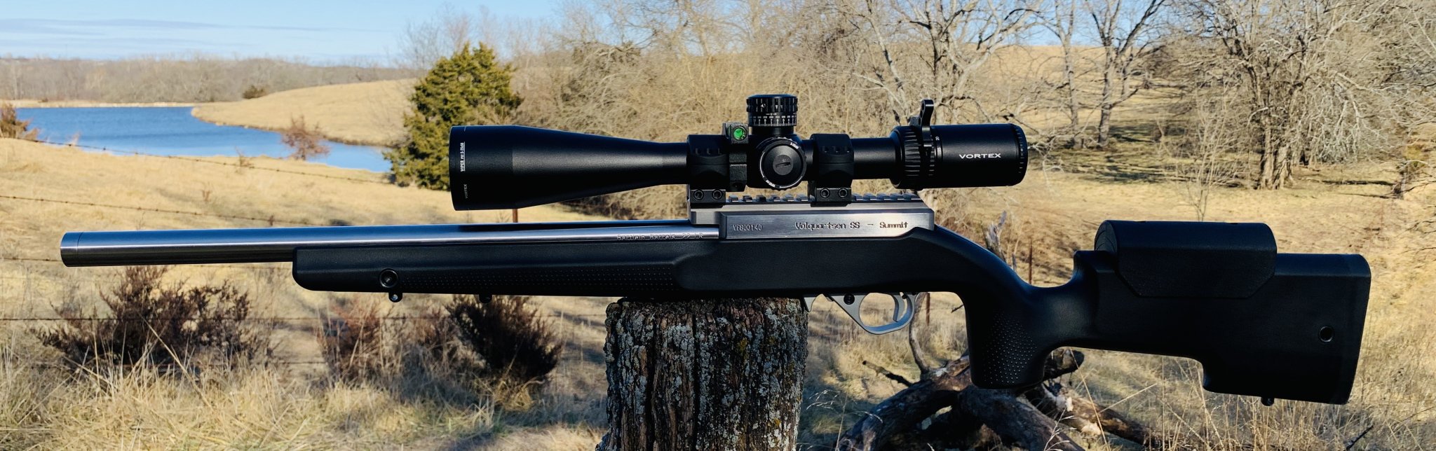

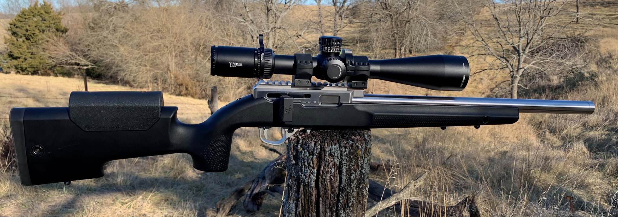

I put together a SS Summit, Bartlein 18", Kidd Trigger, Victor stock. My results are good, not great. Accuracy seems to be equal to a Kidd super grade, less than my Vudoo (probably to be expected). Shims were not hard, just time consuming as the barrel to receiver fit was tight. Didn't know a better way besides guess and check. Works well now. No issues with feeding or extraction. Overall it doesn't get shot much but isnt for sale. Fun gun to shoot.
View attachment 7547321View attachment 7547322
Thanks for the report!!!
