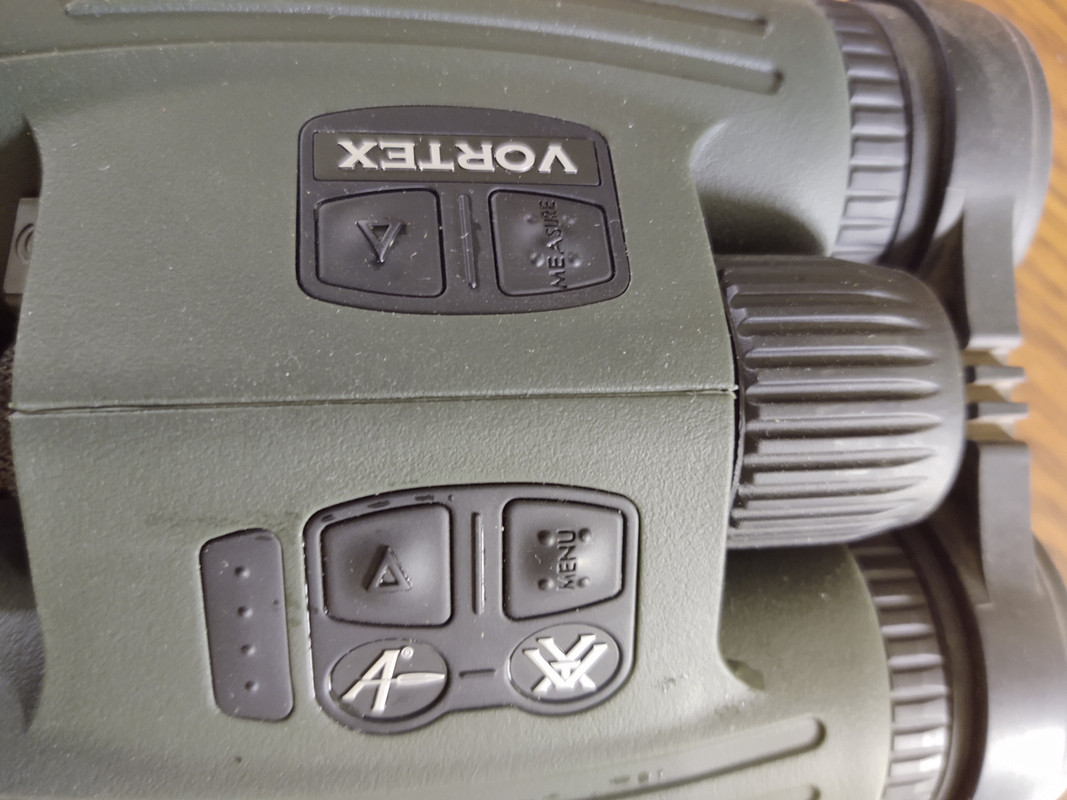

The buttons and armor on the Furys were tactile, well laid out, and appear solidly constructed

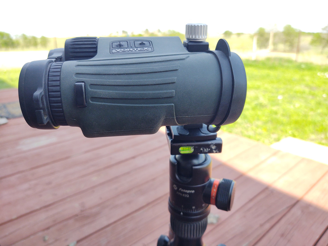

The pro mounting system includes a stud adapter that threads right in and stays on pretty much identical to the Outdoorsman’s system, but they are not compatible. But the threads are standard, so any standard tripod system will work​
And like most binos these days, the front hinge cover removes to reveal a threaded socket that accepts standard bino to tripod adapters. Overall, they felt solid, well-made and I really could not come up with any complaints on the physical design or ergonomics of the Furys.

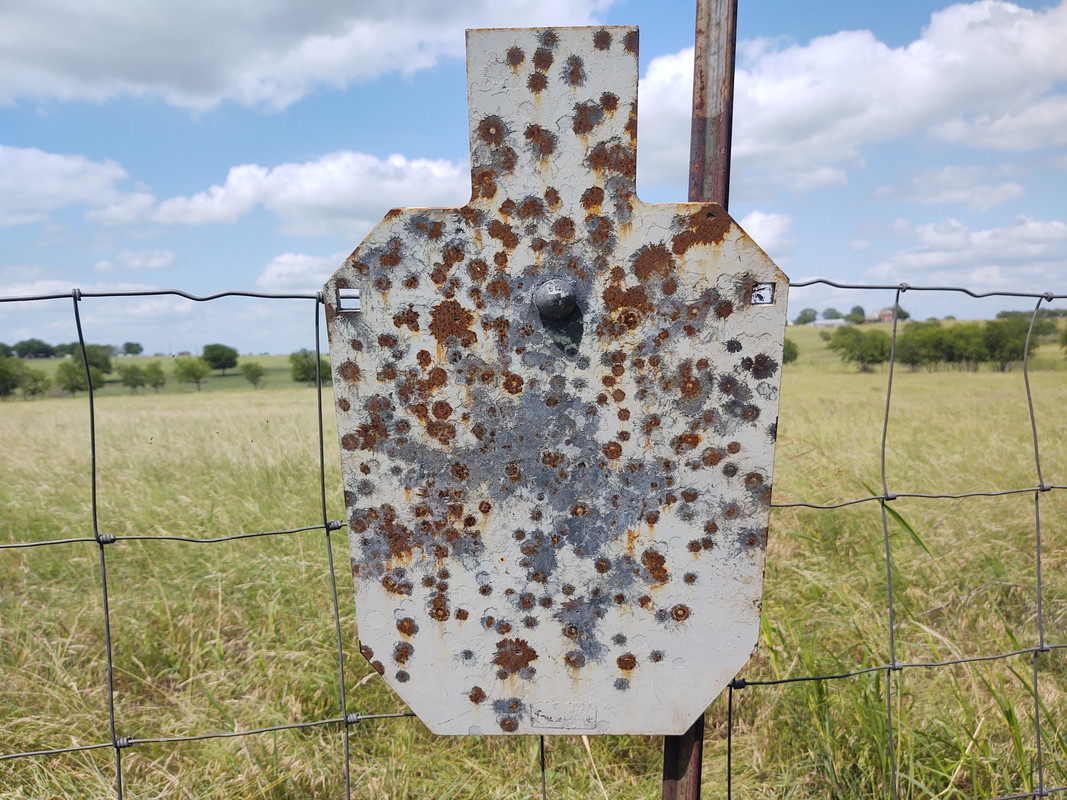

Finally, in order to get an idea of how the Fury will fare on the range, I setup a 2/3 IPSC steel target so that it was skylined. The target was not repainted, I decided to leave it shot up and marked so I could see how it would do under the tougher conditions of a target that had been hit a bunch, not shiny and reflective.
This is the IPSC plate I used for testing. I utilized it without fresh paint so that the conditions would be applicable to more situations​
Under a bright noon sun, I was able to hit the plate out to 611 yards with the Furys. In comparison, the Leica was able to hit it once at 875, but more consistently, was limited to about 750 yards.

Vortex’s pro mount installed easily and provided a quickly employable but very steady connection to a tripod for range testing​

Wind values are quickly set using the arrow buttons on the Fury. The long rectangular button at the top left enables the wind bearing capture mode, where direction is set by utilizing the onboard compass, and speed is set using the arrows by the user​
In terms of capturing wind direction, it’s not any slower than using a Kestrel, you just don’t get the actual windspeed, that you have to estimate manually. But as I mentioned, many people prefer that, as wind conditions between the shooter and the target sometimes call for a different value than what is experienced at the shooters position. Overall, I found it easy to use and very quick to adjust, and I appreciated the additional accuracy it brought to my manual wind calls, and therefore, my overall ballistic solution.
