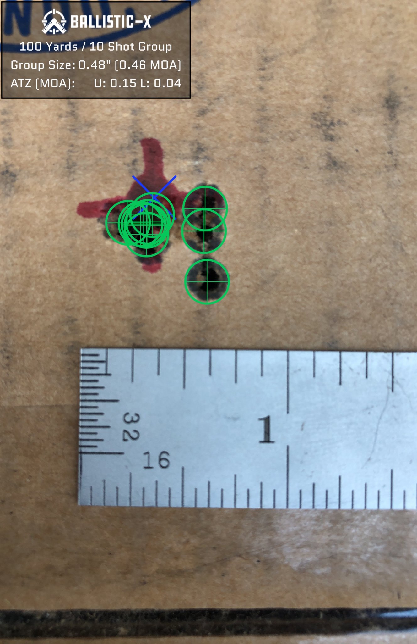

I've had random groups of .5" at 100 yards. Maybe 2 out of 10 or so but haven't been able to average that. What I was showing above was an average of groups, not a single group. My average with just a bench, bipod, and rear bag with SK Rifle Match at 100 yards was .98"
I used a Caldwell sled yesterday to shoot a few groups and found that my group size averaged .75" at 100 yards using that tool and I feel that even that could have been tightened up some. The .2" difference at 100 yards without the sled is all on me (shooter skill).

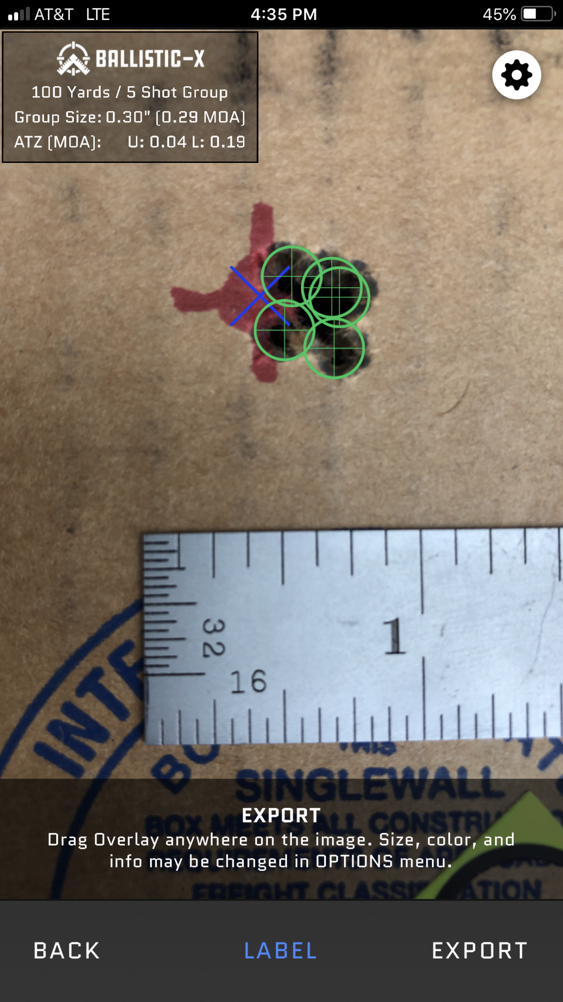

I did cherry pick this group but all were under 1” at 100. I tried Lapua, Wolf, CCI SV, SK Rifle and Aguila. I shot at 50, 75 and 100 and Wolf consistently won at every distance.
Yes sir, Wolf Match Extra. It’s always been my go to 22 ammo for accuracy. Hard to beat for the price too.
I understand it’s cherry picked but Jesus it’s still impressive. I’ve got a lot of sub moa 100yd groups from my custom 10/22 but nothing even cherry picked close to that!
This was Lapua Center X and 10 shots. I know the lower right shot was me but I’m certain the others were the ammo. Still a damn nice group but the Wolf was still consistently better.
