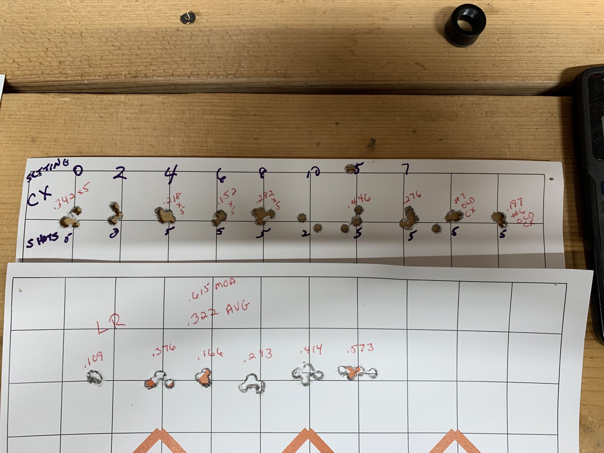

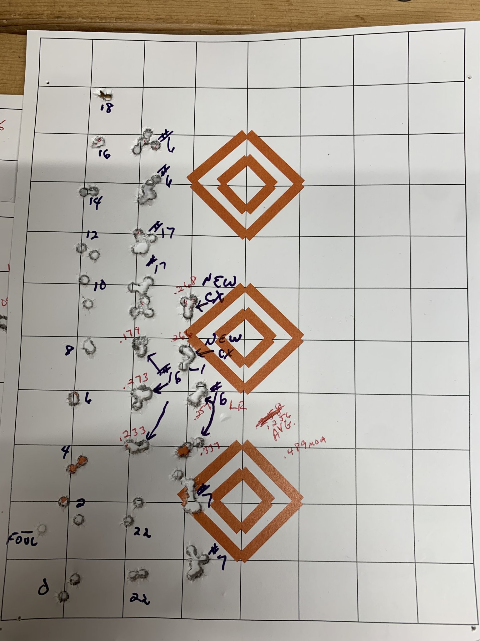

My son picked up a new V360, has 6-700 shots on it now.
I bought a brick of SK RM and a brick of SK LR to run through it when he is out of town to get the round count up, he is on the list for later this year to have it tested at a Lapua test facility.
The brick of SK RM has a ES of 50-70fps, shoots in the .4s consistently.
The brick of SK LR has an ES of approximately 20-35fps depending on the day I shot. First 20 - 5 shot groups averaged .436. Didn’t make much sense to me, good ES, but the gun didn’t like it. Speed range possibly? Have a ATS tuner for a big bore gun, managed to thread it on a plastic thread protector my son had laying around and screwed it on the Vudoo.
The last 11 5 shot groups with the SK LR have averaged .292. Could be the barrel is just getting broken in but I think it is the tuner. First 20 groups, 7 out of 20 shot in the .3s or less. With the tuner, 9 of 11 groups have been in the .3s or less.
The tuner does nothing for the SK RM with the wide ES, still shoots in the .4s.
We have run a little Midas and CX and it shoots both those well without the tuner, but holding off on shooting it until the gun gets more mileage on it. I did run a little CX through it with the tuner on just to see what it would do.
Couple pics of groups.
