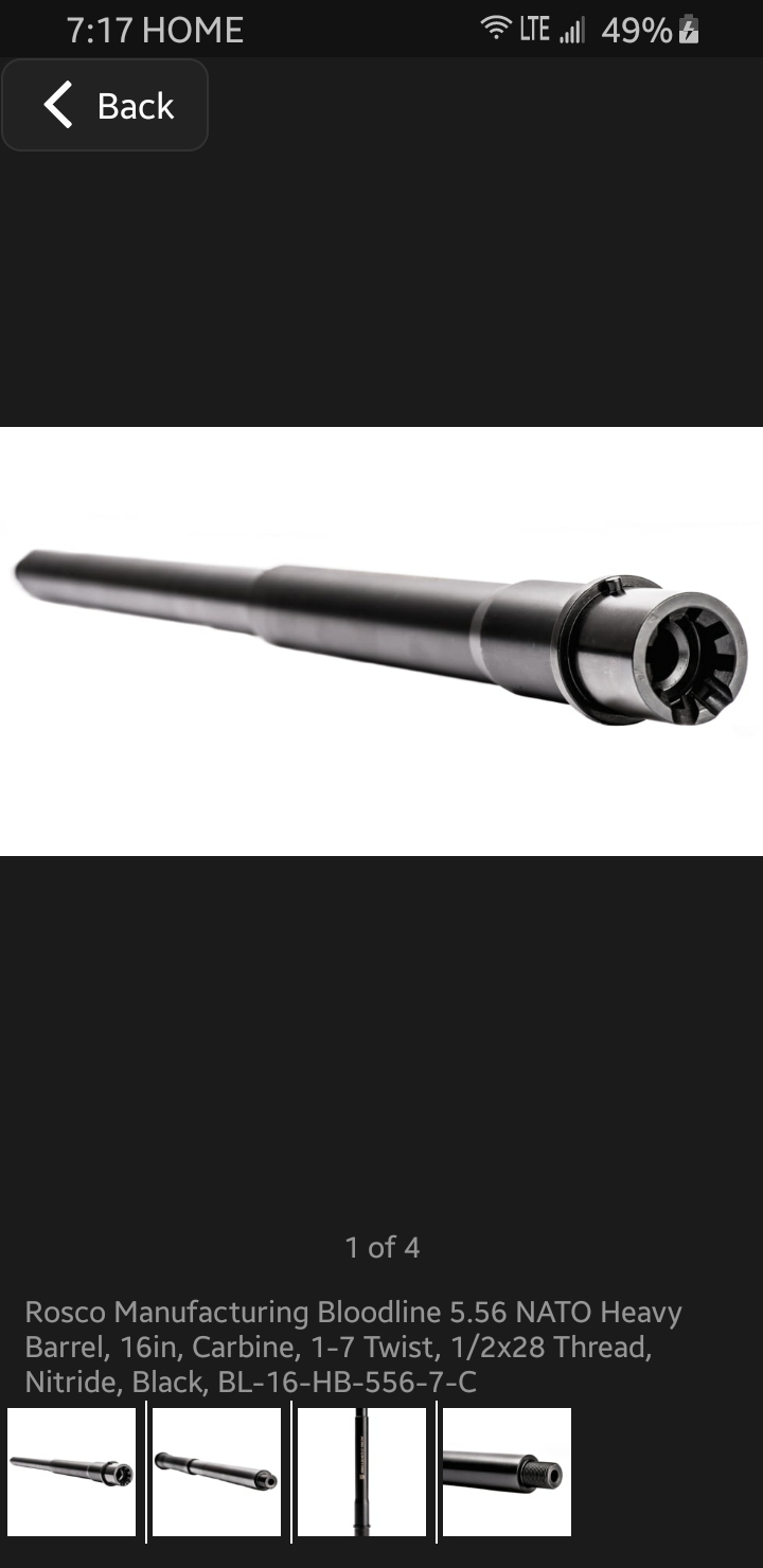

    Bartlein, Proof, Kreiger are good barrel makers you cant go wrong with but after I sought out a 16 inch barrel from each I found they were all sold out, however I went with a heavy (no barrel fluting) Roscoe Manufacturing Bloodline Heavy barrel (5.56 NATO). I love the above mentioned barrel makers but for far less cost you can simply stick with a heavy barrel profile (thick) made of chrome moly vanidium (CMV). As long as you stay away from skinny light barrels and stick with thicker heat resistant metals youre good. BUT Stainless barrels or chrome lined barrels are the other way to go for good money.
    My concern is accuracy at barrel temps with a suppressor. I want good accuracy even after a full mag of slow fired shots.
    Roscoe Manufacturing makes the exact barrel I been looking for.
