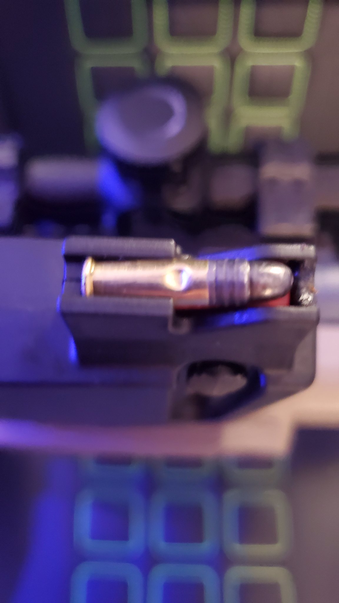

    Has anyone else experience feeding issues with their Vudoo. Brand new Vudoo built Friday. KRG Bravo stock. 2 different Vudoo mags. Center-X and Midas+ only. Seems like this may be more of an issue with the Chassis. After a few malfunctions I noticed that the magazine seemed to drop in the front causing the bolt to either completely miss the round, push in to the side of the case or push the the bullet into the back of the barrel causing deformation and if it did feed an extremely hard bold closing.
    I had saved these rounds but unfortunately stepped away from the bench and when I came back they were no where to be found. I did manage to save one though.

    Did you look at the Bravo installation directions about how to install the rear screw? You can also adjust the fore-end screw on how tight/loose the mag is as welll.
    When did you get your gun? If it was around March, it could a mag issue. That's what happened to me. They sent a replacement mag and now it's working fine. Otherwise, you'll probably have to send it back so they can readjust the barreled action in the chassis.

    The KRG Bravo doesn't always come out of the box in a way that mags fit correctly. There's an adjustment process for the chassis that will fix your issue. Shoot me a PM or give the shop a call tomorrow and we'll talk you through it.
    Edit to add: Did not see @littlepod post until after I posted. Follow those instructions....

    Had similar issues with my chosen used stock and bottom metal recently. My mag wasn't sitting high enough and I wasn't feeding reliably. Called Vudoo. They offered to either send me an extended mag latch I could try and fit, OR to send me a label and look at my whole rig. I took them up on the mag latch. After some filing, I've got the mag so that it goes all the way up and latches with no vertical play.

    So I took the entire chassis apart. Pushed the mag catch/trigger guard forward as much as possible and pushed the polymer forend as far back as possible. Didnt really seem to help at all. Thinking I will be needing another chassis or maybe a different mag catch.

    On my end, I just picked up a Xylo chassis a few weeks ago and the mag is very loose with their mag latch that I would get bolt over on the last 1-2 rounds of my poly mag. It hasn't happened at all with the aluminum mag. I ended up having to go to ARC and ask for a slightly taller mag catch which has fixed my issues.
    Does the magazine have any vertical play - even an eighth of an inch? If so, try shimming the mag latch with a piece of duct tape just to see if it makes a difference. Vudoo will provide a permanent fix, regardless of problem.
    An adjustable mag latch fixed the loose magazine and associated feeding issues with my MPA-chassis'ed V-22.

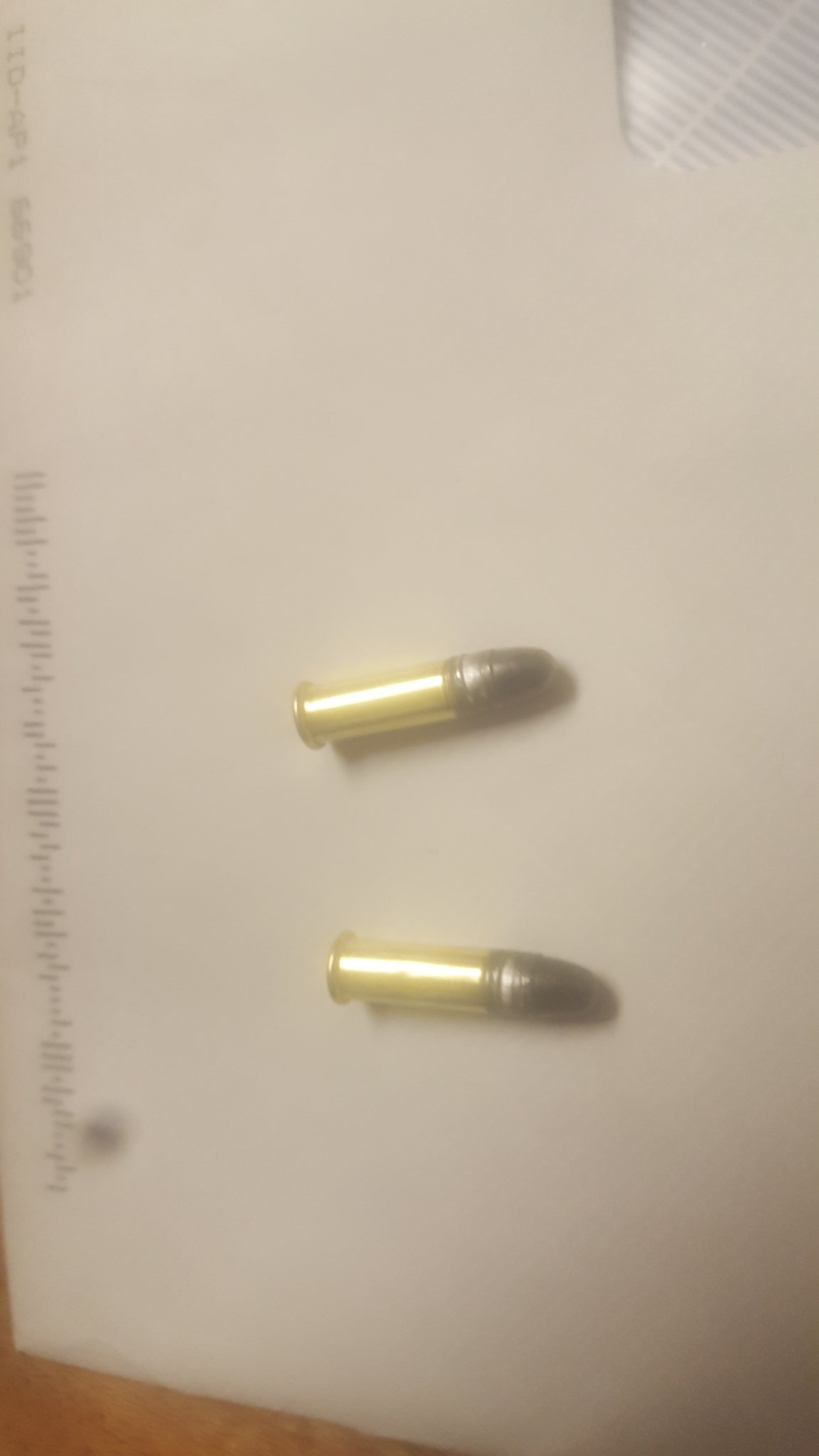

    The wind calmed down today, so i escaped to the range for a short ammo test session after work.
    I had 2 shells jam on the first or second mag run, then feeding was perfect!
    I hope for more testing this weekend.
    At 100meters CenterX i had 3/4 to 1 1/4" groups, SK std about the same.
    Pitured are shells that jammed.
    Number your mags and keep track to make sure it's not a mag issue.

    New mag #3 has fed great. Original mag #2 had no issues today, but has in past sessions.
    Original mag #1 had feeding problems again today.
    Had feeding problems with all if mag was against anything.
    There seems abouut 1/16" vertical play in mags, so i think the extended catch may help. Is fitting required?
