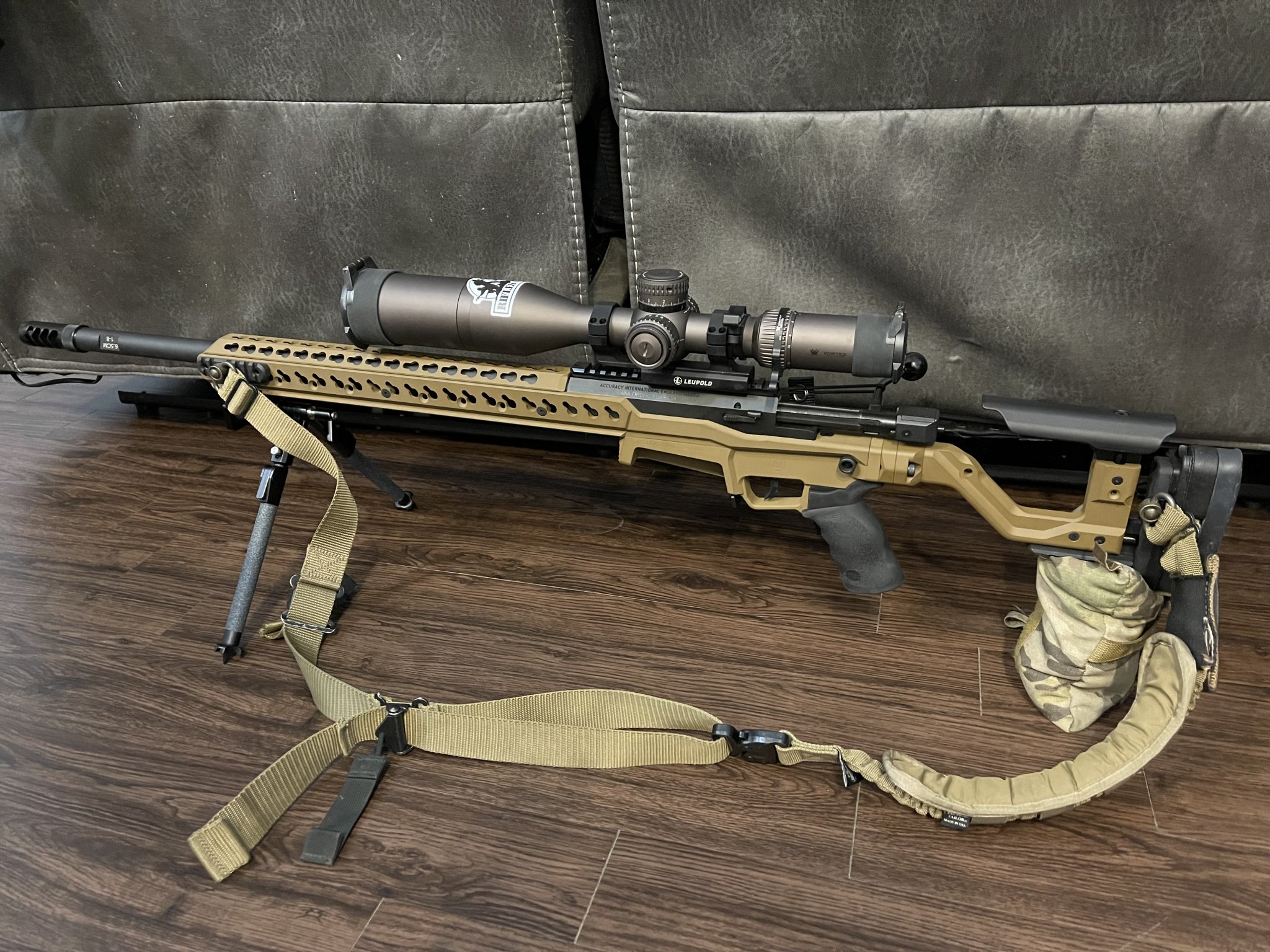

I just installed my Vudoo 360 Gen 3 barrelled action into a AI AT-X Chassis. I did have slight movement in the mags that I am using, which are the Vudoo polymer mags. I did experience a feed failure when cycling quickly, faulted on 2 out of 10 rounds. I made sure that everything was torqued properly, made sure the ammo was seated properly in the magazine, and still had an issue.
After applying the tape to the mag as recommended above, the mag movement is eliminated and I can cycle as quickly as I want with no issue.
Not a huge fan of having to tape my mags, but it does work like a charm while I look into some other kind of fix.
The Chassis is 100% worth it, feels great in action and the magazine is not a huge deal.
Im going to try a few more things to snug that mag up without tape and will report back.
I finally made an account to contribute to this post specifically, I hope that it helps anyone considering doing this.
