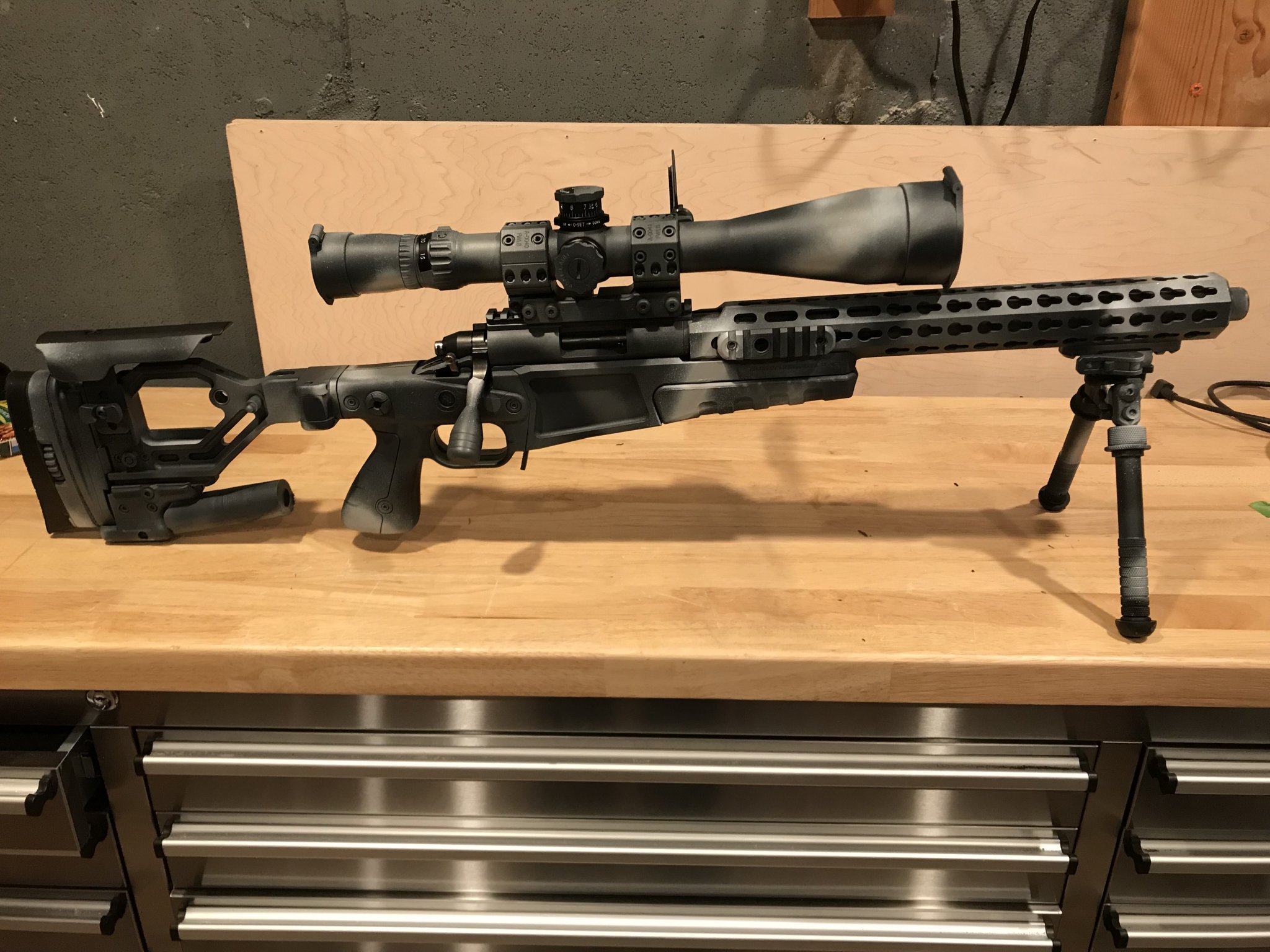

I have been a NF fanboy for years. Then I tried the G2 RZR. I don't mind the weight and I love the usable parallax turret.
Plus, to me, the glass outperforms (at least equal to) the ATACR.

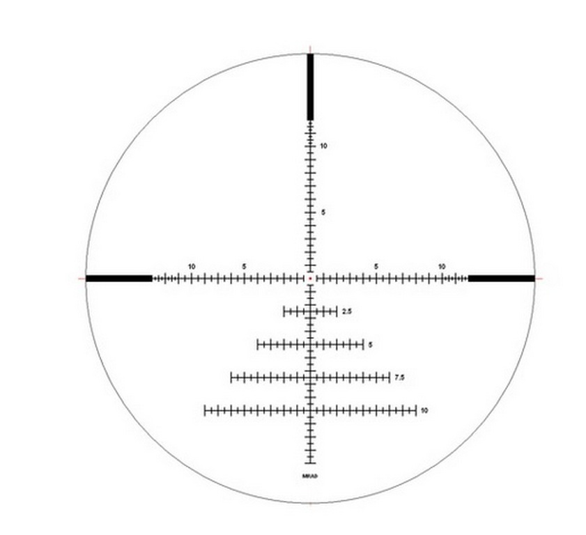

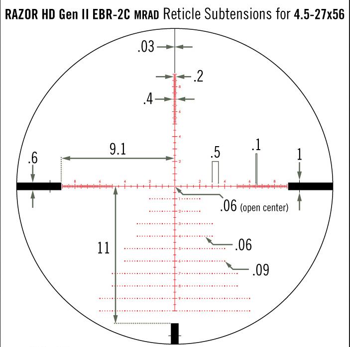

Which reticle do you prefer?
I have the pst 5x25 2c reticle. I did this since this is the reticle I have on several rifles. I really like it however when shooting for small groups at 50yd it has an issue. The issue being the center is vacant and is .25 MOA. When that is the size groups you want to shoot it is an issue. I just received another pst in 7c (today). The floating dot is .14 MOA this should aid in small groups. Hopefully, will test this theory out this weekend. I have two RAZORS and love them however, don’t see it having much of an advantage for my Vudoo and it is so heavy.
Courtesy of Vortex optics website. The 2C vs 7C. Pick your poison.

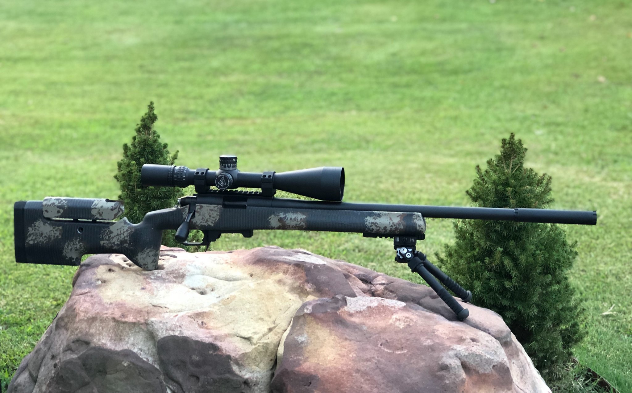

I have an AMG on mine for now. It was on there when I bought it, but it's for sale. If it sells I'd probably replace it with a nx8.
Vortex AMG 7C
25 yard parallax, floating dot, same scope on 6x47l match rifle.

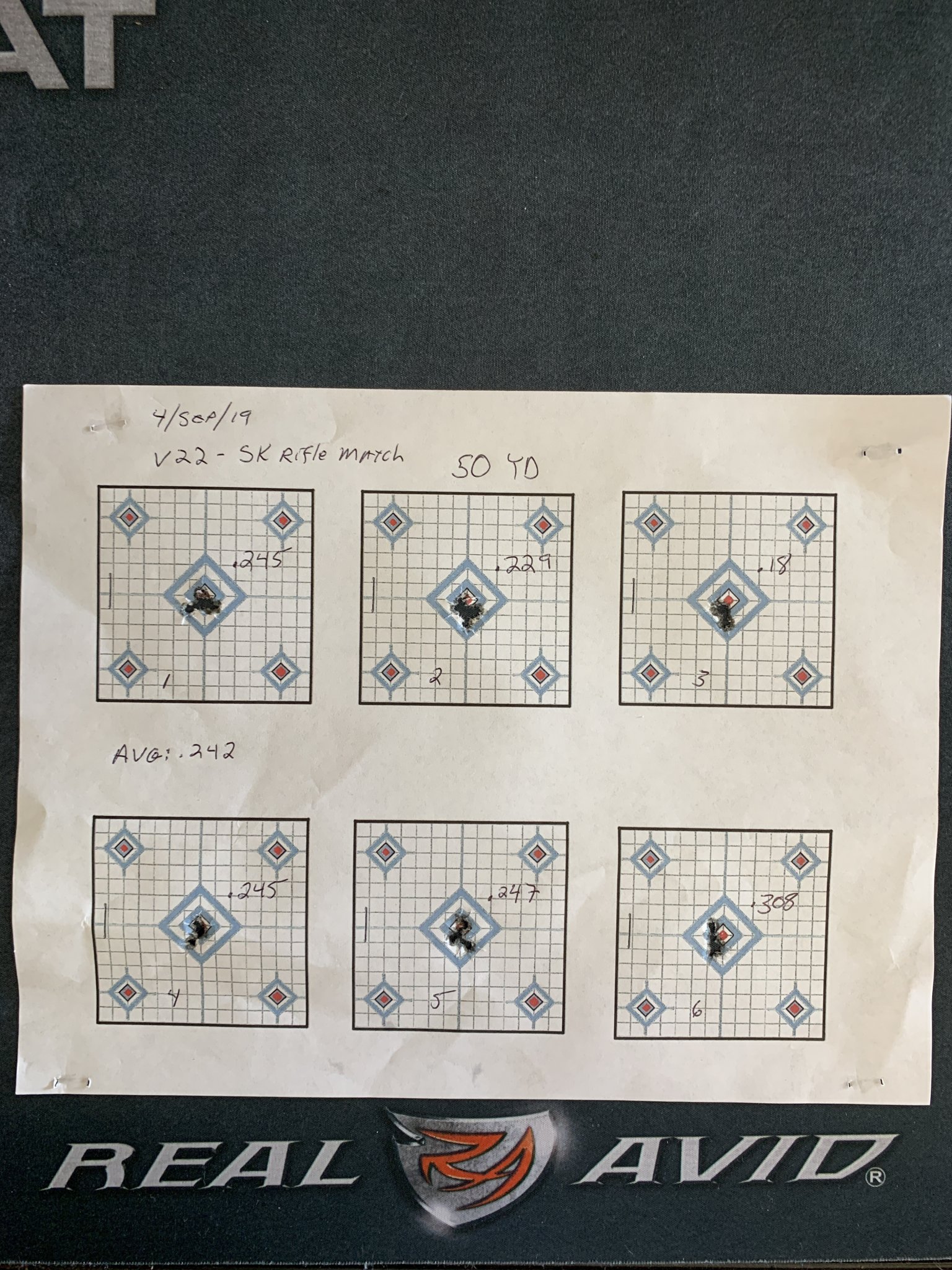

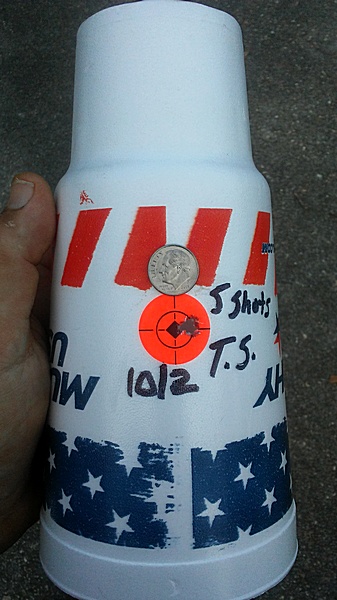

I took mine out this morning for 5 shots. Straight out the gate, no warm up shots. I do this often. It simulates a hunting situation where the first shot from a cold bore must count. I cannot stress how important this is. It is the difference between an accurate gun and an inaccurate gun.
My gun does this with astounding regularity. Sept 17...........Oct 1, and now October 2. I didn't post the one from yesterday because I had a cup that was shot up with airguns, but it was very close to the target below. I like to use a clean cup that has never been fired upon.
This is what I got at 9am. Murphy Oil cup that I picked up at a local gas station when I bought me a Banana slushy.......love those things.
By the way I'm in Louisiana , so I know what you mean.
This is what a capable shooter can expect from Vudoo. It takes practice. A lot of practice. A damn lot of practice.
T.S.

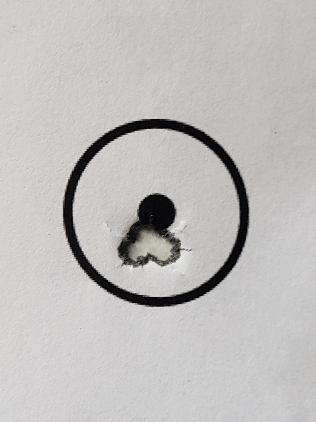

with the high mag i can segment a 22lr hole at 100

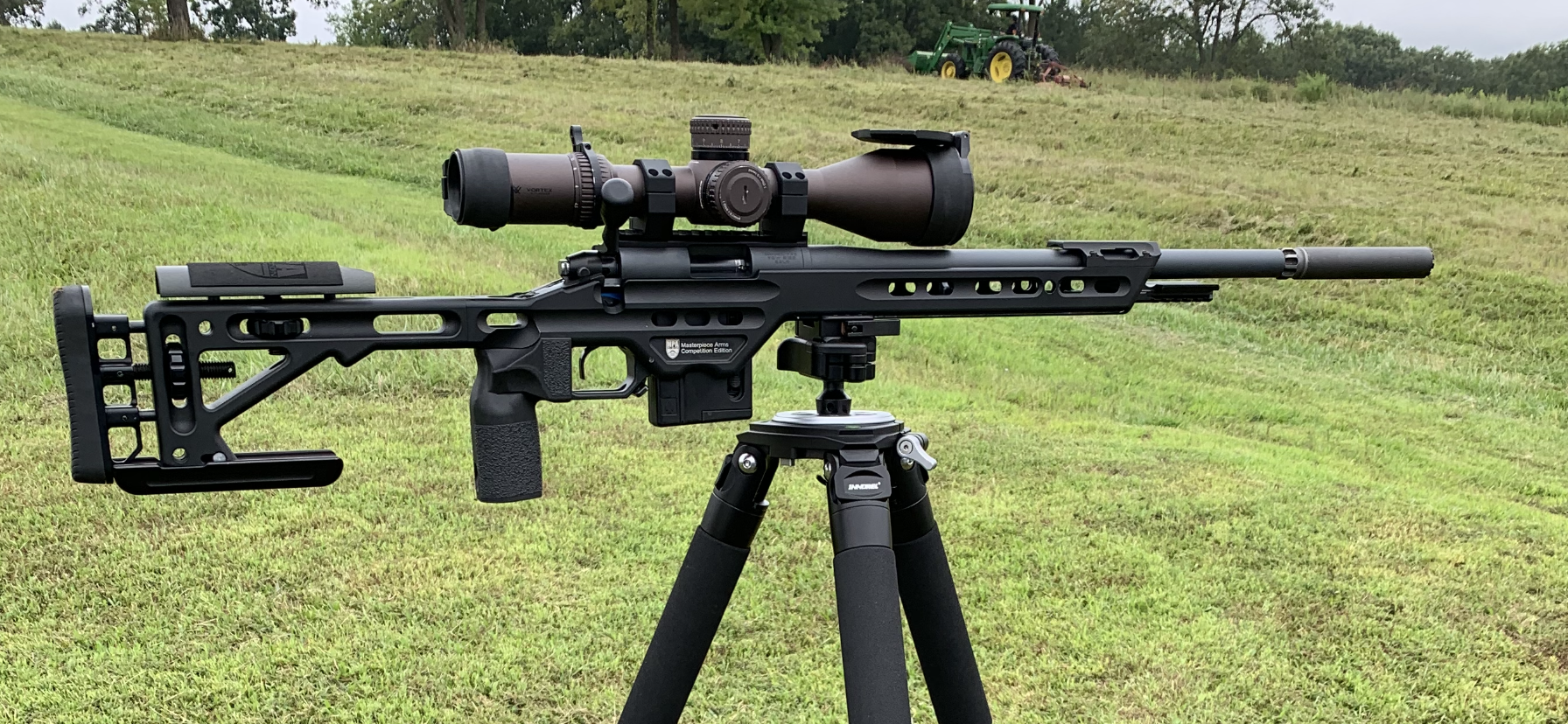

Vortex Gen 2 3-18 with EBR2C.

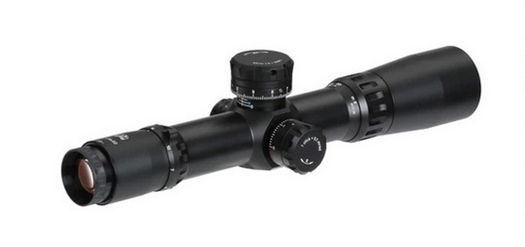

Thats one of the reasons I went with IOR's Recon.
Focuses sharply at 21 feet.
36 mrad of elevation, or 129.5 MOA.
I have been behind a few nightforces and didn't care for them. They were like looking down a tunnel compared to the Recon. I don't like the eyepiece turning with the magnifaction either.
The Recon filled all the voids , gave me a 40mm main tube, plus I got a sweet deal I couldn't pass up.
My scope has been 100% reliable with 0 problems. And I use it. A lot.
As stated previously I swapped my pst 2c out for a pst with 7c. Must say it is much better for groups. Two major things I noticed: the floating dot is awesome for finding center and also excellent for parallax tuning.
The floating dot does well for centering , but does nothing for parallax tuning.
You can , however, tune the reticule in on the ocular side.
The ocular on the IOR recon most definetly allows for some focus tuning, but I've not seen any other scope that does that.
I can actually focus my scope to tack sharpness on an object as close as 10 feet away. But again, I've never seen any other scope that does this.
