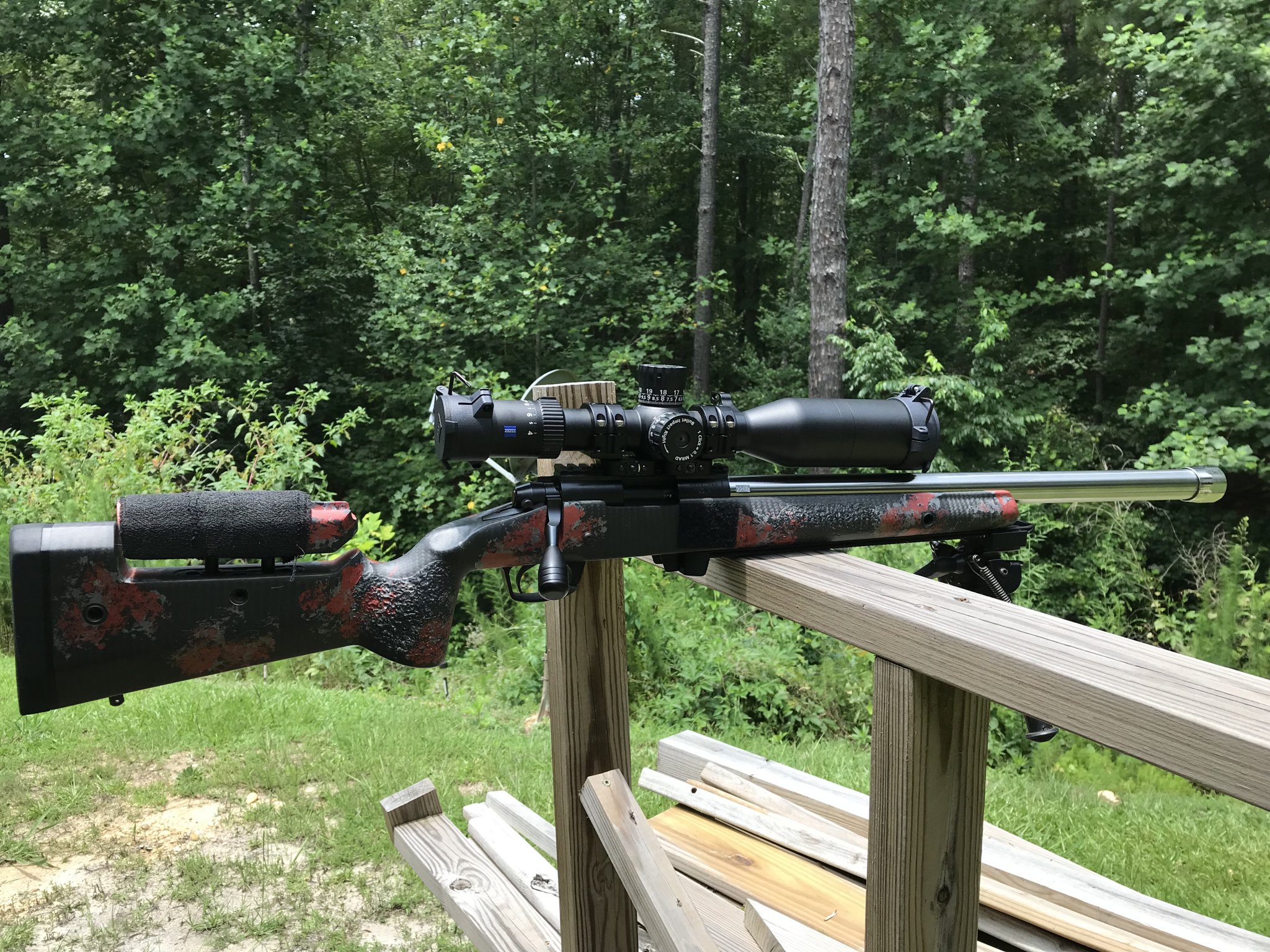

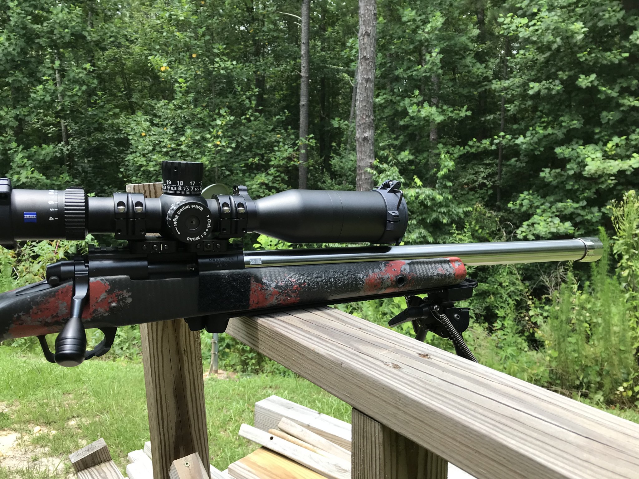

Sent my original Vudoo Gen 1 in for a new barrel. Had a 18" Kukri on it. Saw Vudoo was offering 1.2" straight Bartlein barrels and figured I would give it a try. They were offering the EC V2 tuners also so said what the hell and got one too! The barreled action came back today. I really like it.

Thanks guys. Wasn’t even 3 months. I think they received it in the beginning of May and I told them I wasn’t in a rush. Even if was three it wouldn’t be bad.
Don’t laugh at my place saver bipod. Lol I still use the Harris from time to time but have a Ckyepod PRS that goes to matches now.
Will definitely let you guys know how it shoots. The barrel is 23” long. I liked the 22” MTU Bartlein on my other so figured I would go 23” so if I didn’t like the tuner I could chop off the threads but having talked to a guy with a 1.25” and the same tuner this past weekend at a match and he says it works so will try it out.
No idea on the number of rounds down my old barrel. Never kept track. Lol I had them send it back so I have it if I needed a light rifle and can swap them out.

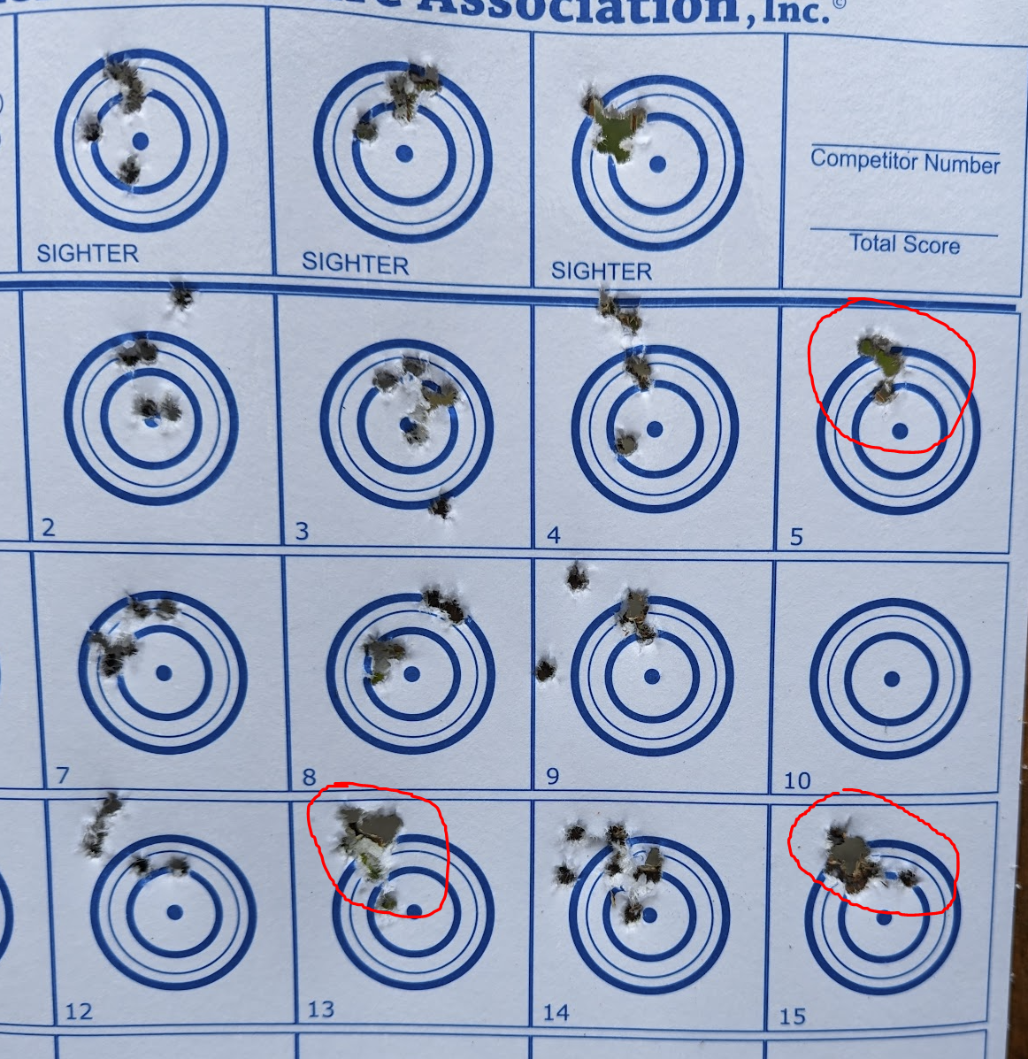

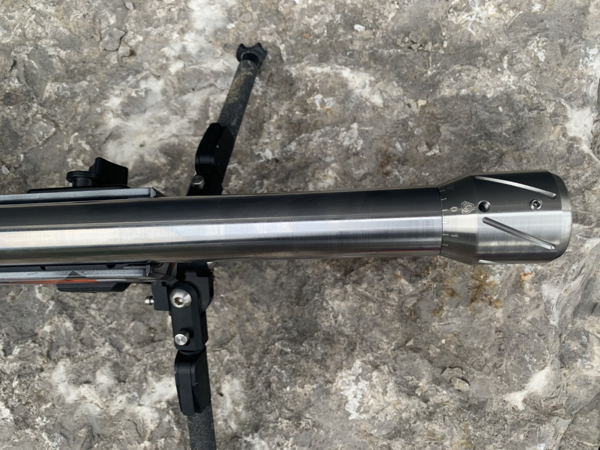

Mine also got finished - 26" Bartlein 1.2.
I haven't had much time behind it yet. Mucked with the tuner a little bit and it seemed to change the groups, and when I went back to the best node setting multiple times it was repeatable. Circled groups are the same node. Tested quickly at 100 yds. I need to go out and take a bit more time.
Thanks and that looks pretty nice too and shoots great too. Glad to hear another report of the tuner working. I plan to do my tuning at 100 also.

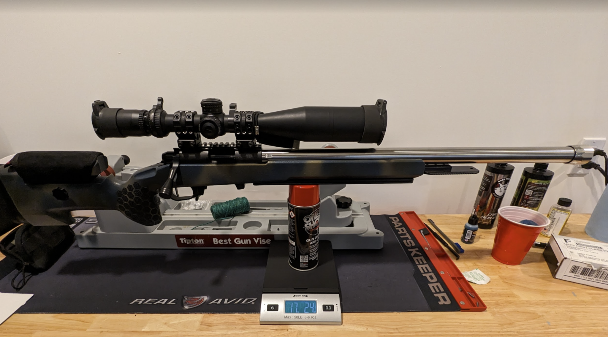

I'm pretty sure mine is over 21 lbs......I need to check now.
Came in at 21 lbs 11ozs. Truck axle for sure for a rimfire.
Rob, where does your rifle come in at weight wise?

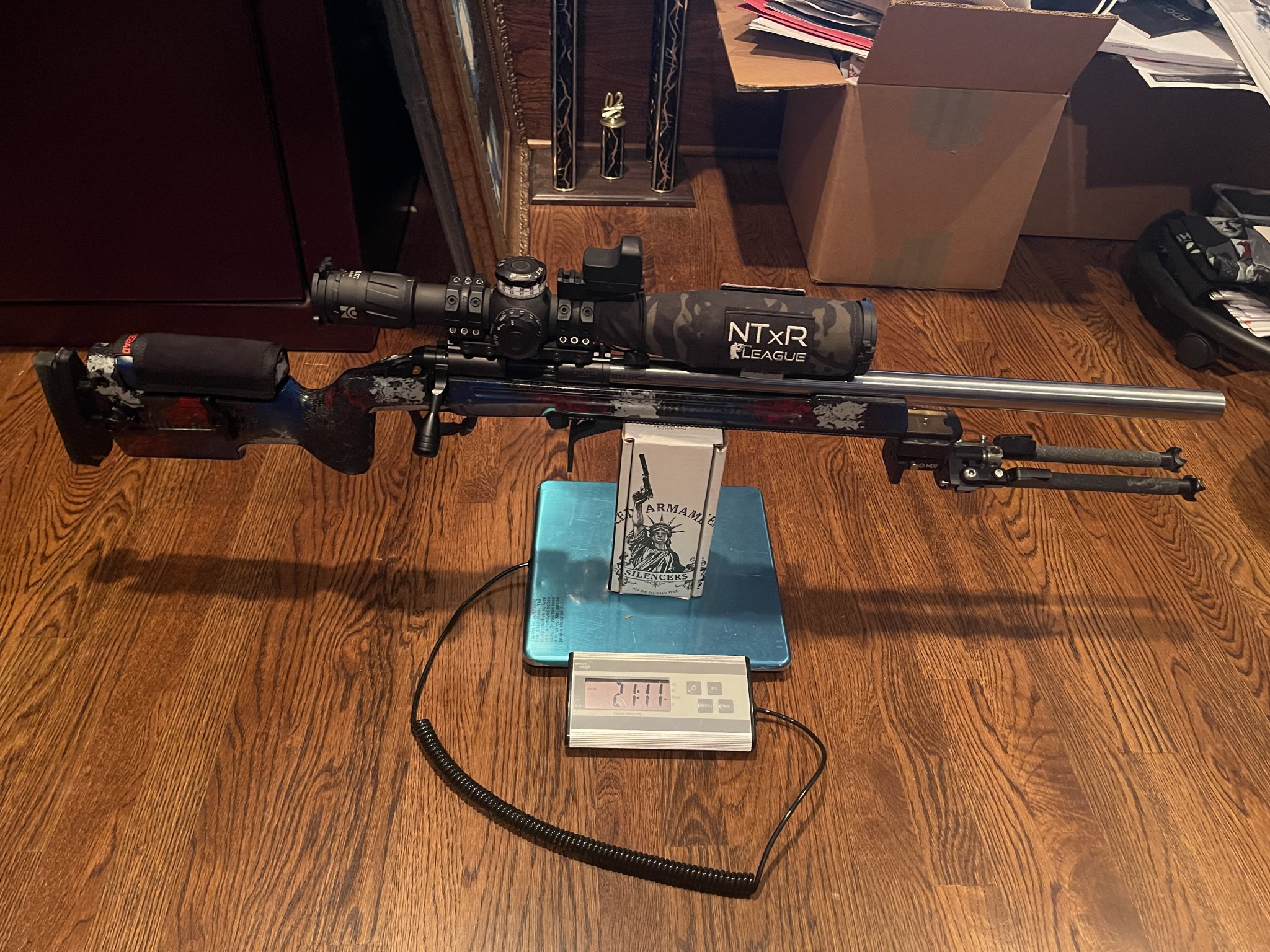

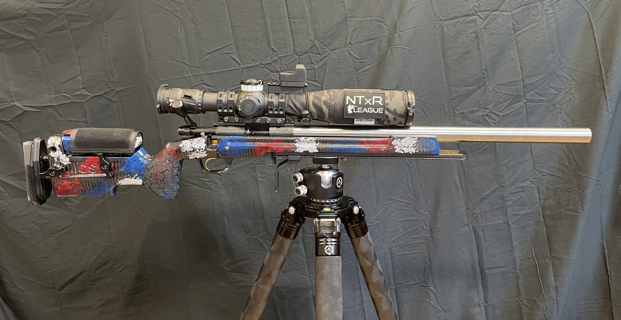

Well got it weighed and as pictured above it was 16.5 pounds. I then had a little change of heart, and stocks, and dropped it into my TCS and as pictured below it's 18.7 pounds.
That's bad ass!! Still a few lbs less than mine in the same stock too. I must have a heavy fill.
How do you like that scope?
Reactions: Rob01
Thanks. That's a heavy fill stock so not sure where that 2 pounds is hiding. Must be in the scope/mount area and some in the bipod as mine is the shorter PRS version. I do only have one weight in the arca too.
I've do have all the brass weights in the rail.

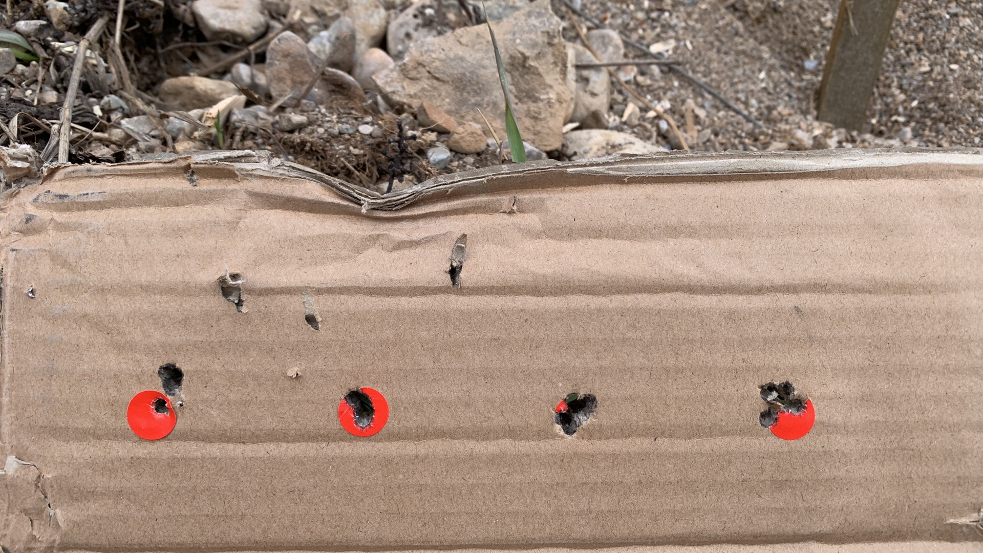

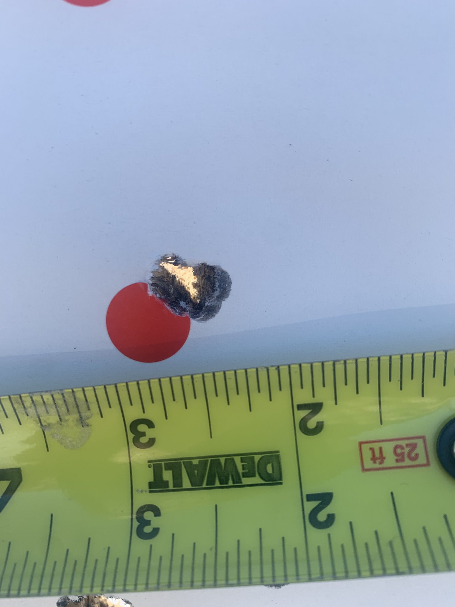

This is my second fast twist barrel to test.. 1st was a 12 twist LW and it did not perform well at any distance.
CX and SK shoots great for me as well, just requires more lot testing than R50 has...
Yeah I was watching those faster twist threads and that’s where I figured 13 would be the fastest I would try as it seems like it works for people where faster always had some issues.
Good to know on the RW50 but hoping the tuner helps with the lots I have now. Without adjusting it the SK LR is doing well in the few rounds I shot out farther so far.

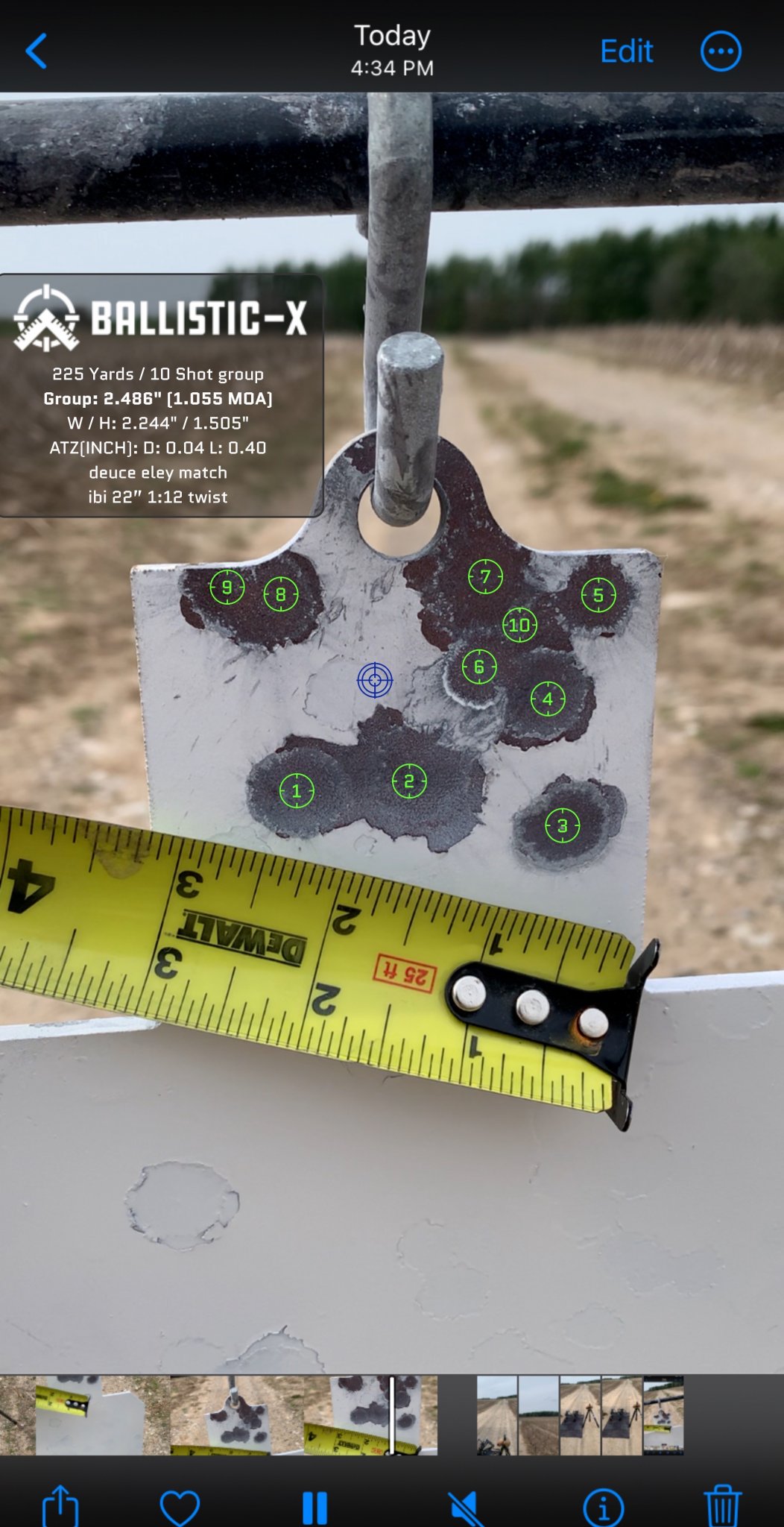

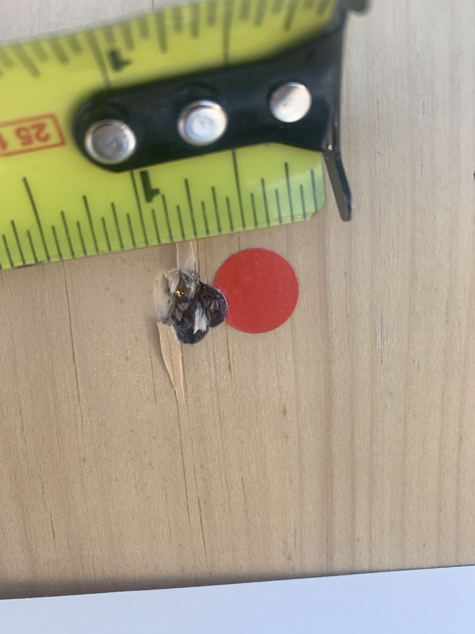

My 12 twist is a hammer. I’ve had great luck with it. Here are all 10 shot groups.

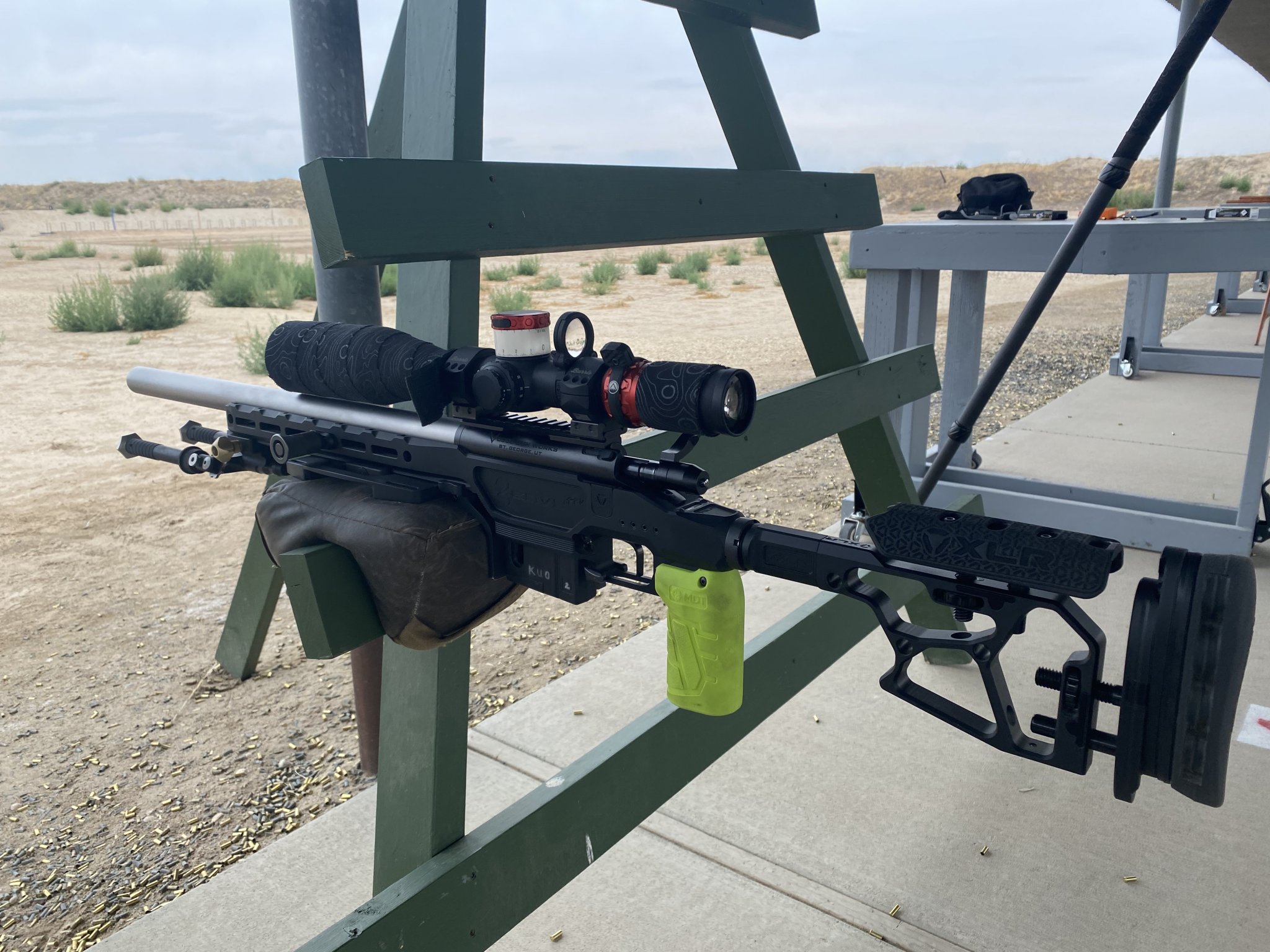

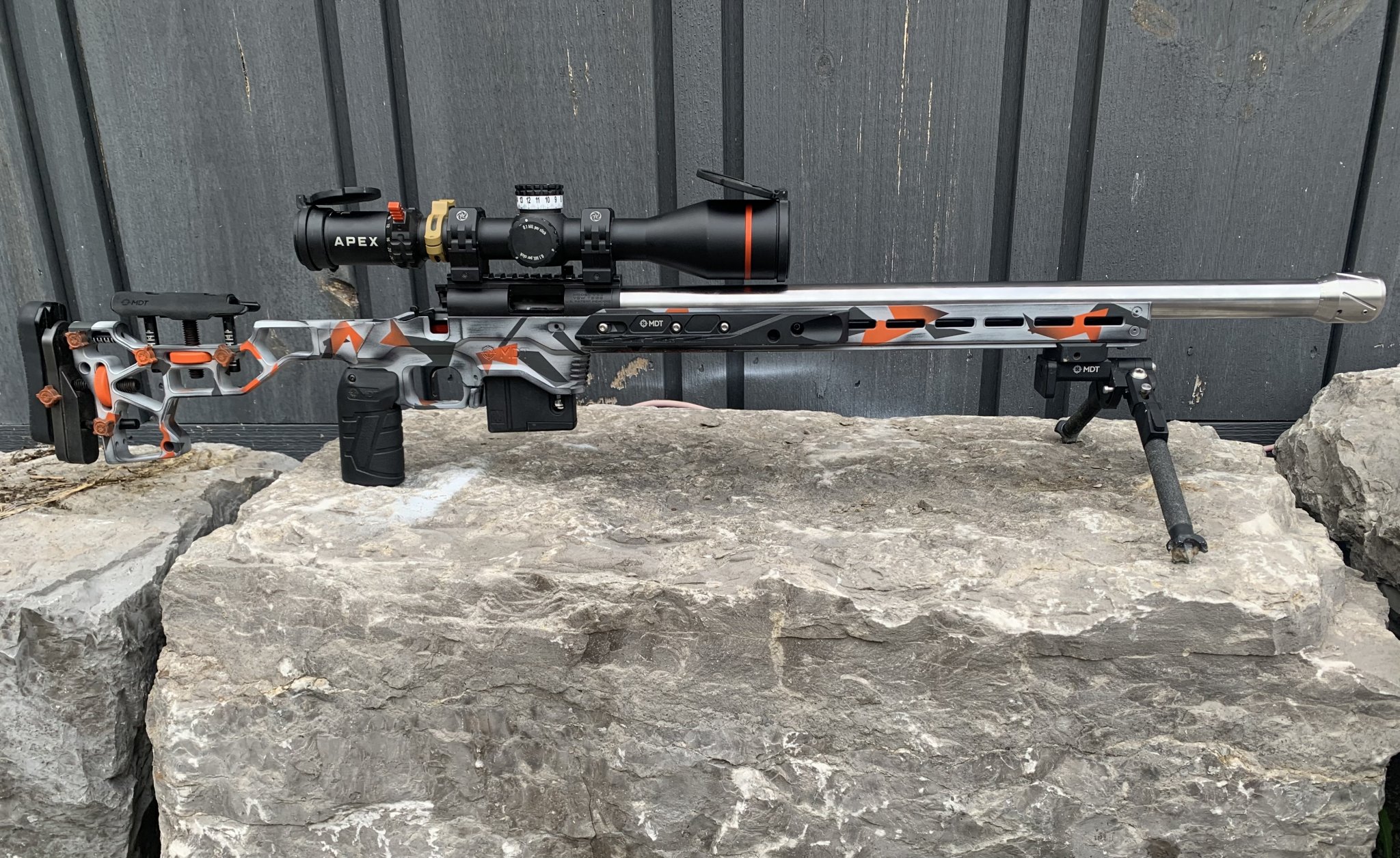

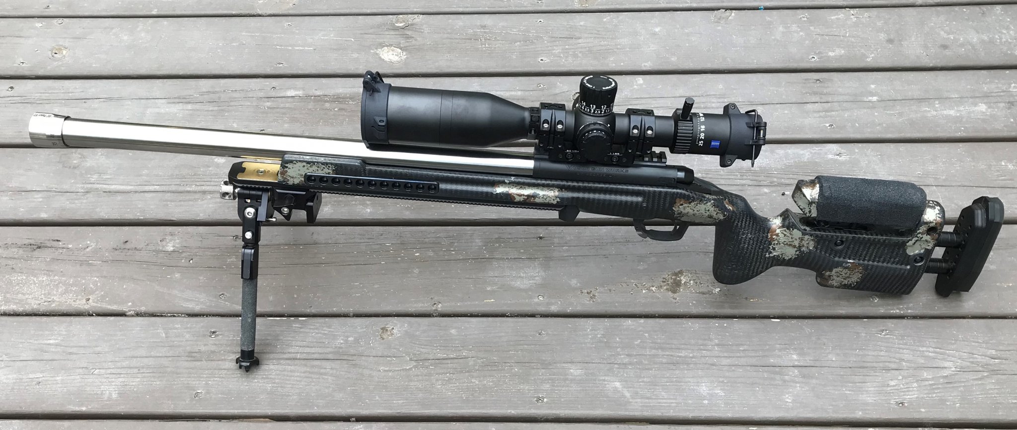

This is mine. Ordered the barreled action from VGW at the end of Jan, took delivery in March and dropped it in a XLR Envy Pro chassis. I’ve shot about half a dozen matches with it and couldn’t be happier with how this one turned out. Seems to shoot good with most lots of SK LR Match out to 200yds, but 300 is where I’ve seen some difference in vertical spread from lot to lot.
V-22, 22” 1.200” 16tw. Balances just about right without needing any chassis weights. Total weight as shown is 17 lbs and change.
I added the lime green MDT grip to help it stand out on the rack since there‘s a few other XLR chassis guns at my local matches…LOL.
