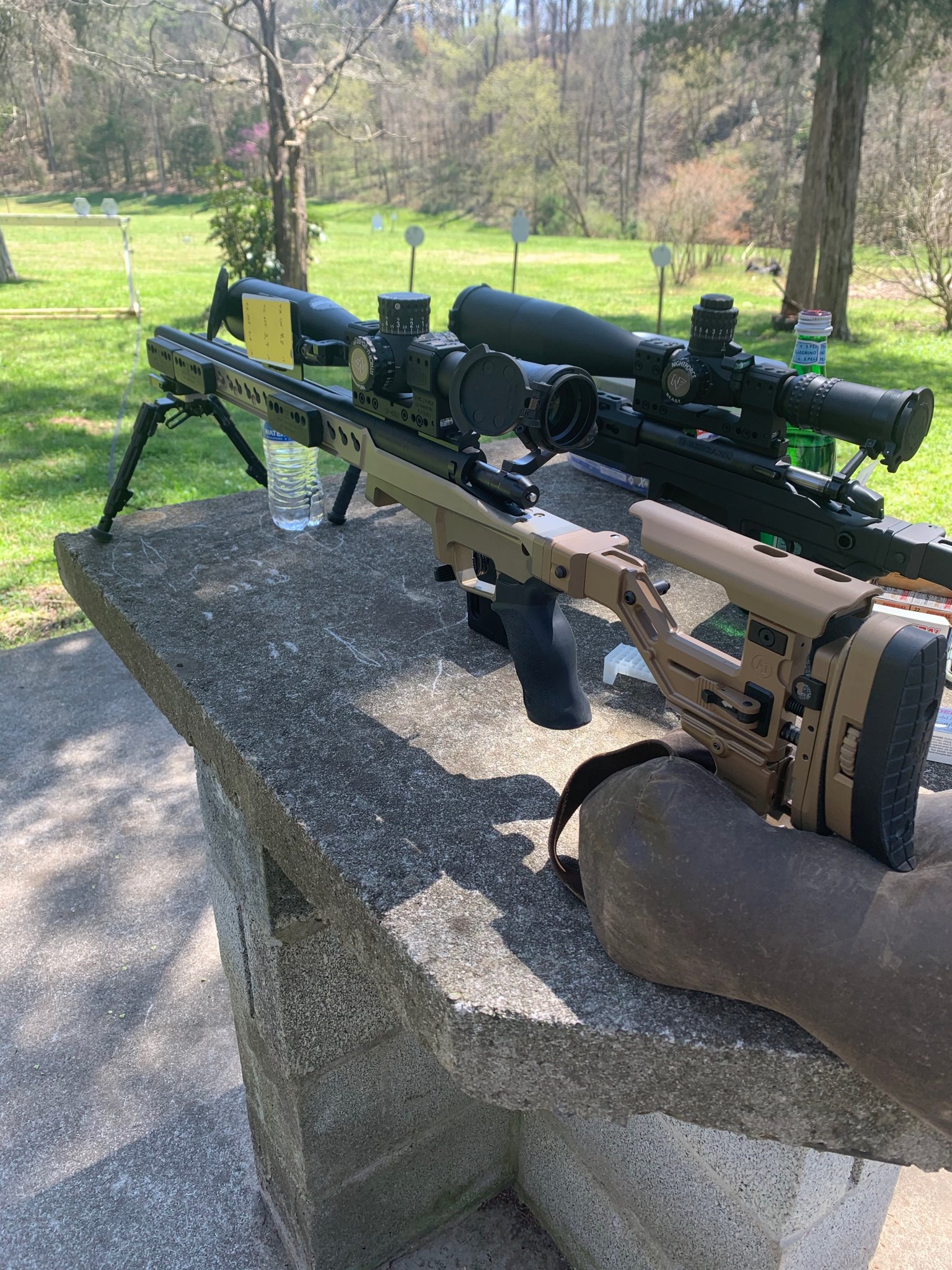

ATX-AICS just have to get in line with the rest of us:) My brother Scott visited Easter weekend with the prototype in the pic. The Bergera in the Black AXSR SA chassis ran great also.
Accuracy International developed the AICS and magazines, and maintain a very high level of quality control.
The rest have reverse engineered whatever they have, and have various issues.
