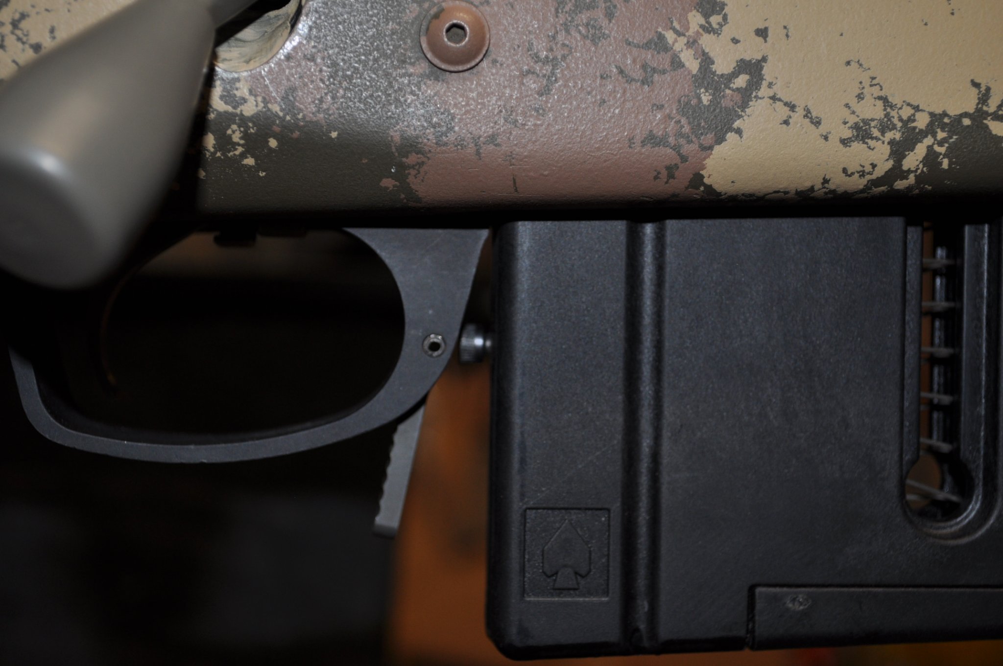

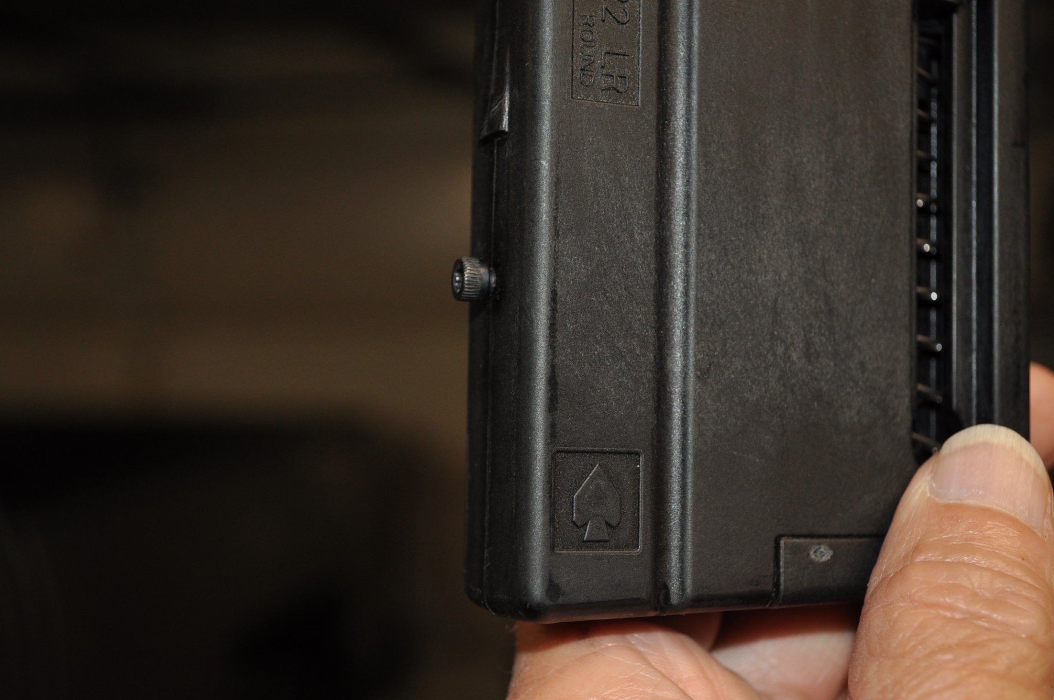

    Here ya go - this is a shot of a modified mag in the DBM Mini chassis in a Manners T4A stock that I've got my jelrod-converted 40XB in. As mentioned, I used T-15 torx head screws because I had a whole baggie full of the extras that come with every set of TPS TSR scope rings. Basically any allen-head or torx head cap screw would work - they only need to be about 3/8" long. I haven't done it yet, but once you get the screw adjusted to give the right fit, a dab of Super Glue would work to lock them in place.

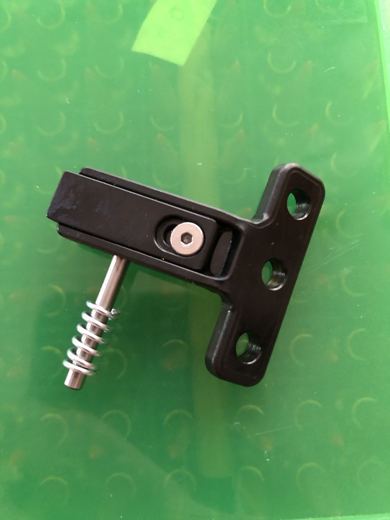

    I emailed MPA's support staff, and they're shipping me a longer magazine catch at no charge.

    I've been in contact with MPA throughout a good bit of today. For good reason, MPA is an incredibly popular chassis system because they've lead the way in a lot of areas that has served the community very well. They've creatively approached the accommodation of AICS, Magpul, Accurate Mag and MDT magazines and as you all know, these are all centerfire mags.
    When it comes to feeding a centerfire, you have a feed ramp, a huge target that is the chamber mouth and a pointed bullet, so getting the round in the chamber isn't a big deal. The mags can move around a bit more in the chassis and it won't hurt a thing. Feeding rimfire is different....no feed ramp (in the Vudoo), mostly round nose lead bullets and a small target. The Vudoo feeds straight into the chamber so as long as the mag is sitting where it should relative to the receiver centerline, there are no problems.
    Due to the generous magazine accommodations in the MPA, we've found the magnum length mag release and a magazine block offered by MPA does the trick. Rarely is a feeding issue in an MPA related to magazine issues. MPA is aware of this and is shipping parts to Vudoo and will gladly supply them to those who've dropped barreled actions into their own MPA chassis.

    Even with the issues I've had, I wouldn't pick another chassis. The extended mag catch is supposed to fix the issue (I'll report back when it arrives and I install and try it). But if I was looking at buying the parts for a build right now, I'd tell MPA I want to wait for the revised chassis.
    And both Vudoo and MPA have done a great job getting things straightened out.
    We are doing some tests right now with Vudoo to find the right combination of mag catch height and potentially a mag block insert that was developed for another application. - for the combination of the Vudoo action, their magazine configuration, bolt head design, etc.

    I put the new mag catch in yesterday, and it fed snap caps reliably. I took it to the range today and it fed and fired 100 rounds reliably. I think everything is good now.
    Reactions: bjay
    Did you use just the catch or the mag block insert too?
    The guy I talked to at MPA said the only part necessary is the mag catch, so that's all the sent me.

    Downhill, the issue is not with the tolerances of our magwell. I can assure you. On AICS type magazines, there is a large variation in length and width dimension between AI, Accurate, ARC, MDT, Vudoo and Magpul mags. Our magwell has to be able to accept all of them. There is as much as .020" of variation in length alone between these AICS pattern magazines. On a 22LR rifle, the position of the round, as its picked up by the bolt in the magazine, is critical to feeding consistency. So when we started hearing about this issue with the Vudoo mags in our magwell, we created a solution. This includes a mag block and adjustable mag catch. We have provided Vudoo with a series of the mag blocks and all of our chassis now come with an adjustable mag catch (height adjustment). Just wanted to provide a little clarification.

    I just didn't want to post anything in an online forum about the adjustable catch because I got mine before it was a standard piece of the MPA chassis. I didn't want people calling you - or @RAVAGE88 - and demanding one when the issue might have been something else. Now that you've made the catch a standard part, I'll happily pass this info on when indicated.

    I tig welded a bead across the top of the mag catch and then milled up for a total of .015" extra height. That helped a ton, but still have the occasional FTF. I'm positive it's in fore/aft play, as it only occurs when the mag is smashed into a bag. I guess I'll throw a mag block on my next MPA order.

    for those of us who for whatever reason (ie, a distributor had existing stock) got a new chassis in the last three months that did not have the adjustable mag catch included, what options do we have other than spending $36 on one from the MPA website? Yes, my gun has the wiggly mag symptoms and occasional ftf.
