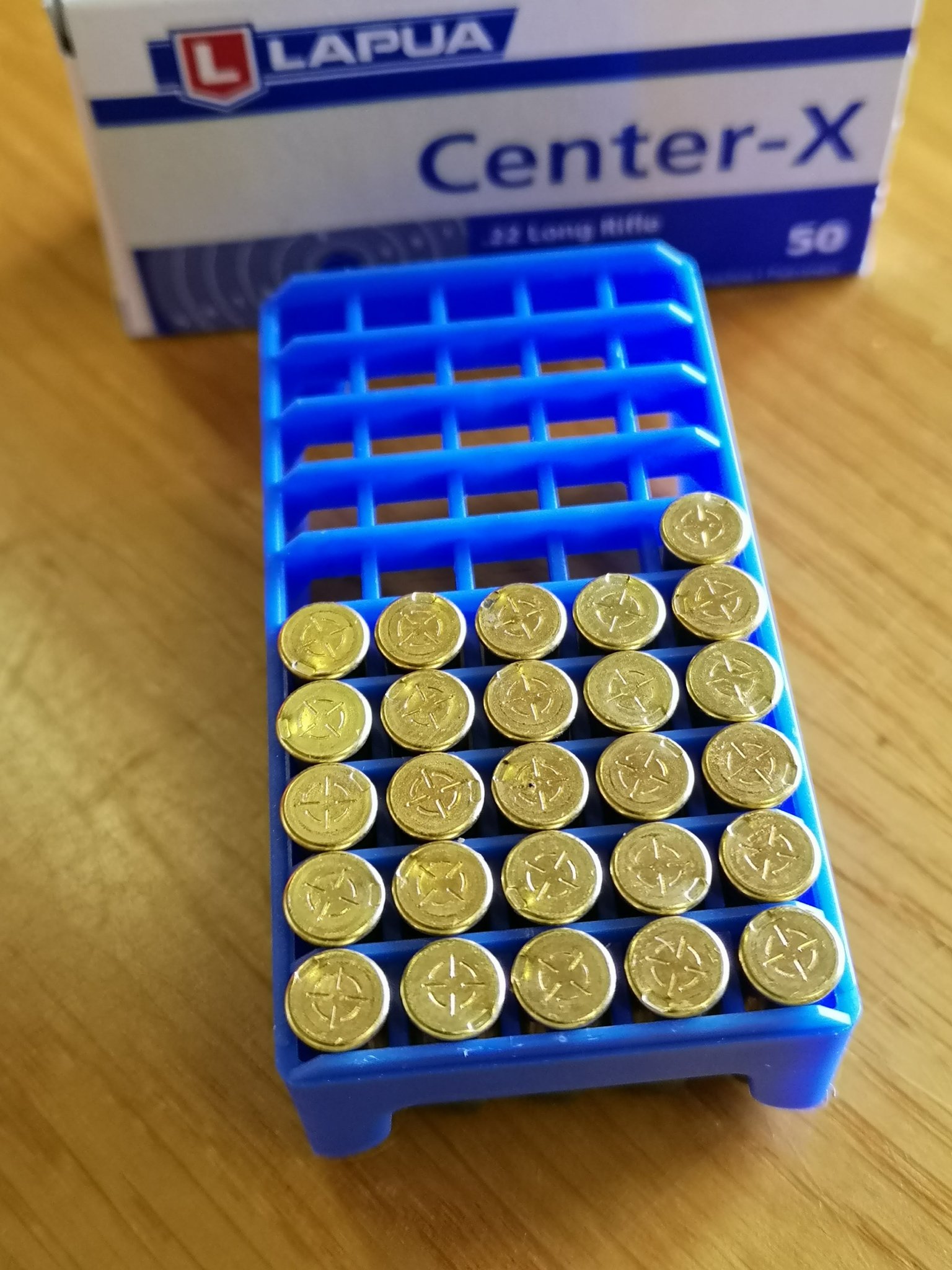

Finally managed to get a Vudoo across to Denmark, and what a beauty!
I have tried RWS, SK and Lapua Center-X through it and found that Center-X works extremely well. Below is a 10 shot group at 50m with the Center-X!
Unfortunately since day one, I have had occasional misfires due to light primer strikes.
The RWS had a few in between, SK was pretty bad and Center-X almost as bad as SK.
Every time a misfire have happened, I have not been able to successfully re-cock and get ignition.
Usually if I eject and re-chamber, I'm able to send the misfire down range at second or third try.
During my most recent range session, out of the first 200 rounds, i had 26 that failed to fire at first chambering.
All of those were Lapua Center-X, see picture below.
Have tried disassembling the bolt, clean and lightly lube all the moving parts, but doesn't seem to help any.
Action is a V-22 Gen 2, it currently has 1100 rounds through it.
Any suggestions on how to fix the issue? Could it be a light firing pin spring?

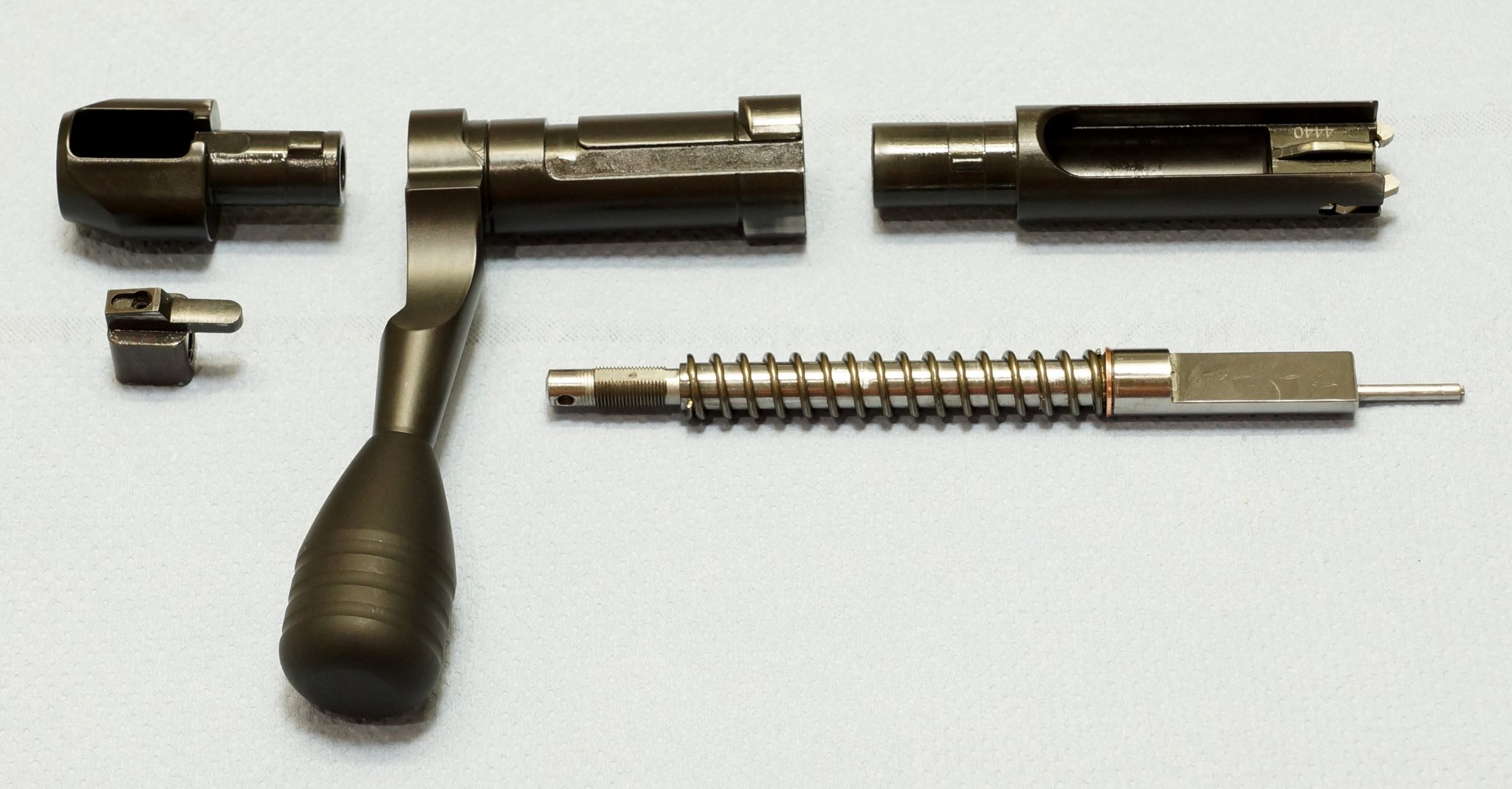

Nice shooting.... My V22 was lot tested and liked Center X even over Midas plus. anyway....
Your spring may have broken near to one of it's ends reducing it's pre-load but you have had yours apart. You have probably done tis but
I would take the bolt apart and inspect for any small burr.
Without any springs, I would push the firing pin through the hole from both directions
making certain that everything moves freely without any hang up. I would also measure its' over all length. Honestly I have looked at so many FPs that I have forgotten the details of the Vudoo but basically it's a rod in a hole. Or a flat plate in a groove..... If it moves freely there is not much to go wrong. I would get a hold of Jill at Vudoo and explain that your in Denmark and she will help you until it is resolved. Your gun has a lifetime satisfaction guarantee and if your not happy they will go so far as to buy back your entire gun purchase. I suspect that if you asked Jill for a new FP and spring she would have one in the mail tomorrow. Vudoo has a great reputation and it's not worth jeopardizing over $5.00 in parts.
btw... Personally I also bought some spare extractor fingers and springs because they are about $1.50 each.
They may never break but they are stupid small and easy to loose while cleaning the bolt.

Nice rig. Looks to me like the pin strike is a bit far out. With those crescent firing pins, I think it is a little more sensitive to that. I would expect Vudoo could let you know what they think pretty quickly on that.

I suspect that this issue OP is having is a poor interaction between the Timney trigger design and the Vudoo action. Remember that we are talking about triggers that were all originally designed as replacements for a stock centerfire Remington 700. As we deviate from that by using a particular trigger on 700 footprint .22rf with it's lighter spring, some trigger designs will fare better than others. This is not the trigger makers fault, the trigger works fine for it's intended use, it just might not stretch to ours, or, it may take another modification to make it do so.
In the case of the Timney and the Vudoo, it seems many have problems due to the Timney design soaking up more energy from the firing pin than some other triggers. Being a rimfire, the Vudoo has less spare energy. It is my understanding that this is even more the case with the, also rimfire, RimX action. I suspect you could successfully address the problem in a variety of ways.
1) You could add a stiffer firing pin spring such as the one Vudoo sells for those intending to use the harder cased Eley or CCI rounds to simply provide more firing pin energy. Given that it appears you are close to enough energy as most rounds go off, I expect a simple spring swap would solve your issue. Provided you otherwise like the trigger, I would give Vudoo a call to obtain the stiffer spring and ask them about this solution to see what they think.
2) You could switch to a trigger with less firing pin drag such as the Bix n' Andy which I believe is the lowest in this regard or the TriggerTech which seems to work fine. I have not experienced light strikes with either of these triggers in my gen 2 Vudoo even when using the light Lapua spring on harder Eley and CCI cases. Similarly, nobody else seems to have light strikes with these triggers. This is a more involved solution but after selling off the Timney your still probably not out much.
3) You might try the switch to the smaller headed firing pin that Gjmenn22 mentioned. This will concentrate the energy you have in a smaller area. Most .22lr designs have small chisel or pointy firing pin ends for this reason. I expect generally this would lead to higher ignition reliability but also make you more susceptible hitting a gap in the primer powder on cheaper ammo from time to time and having an FtF from that.
4) I would not recommend Jefe's suggestion about the firing pin unscrewing as I don't believe that would have any effect. The firing pin protrusion for a Vudoo action does not change with the firing pin being screwed or unscrewed from the cocking piece. This can be seen in a labled diagram I put in my V-22 review. The firing pin stops on a big shoulder near the front of the firing pin and protrusion is not easily or simply adjustable. It would require grinding metal to do so. I would not recommend this for a variety of reasons. Of course, if you get some gunk in your bolt where that shoulder comes to stop, you will get insufficient firing pin protrusion so do check that area for build up of gunk.

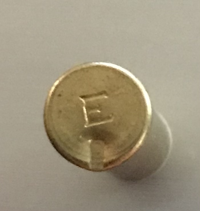

I'm a little confused here with the photo of Nygaard's rifle and the impression on the Lapua cases - I've never seen a Vudoo repeater come from the factory with the crescent-shaped striker, only with the chisel style. But his rifle appears to be a repeater, with a magazine, while the FP indentation in the cases in the photo definitely being that of a crescent striker???

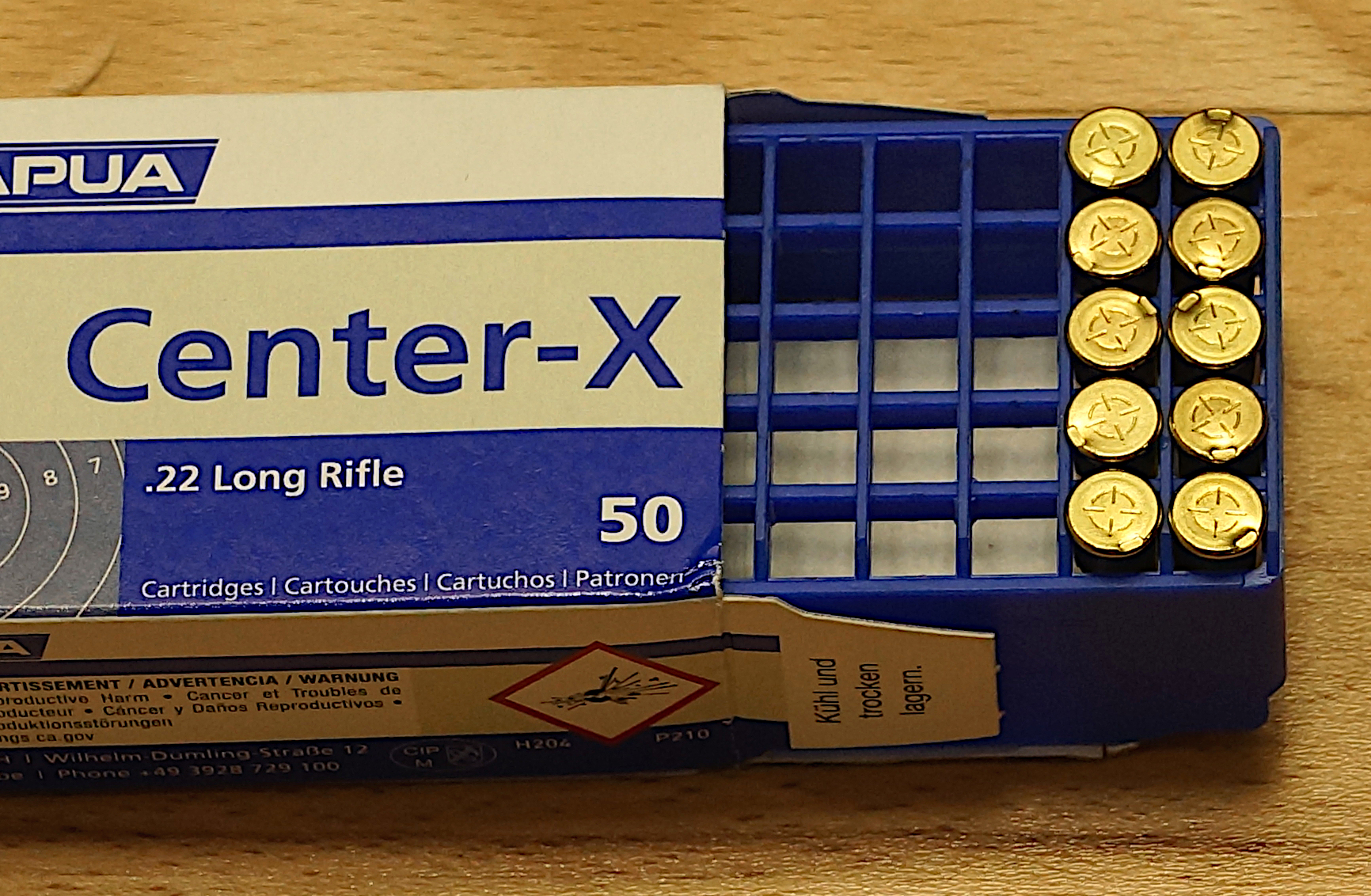

Last time at the range, the Vudoo was extremely picky with the Lapua's.
Approx. 50% of the 200 rounds i fired that day, failed to fire at first chambering.
Have since done some tinkering with the firing pin.
First I made a small copper shim to go in front of the firing pin spring and tested. Went from 50% FTF to 20%.
Then i tried backing out the firing pin one additional round from where it's supposed to be locked in place by the grub screw, and now got 0% FTF!
Below pictures shows the copper shim and cases before and after the modifications.
The 5 cases in the left row is before modifications, and the 5 in the right row is after.
There is only a slight difference in the depth of the detent in the cases, but enough to make them go boom :)
Also i have stopped using CLP for the bolt, instead using some weapon grease containing teflon now.
The mods does not seem to have affected accuracy in any way, so I will leave it as it is for now.

My Gen 2 has the crescent firing pin. I also had light primer strikes recently after bolt disassembly and reassembly. When I contacted Vudoo, they advised I try the video which shows how to time the firing pin using the pieces of paper. Haven't made it to the range to test.
I'll also update.
After watching and following the Voodoo's video, I've had no FTFs and I've shot at least 500 rounds since. Midas and Biathlon +.
I shoot Eley Match black box in my V22-s, have very few FTF's, and those usually go bang by ejecting that round and re-loading it in the normal manner. I assume it's thin/no primer in that particular spot. I adjusted/backed the FP spring out one additional turn from the factory setting, per a video on the VGW site, still using the green color coded spring IIRC, but did remove all of the green paint. Some matches I have no FTF's, but the last match I had 2, but those went bang when loaded in a different position.
Buys a $2k+ barreled action and throws a budget/shitty trigger on there. Makes sense.
As said, use a good trigger like TT or B&A and you won't have issues.
