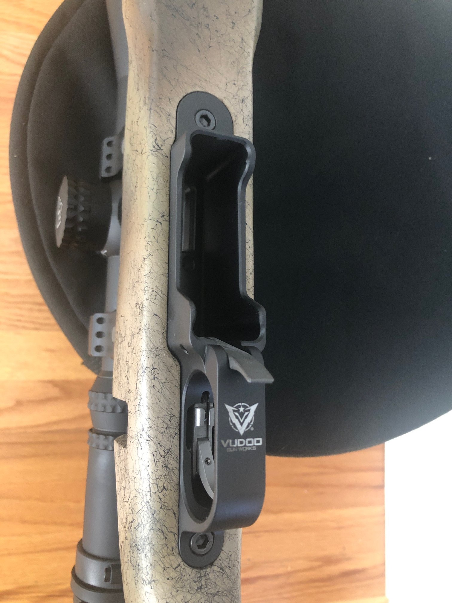

Does Grayboe do the cutting? What needs to be cut?
Grayboe does do the cutting, when you choose the features of the stock there is an option "Bottom Metal Inlet: Factory Vudoo BDM" with an up charge of $35. It the exact footprint of the V22 Bottom Metal. The V22 Bottom Metal Extended Magazine Release ($185, from Vudoo) is an additional item that does not come with the barreled action, that you may need depending on the stock or chassis you select. I hope this helps.
