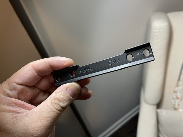

    I'm sure the negatives are more likely to been seen on the intardwebs, than positives; but it sure seems like Spuhr mounts have been having problems.
    Trust me... My jaw dropped... I have never exceeded 45in/lb, followed the torque sequence and I torque in incremental value up until 45 in/lb.
    for a 500ish mount I expected more...
