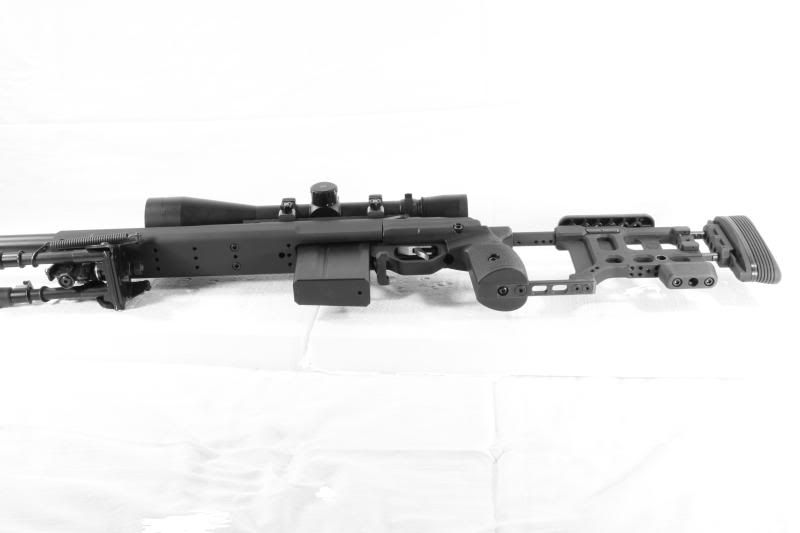

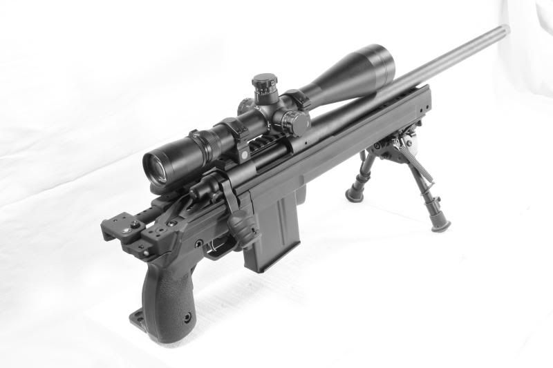

Thank you for looking! Here are some pictures:
Fixed, as it ships:
Fixed, as it ships right side:
T3 Fixed underside:

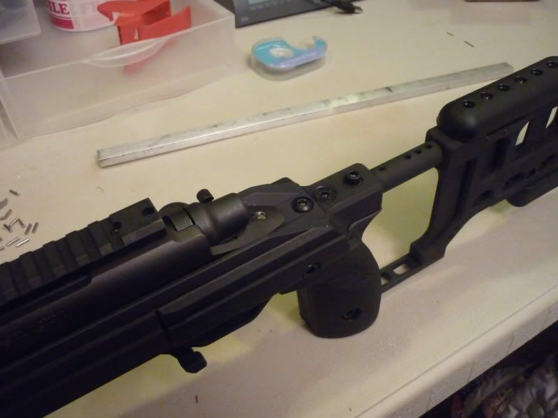

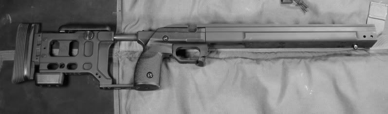

Rem 700 Folder

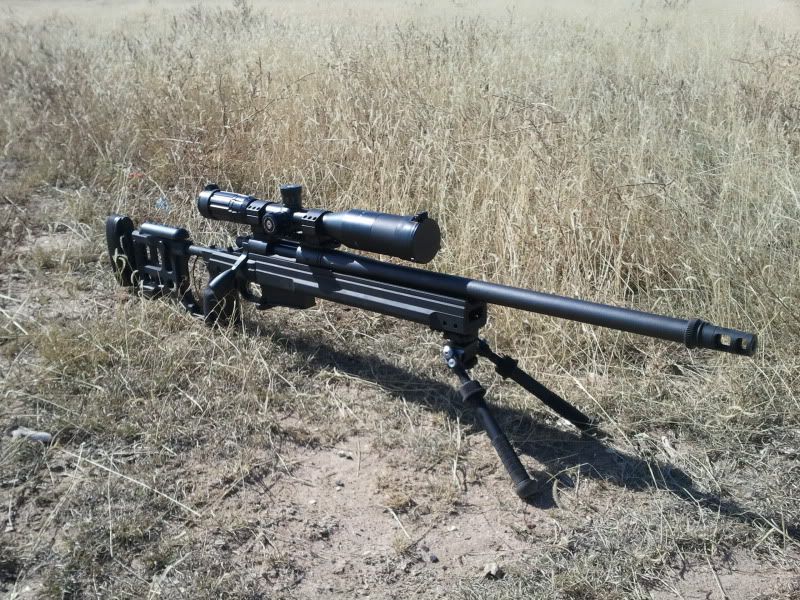

Copper, thanks for posting pics! Looks good but how does she shoot?
Justin
