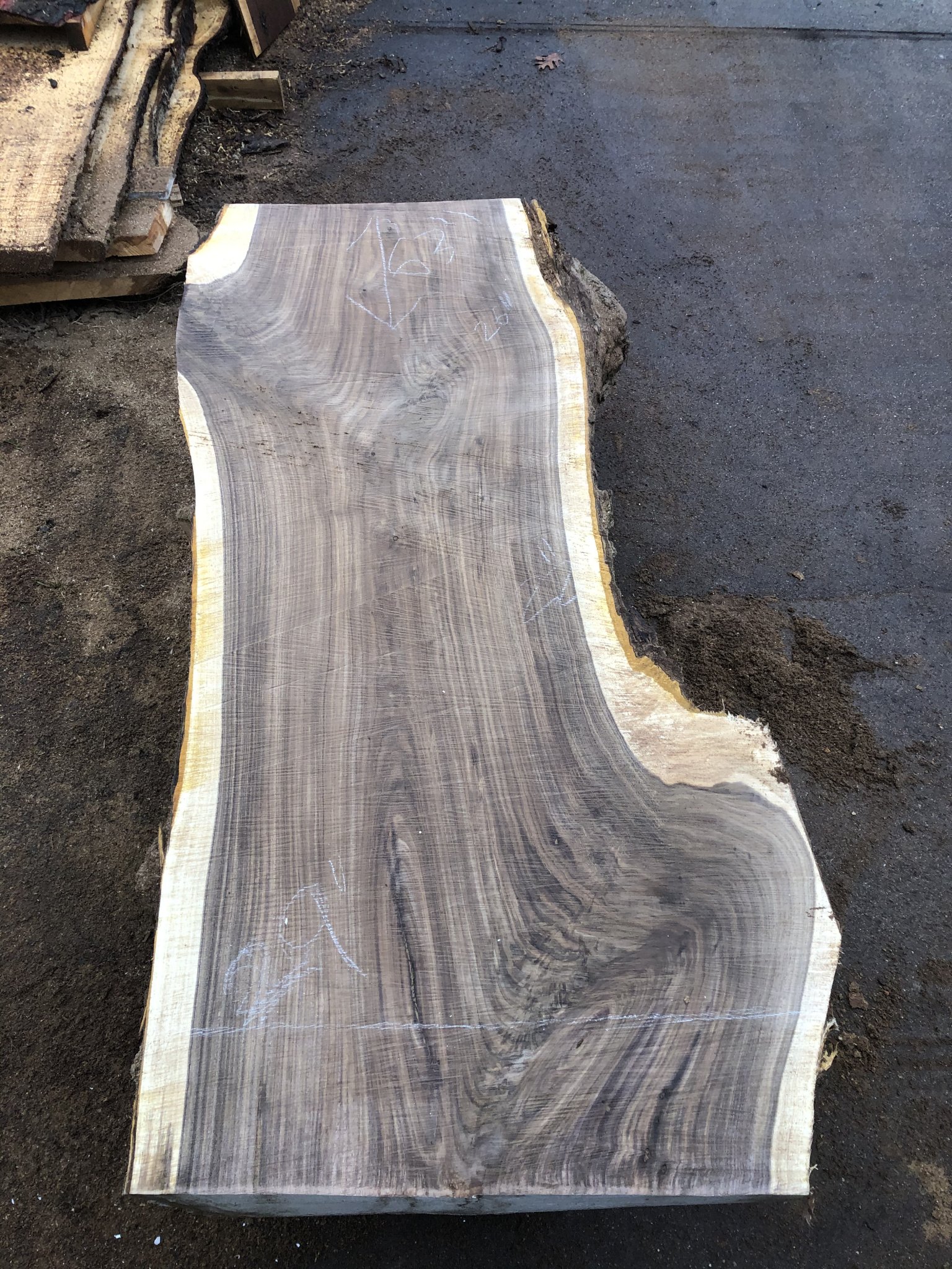

Any point trying to cut some stock blanks out of this log I’m slabbing?

It looks pretty straight grained. Would be easier to work, but not a spectacular looking stock when finished. Most interesting bit to me is the crotch wood down on the lower right. From my perspective it would come down to it's value to you as a project. The slab is probably worth as much as a nice figured blank. But if that's a piece of wood out of the back yard, or just sentimental to you as something you milled/made then it's hard to put a value on that.
I would say absolutely yes. One on the right, one on the left (buttstock up), if you have enough room. Unless you need the wood for something else. Like making yourself a piece of furniture.
That said, for yourself yes, for someone else to sell to, you might be hard pressed. But, it looks like nice walnut.
Will make a very well figured stock. Best if you have someone to advise you in cutting, sealing end grain and drying.
