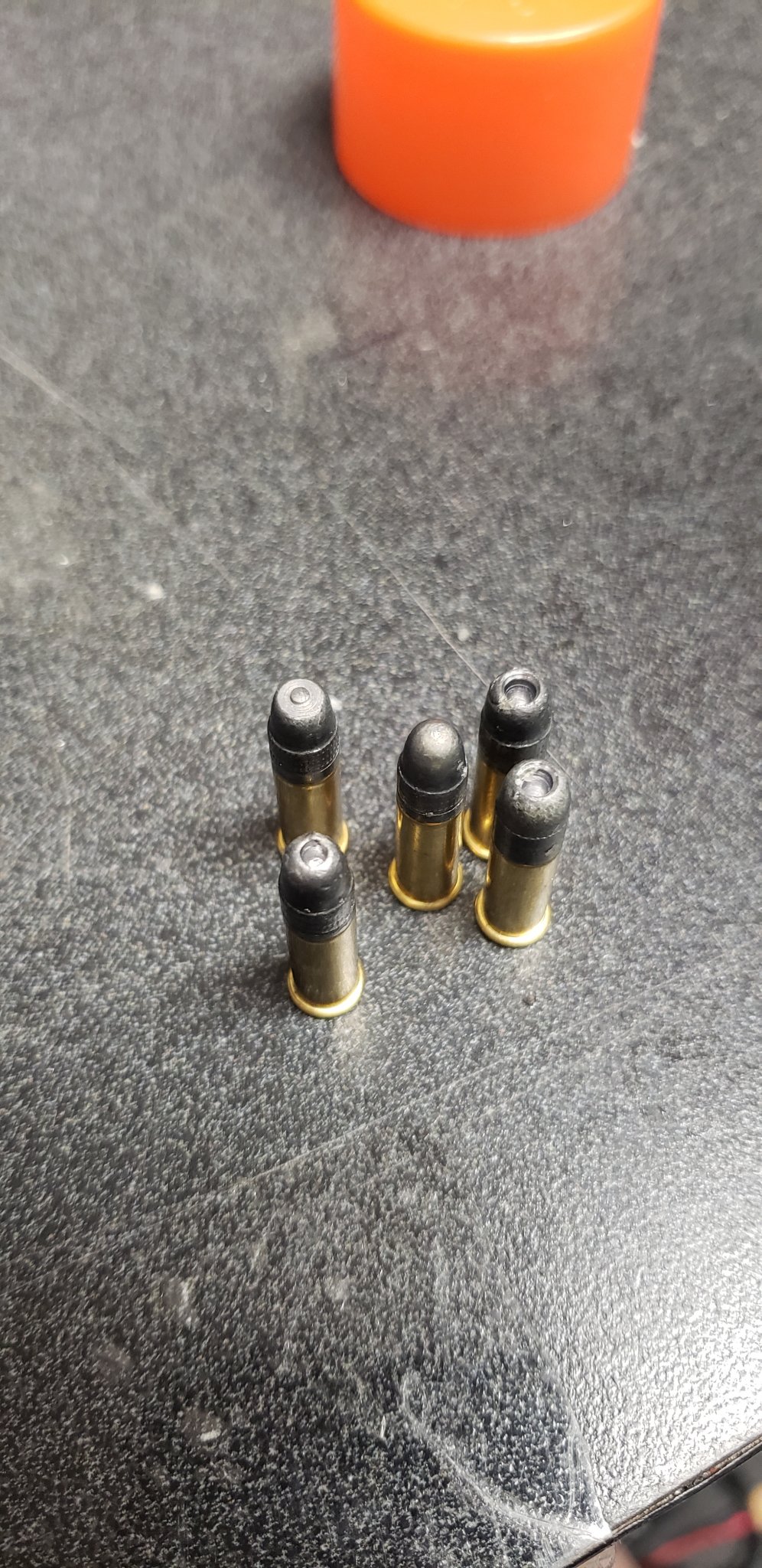

Just got my package from Mr. Waltz today... have to say the packaging and everything looks great.
Can't wait to get some rounds made to see what happens.

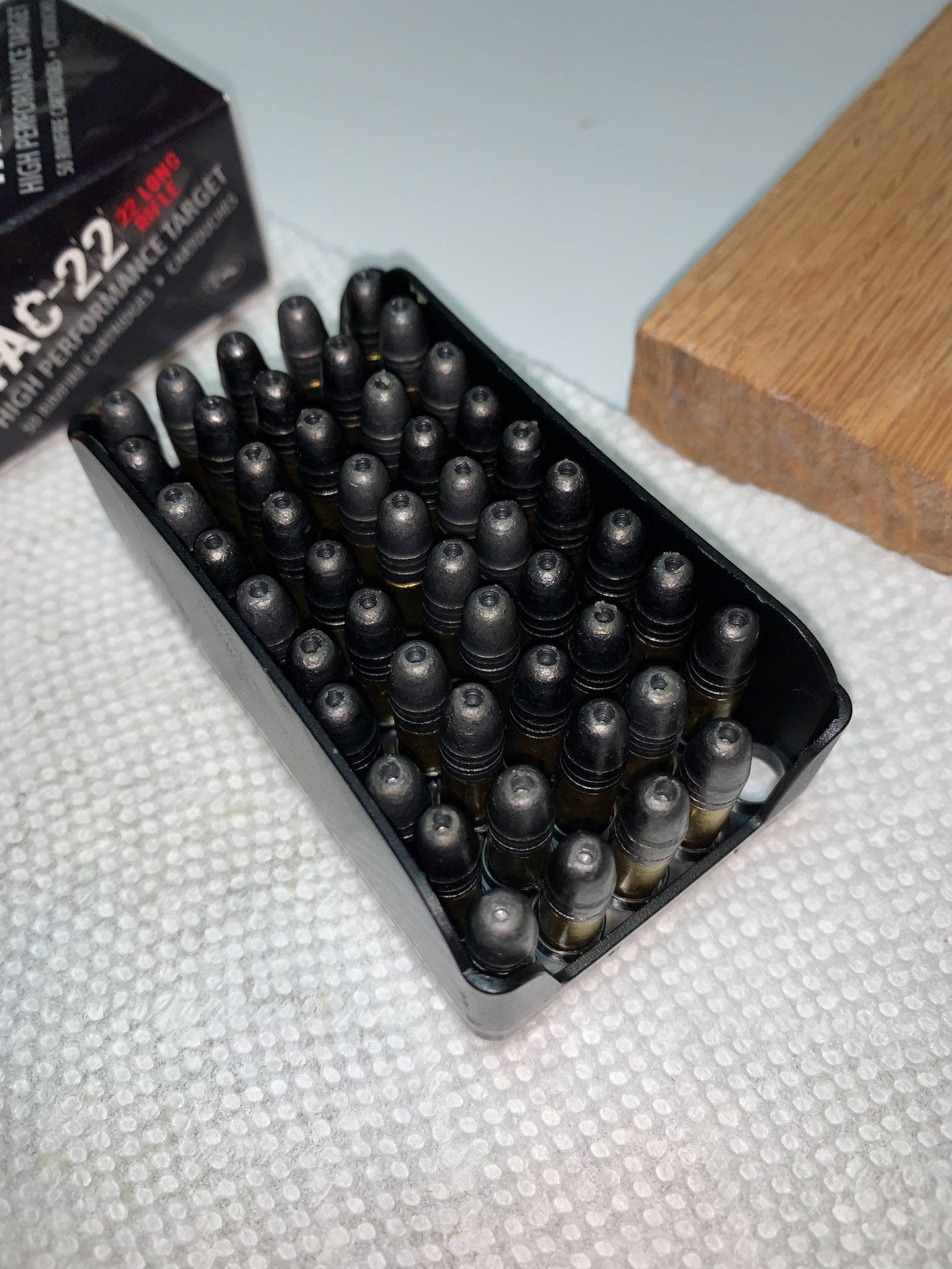

At any rate, I got my die set in the mail today and put two boxes of TAC-22 through it, one box of HP and one box of EPS. I think it turned out pretty well. Won't get to test it for a few days, hopefully it is consistent. One thing for sure, the lube starts building up using the EPS die, not a big deal just wipe them off with a paper towel.

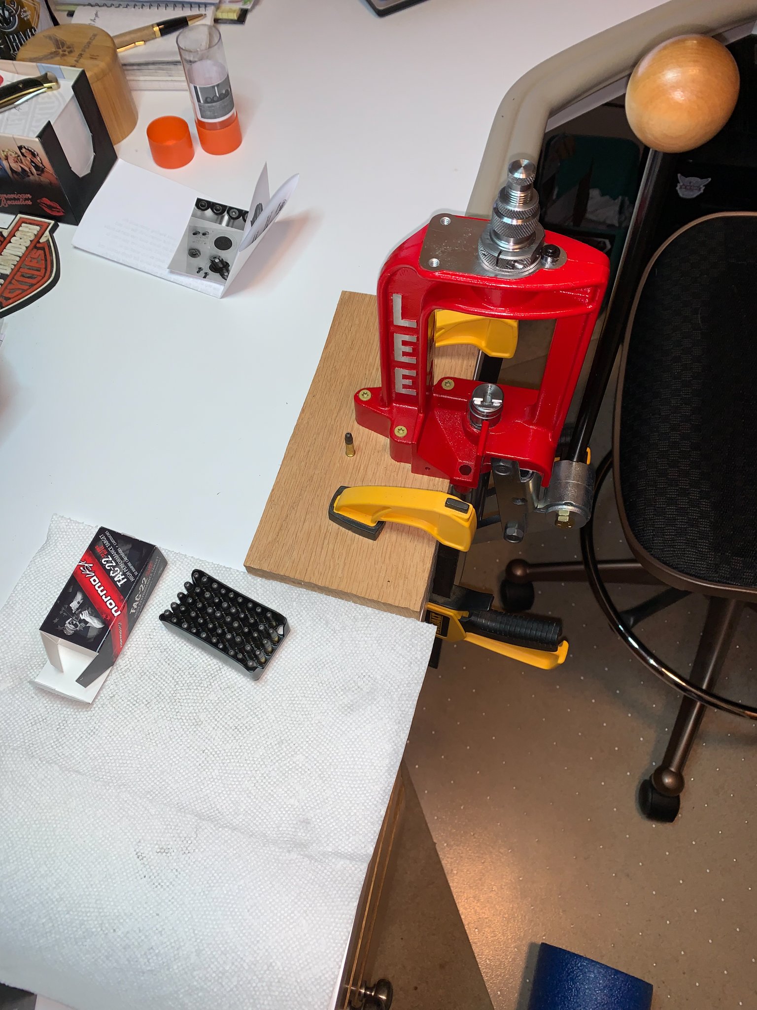

I don't use the press for any other ammo, and wanted to do this in my office, so I just used some deck screws to hold the press to a piece of oak, then clamp it down. It takes very little effort, and didn't move around at all.
Never mind the EPS rounds leaning all over the place, there was a wrinkle in the paper towel.

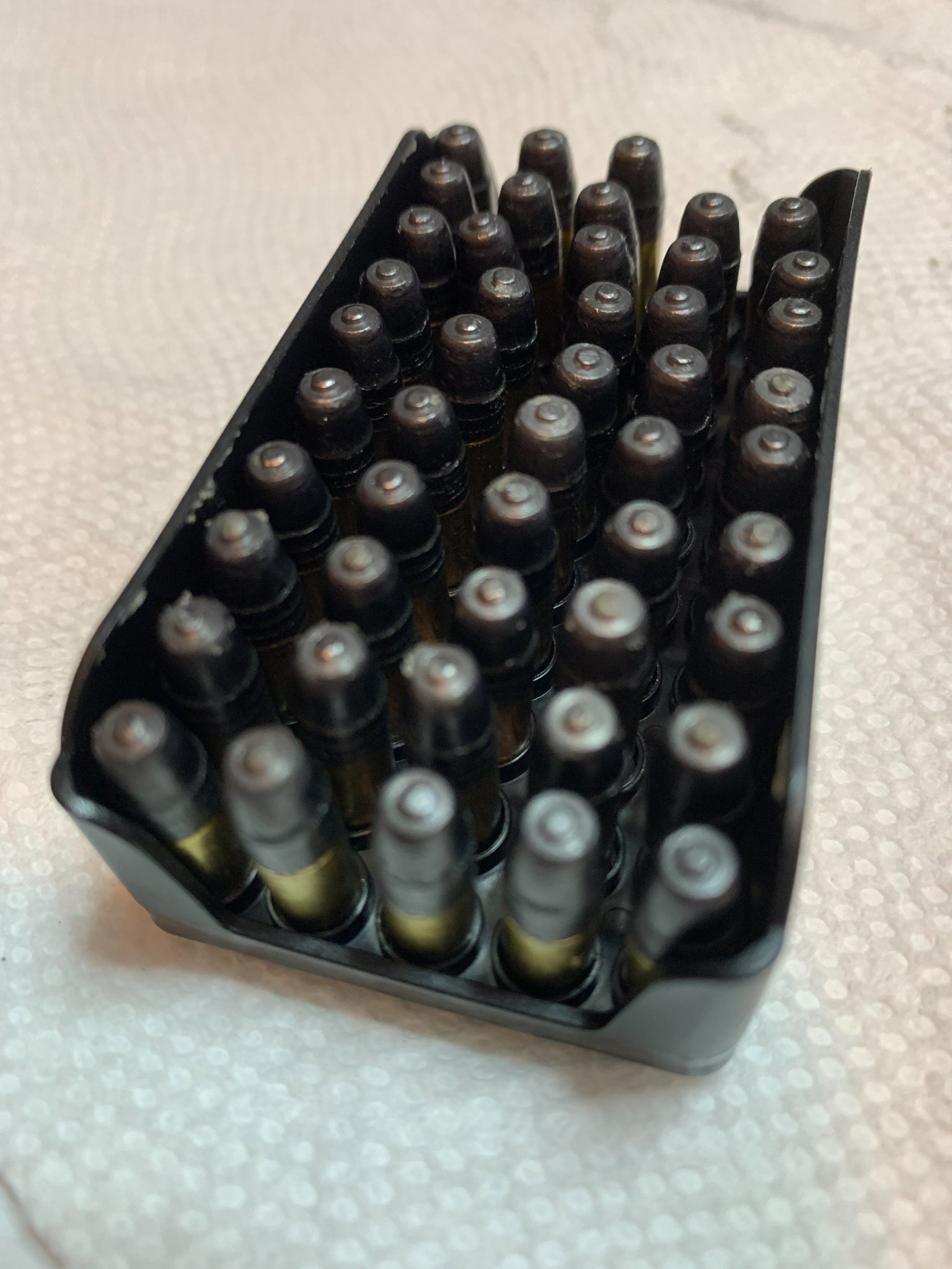

I finally tested some EPS and HPed ammo I posted earlier that I ran through the Waltz die. I had some feeding issues, mostly with my Kidd ULW, which can be expected since the EPS nose isn't really "semi auto" friendly, but also a couple feeding issues with my Bergara BMR. Granted, those aren't my best rifles, so maybe the Anschutz 64 or Vudoo would chamber it better? The HP ammo ran great in both, and consistency was very close to non modified TAC-22. I'm going to do another box of EPS and run it though the Anschutz, mostly to see if it feed reliably. Will definitely be keeping the die set around to HP hunting ammo for years to come.
