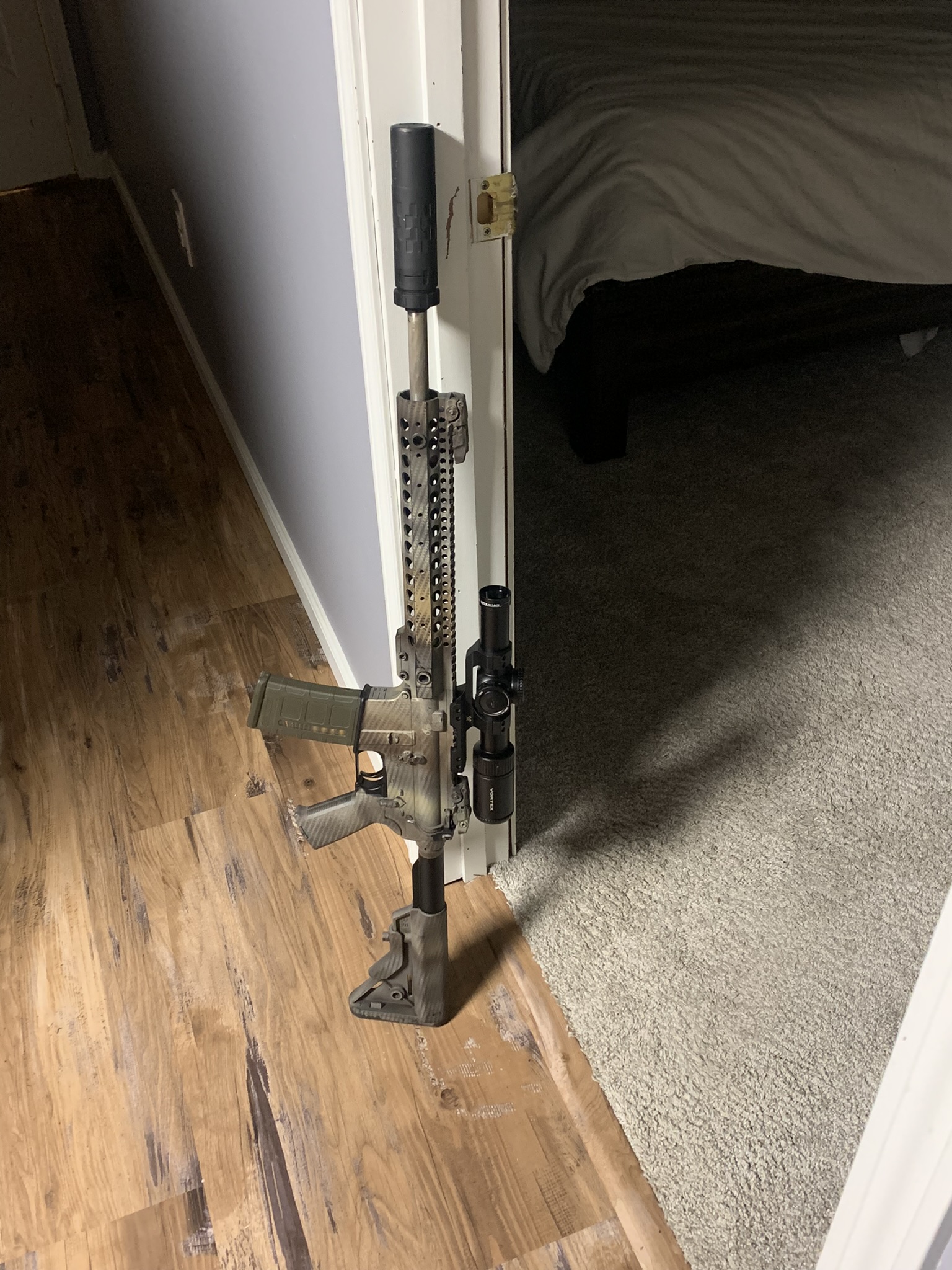

Barnes precision machine, can’t begin to try and explain how accurate this thing is, and can’t wait for my xtr iii to get here and have this go back to a mk12 style build.
