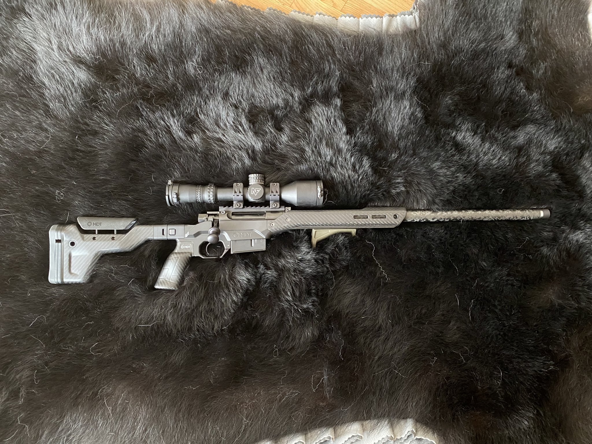

    This is exactly what I did.
    Origin, MDT ESS Chassis, 6.5 Creed barrel Heavy Hunter profile at 22", Burris XTR3 in ARC M-Brace Mount. I then bought a 6mm Creed for some PRS Matches & a 223 barrel for just plinking. I walk about 3/4 mile to by blind for Ky Deer season. Rifle packs easy and shoots damn good. Planning to build a second one for the wife and get rid of a few rifles and just buy barrels.

    So yeah…decided to stop trying to do everything and just went with a short action For this one.
    Talked to the great folks at @Defiance Machine this morning on my drive into town and have a nitrided AntiX action (with a custom serial#!) in the queue…only 10-11 months out! LOL
    Also got the barrel ordered today from Straight Jacket Armory: 22” Proof cf Sendero profile, short shanked to 21”. I only shoot suppressed and not too worried about the 150fps or so loss from a 24” barrel for my purposes. ETA late Spring/early Summer of next year.
    Have been waiting to see if the MDT HNT26 chassis pops up in stock anywhere, but with the lead times for the barrel and action being what they are, will just back order straight from MDT tonight.
    I should be able to get some ammo in hand by then too! :LOL: I’d start rolling my own tonight, but need to research (and find) the best powder and magnum primers. Not sure the stuff I have on hand for loading .308, .223, and 300BLK will do the trick.
    And so the trip down the rabbit hole begins…

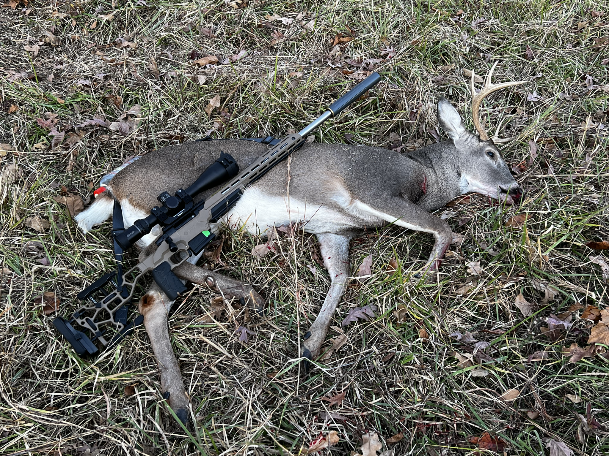

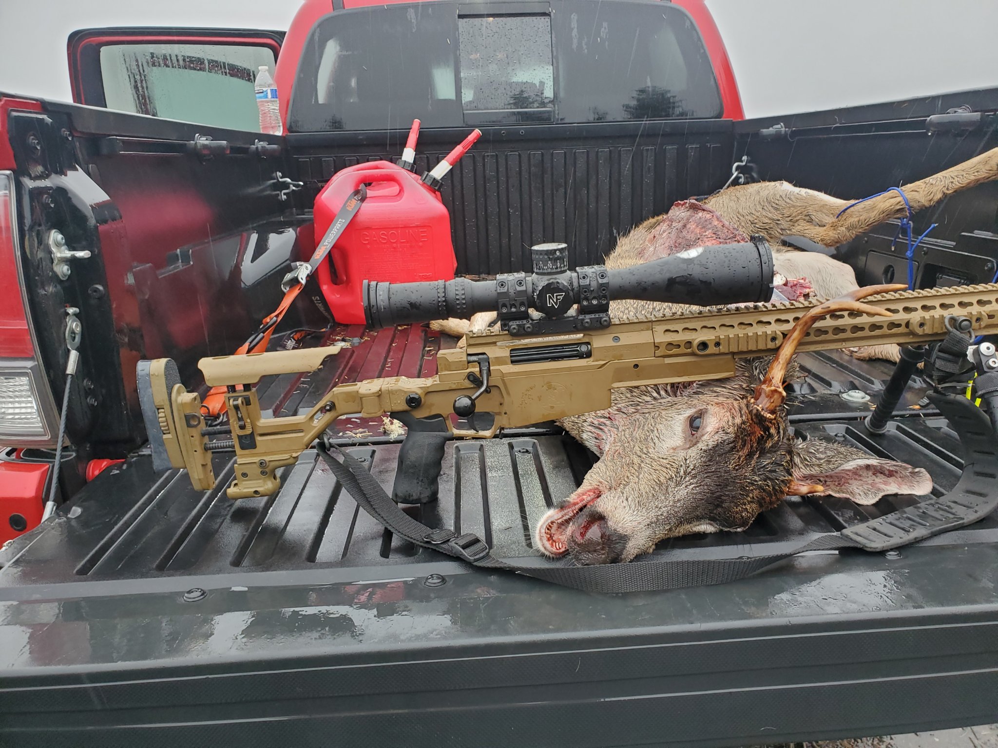

    10k gets you 2 nice customs and either 2 great scopes or 1 alpha scope to swap back and forth.
    I went two customs versus a switch barrel setup. I almost went 308win and 300wsm. However I went 20" 6.5cm and 24" 300wsm other then the chambering they are identical. I figured 2 was better then 1 as I would always have a backup ready to go.
    What he fuck rifles and scopes are you talking about? $2500 per rifle and per scope?
    $10k buys 1 Alpha rifle and 1 Alpha scope.

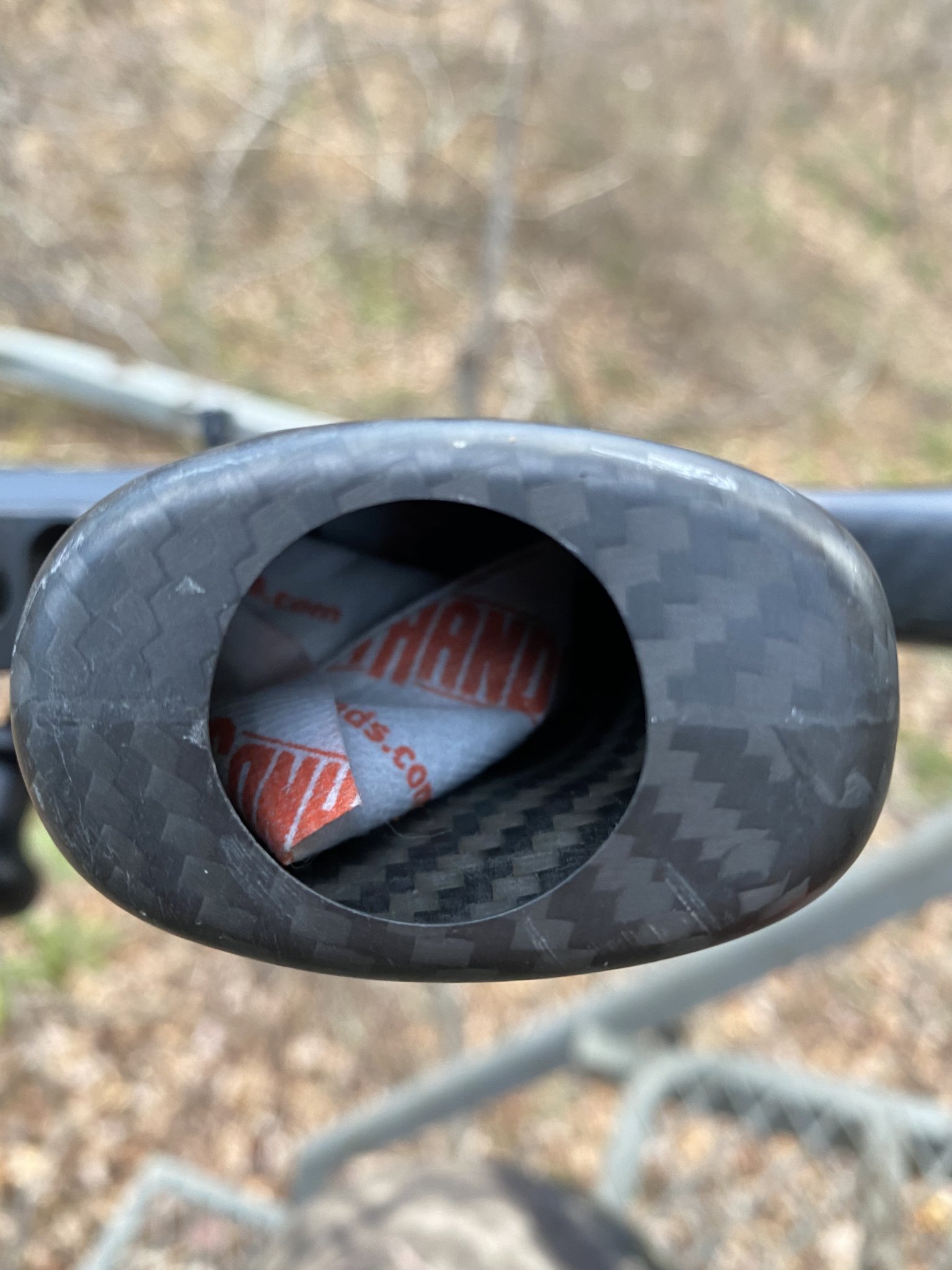

    Also, researching cans now…. Have several already, but only one of mine is compatible with this round. Ironically it’s also one of my smallest; a Thunderbeast 5C that I have on the 300BLK upper for one of my SBR’d PDW builds:
    Looks huge there…but it’s because that rifle is so tiny, that’s a pretty small can.
    Ironically, my largest can, a Bower’s 458 versadapt that I mainly use on a 450 Bushmaster upper, but occasionally throw on my .308 guns too if I’m not carrying it too far … have lighter/smaller 7.62 cans for that. That 458 can certainly has the bore and volume, but is only rated up to 2,650fps, and I think even the lightest 300WSM loads will exceed that.
    Here’s that can on a 10.5” barrel in 450BM, but tucked under a 15” rail…it’s a huge can:
    …edit: and yes, that lower is also SBR’d … LOL
    Edit #2: On the notification list w/Silencershop for when the Thunderbeast Ultra 9CB is back in stock,but will probably go ahead and order a Deadair Nomad-LT for this build mañana. Will be ironic if I get the can before the Action! LOL
    At some point I will build up something on a long action (leaning towards 300 PRC now), and want to have a can that can handle that too…but not sure I want to go all the way up to a 338-rated can for that build, even if I’m not humping it around in the woods / shooting primarily from a rest.

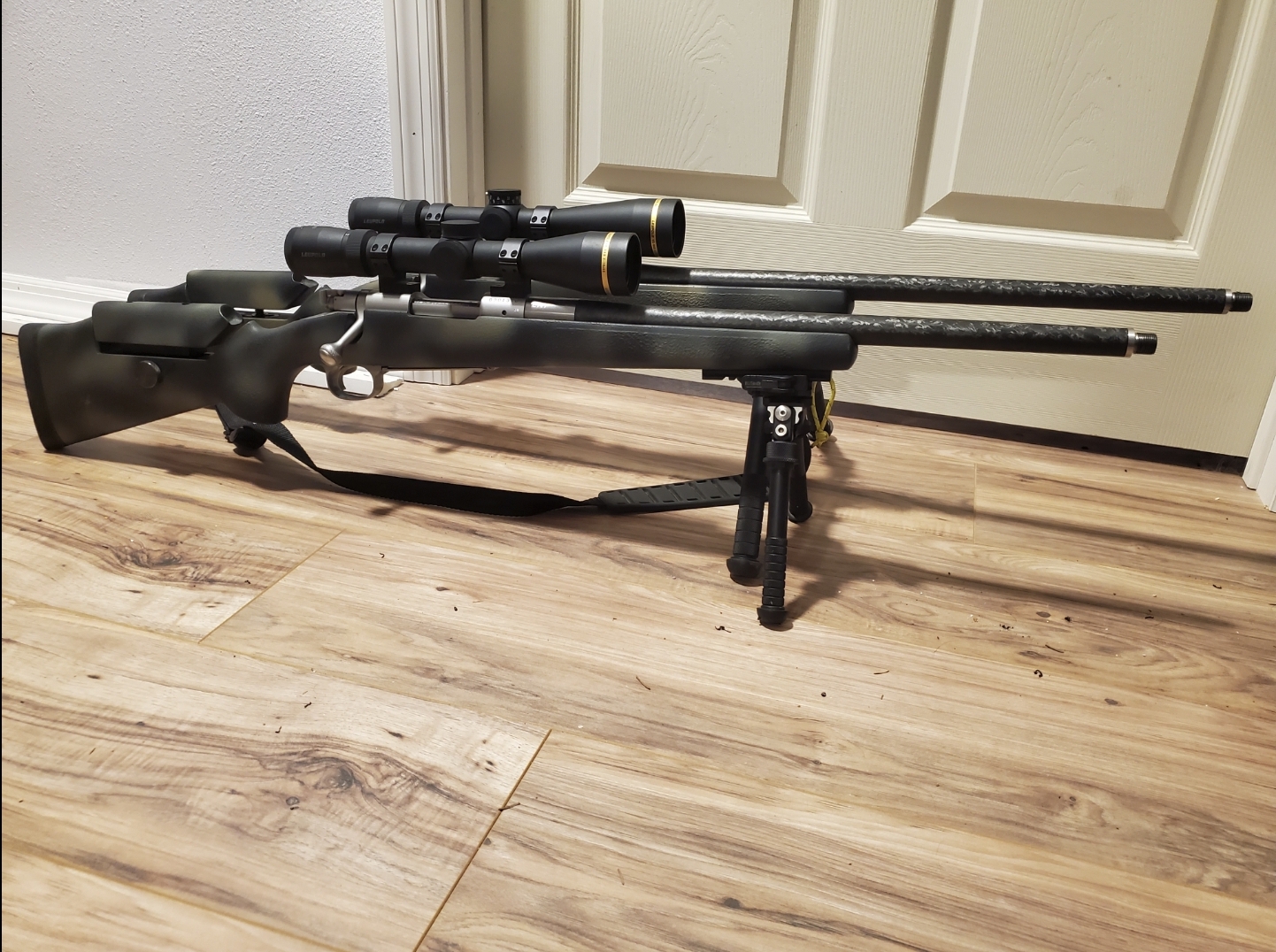

    A couple of LRI built hunting rifles. They wear a NX8 2.5-20 and a nxs 2.5-10x42 now though.
    The rifle in front is a rebarrel/fit stock deal. Good job throwing LRI out of your suck to try and sound expensive. A typical full build from LRI, from scratch, is $6k+.
    Not quite sure what you are saying. LRI did the accurizing and barrel install. I did the bedding.
    I'm assuming you could be at the same money using prefits and a rem clones and chassis's.
    Edit: I grew up hunting Winchester m70's so both started as donors. One was a 308 and one was a 270wsm.
    That's exactly what I'm saying, $2.5k doesn't get it done on a turn key build. You saying $10k buys 2 rifles and 2 scopes is bullshit without plenty of DIY work and cheap scopes.
    Chassis $1,000
    Trigger $200
    Barrel $850
    Action $1,200
    Rifle Total. $3,250
    Scope $1,650 (eurooptic.com NX8 2.5-20 demo)
    Rifle and scope = $4,900
    Now you still need a magazine and scope rings. But you can save a decent chuck of the above prices but shopping sales or in the classifieds.
