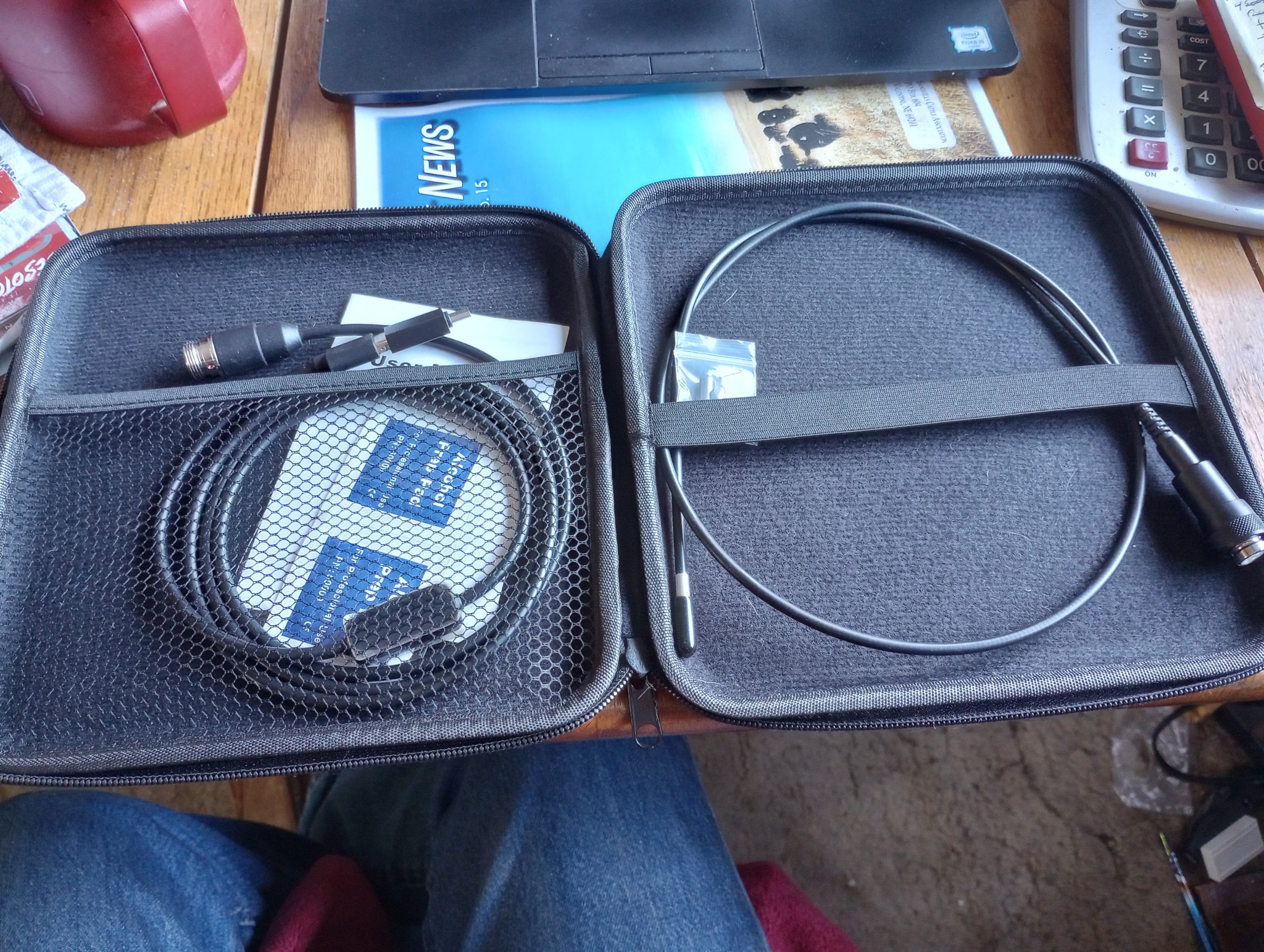

I have this one...works with my tablet or phone.
