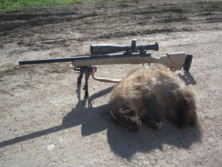

Something like this?
Remington long action, m24 contour barrel, HS Precision stock, 20 moa rail and PTG bottom metal.
The only things "m24" about it are the action and stock, but it looks the part. Chambered in 6.5x55
Absolutely nailed what I'm going after! I apologize guys for not being as technical as you all, I'm not a bolt action guy at all.
