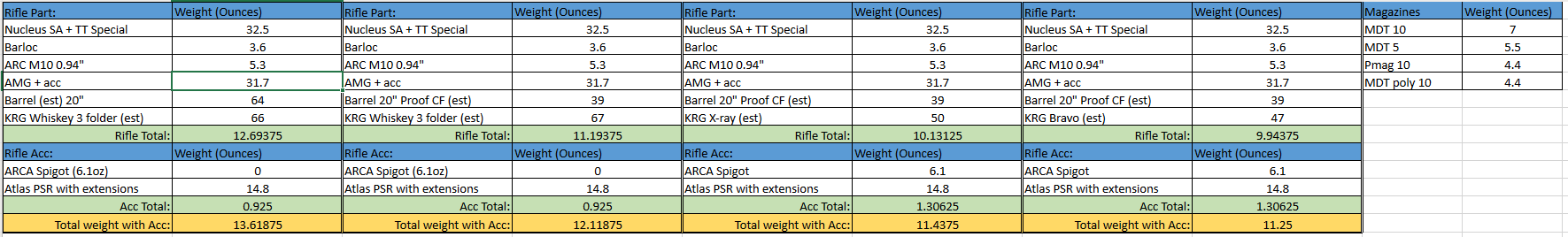

I kind of have a similar thing going for myself right now, except competitions aren't in the picture at all. This going to be a coyote and gopher 223 rifle, possibly run as a 6.5cm for hunting season if I stick around this neck of the woods. Will be minimal stalking, but the weight should be manageable if I do have to walk for a bit. Folder with a 20" barrel should fold up to around 32" total length iirc. Anything listed as (est) hasn't been weighed in person and are just guesstimate numbers or numbers I pulled off manufacturer websites. Steel barrel estimate was based off researching online. I'm going for something like a straight taper down to 0.80 at the muzzle.
Reactions: PBWalsh
Wow...color coded and everything! I've got a similar, much less sexy chart.
For me, it's: <10 lbs all in, ideally a DBM, w/ a stock that has traditional ergos (i.e. without a bunch of shit to hang up on clothing, branches, pack straps, get in the way while I'm carrying and slow me down trying to shoulder for a snap shot). I'd take a bolt gun simply because every semi-auto I've seen makes you pay roughly a 2 lb penalty for the same performance and there aren't too many situations that require you to burn it down. No real preference on trigger. I'd like glass that goes to 20+ (wouldn't we all?), but it needs to start at 4x or less. I'd take glass that tops out at 12-15 if it's outstanding at max magnification and the right combination of light and robust.
I realized pretty quickly that for less than $3k, I cannot come even close to beating the Seekins PH2 as a value proposition. That would be my first choice for the type of rifle you want, honestly. I'd take .284 over 6 CM too, because there's a big difference between throwing 115 versus 180 (or 105 versus 162) at things not made of paper.
If cost is no option... Lots of actions out there right around 2-2.25 lbs. Lots of stocks out there right around 2 lbs. If you want adjustable, now you're talking like 2.75 lbs (there's something to be said for just getting a stock that fits versus one you can fiddle with). A good optic w/ rings will be in the 1.5-2 lb range (and that will exclude all of your BIG FFP super zoom comp scopes that weigh 2.5 lbs by themselves, of course). That takes us to...around 6 lbs, and we don't have a barrel, mags, bottom metal, etc. So, flute everything that can be fluted, buy Ti if you can and get either a carbon or fluted barrel depending on your preference. You might not beat the PH2 on weight, but you'll likely be in the ball park and you'll have a custom gun to your specs.
FWIW, my KRG SOTIC is a ~5.75 lb barrelled action in a 3.7 lb W-3 chassis - I think I weighed it out at 14 lbs all up. Much more than I want to carry, personally. Then again, carry for me is usually that - rifle in hands with a sling to help. If your rifle spends a lot of time riding your sling or pack hands free, the picture might be different.

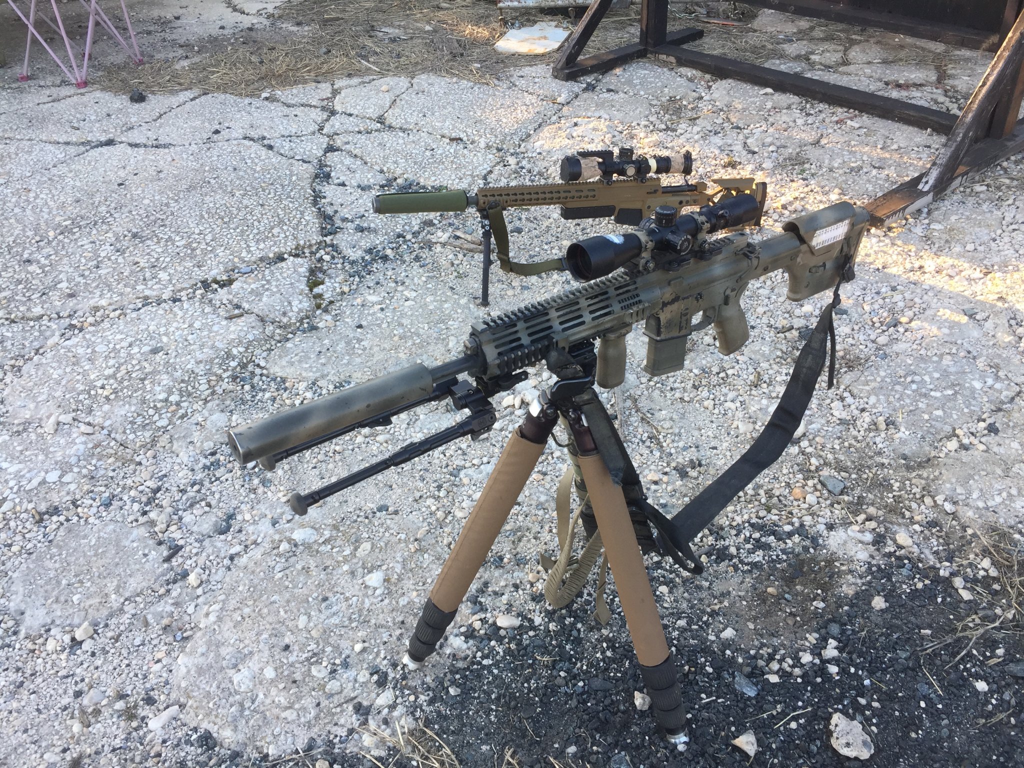

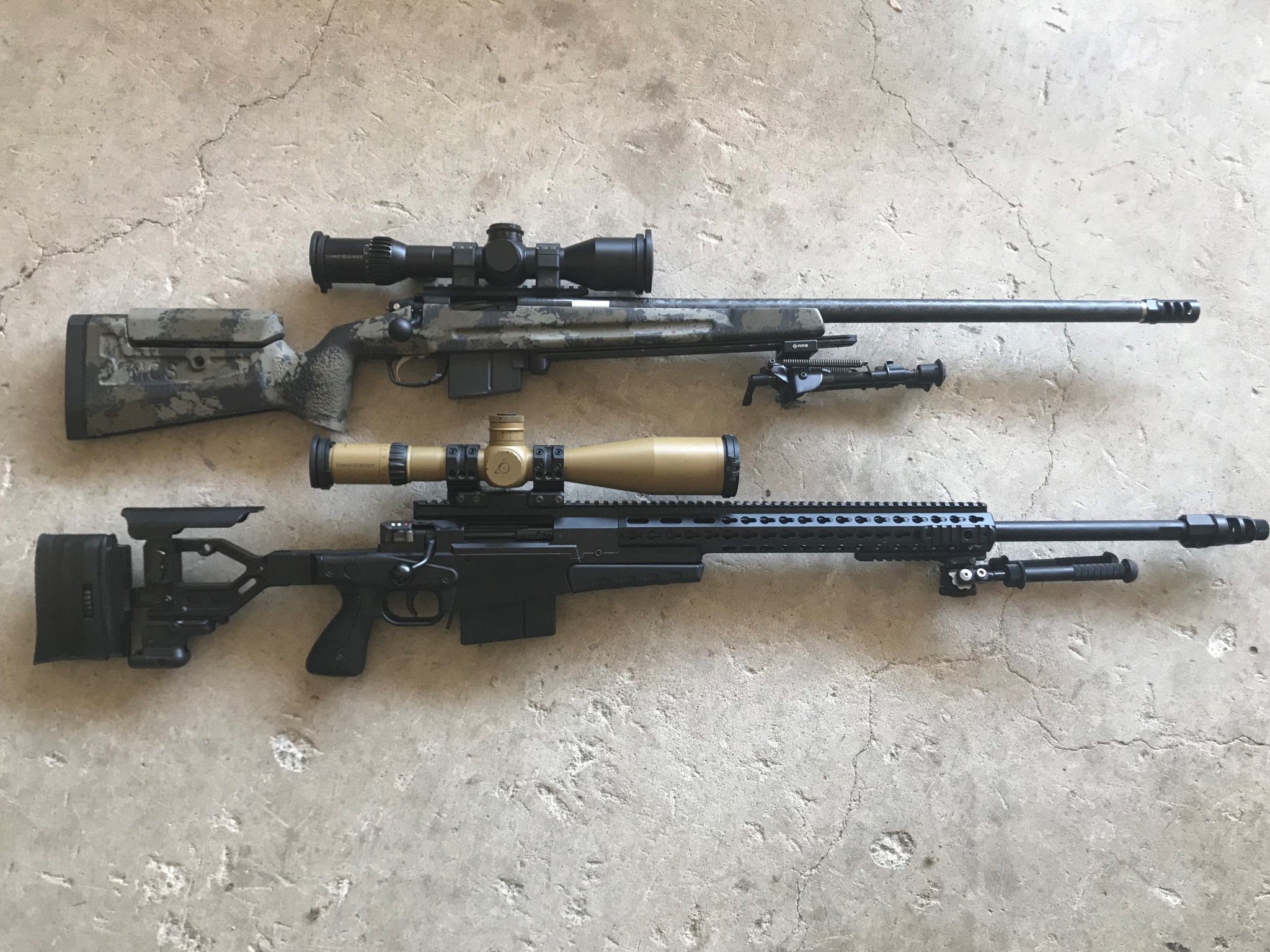

The top rifle is my 90% do all rifle. If you're interested in 7mm, take a look at 7mm SAW, that's what this rifle is chambered in. I use the Sierra 160TMK at 2828fps in this rifle using RL16. Weighs 11.9lb. Have had the 162ELDs to 2865fps in my other 7mm SAW rifle

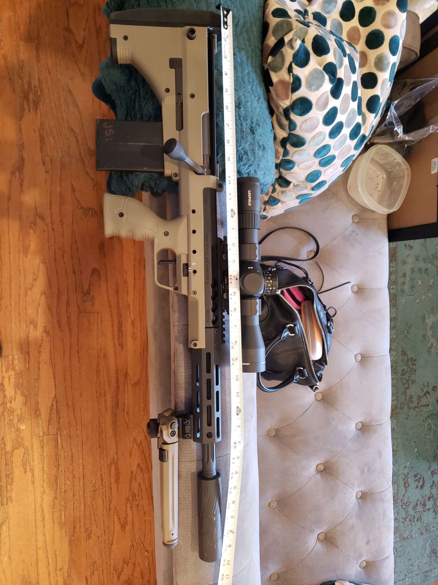

What you’re describing is exactly what I do with my AIAT. I have a 16.5” barrel on it and a 4-16x42 ATACR. I don’t think I need to speak to reliability. With the short barrel it’s easy enough to handle. I think the extra weight is useful for the field expedient opportunities I am presented with. Guess I’m the outlier here but unless you’re walking up a mountain, I’ve never understood why so many folks think a hunting rifle has to be light.
I used a 16.5" AT all last year. It's is very handy and worked just fine. What I have decided is I like to walk with the rifle in hand and I don't find the AT fits me well for that. It wasn't the weight but the square forend that bothers me. I should probably just grab a biathelon sling and go on but I want something new ;-)

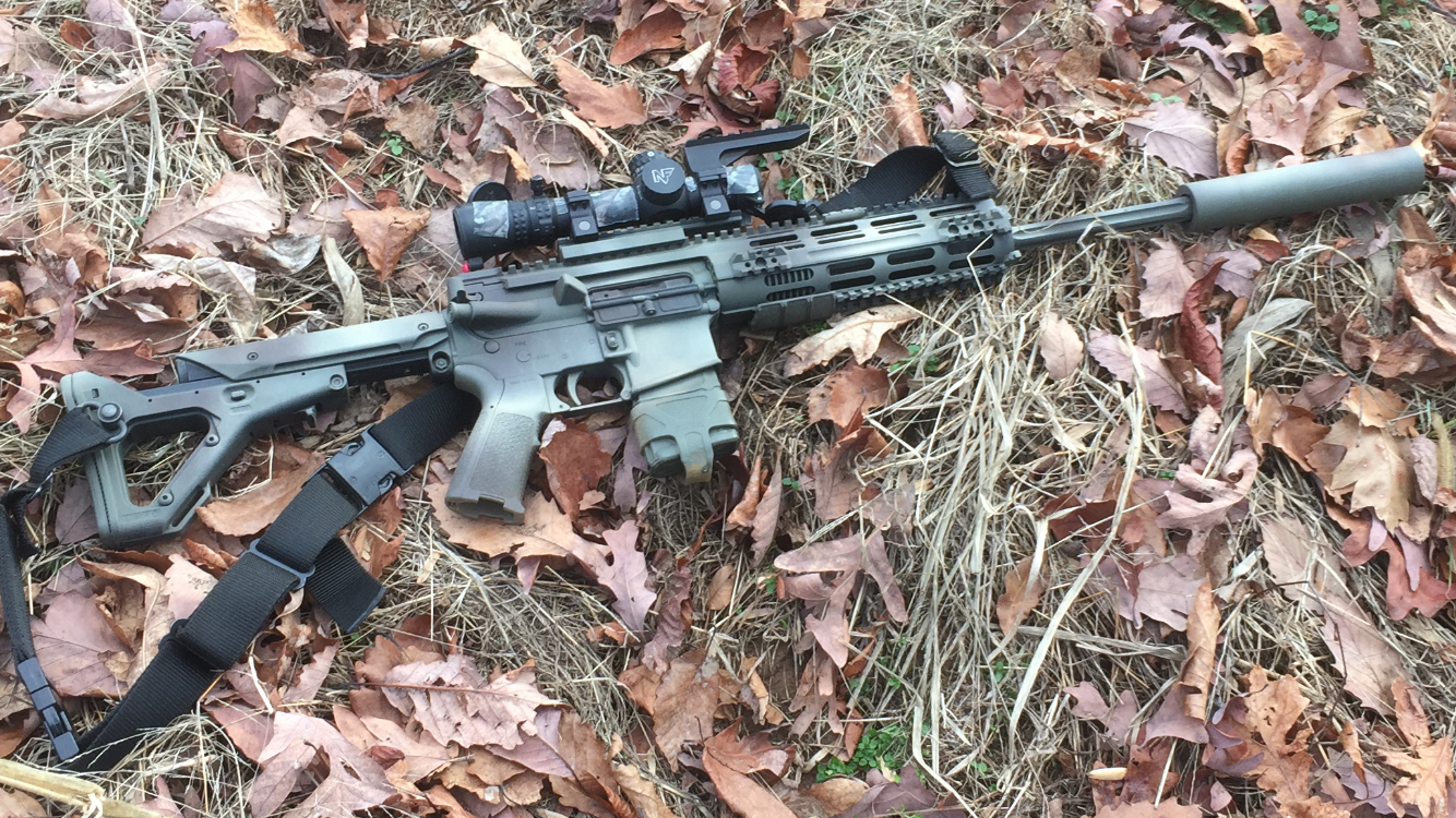

33 inches with suppressor, 140 bergers from berger ammo at 2620 from 18 inch barrel. 11.5lbs. Handy.

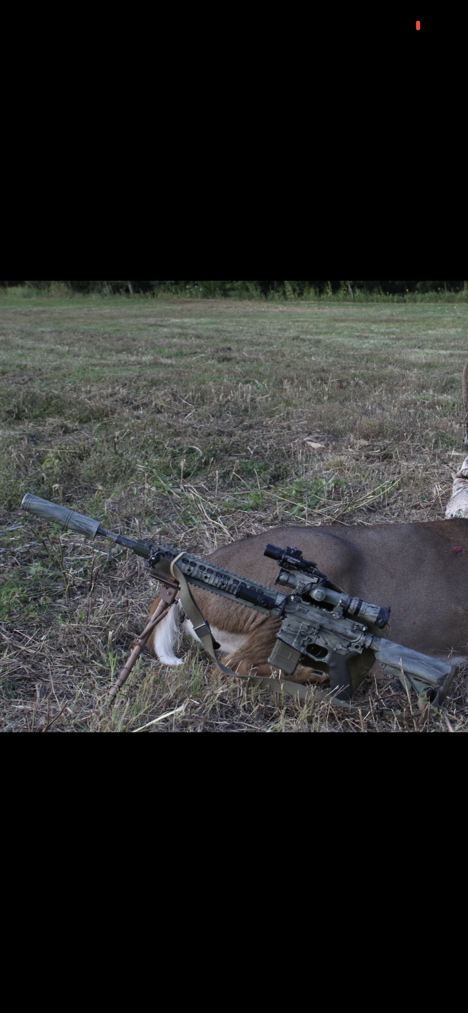

For me it’s a Tikka action, manners mcst stock and an 18” med light Benchmark barrel threaded for my can. If it were stolen, I would build the exact same thing again.

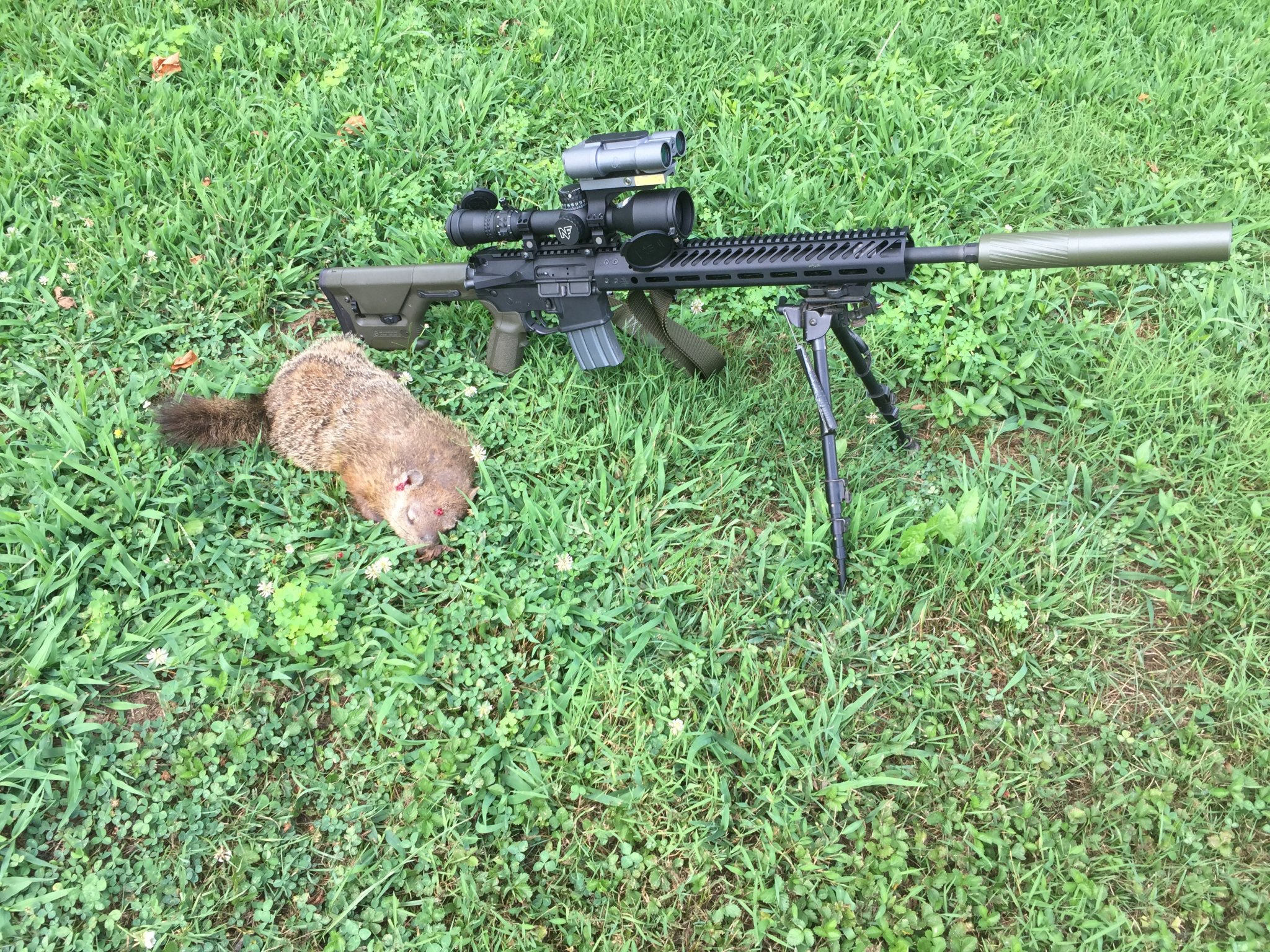

you can get a AX it has a round foreend lol. I use that or a DTA when ground hogging
Sounds like you and I have the exact same idea along these lines. I do find the 18” barrel a bit better killer.

Here is my solution to the do it all rig.
Bighorn Origin
8” twist Bartlein #3 5R chambered in 6.5 Creedmoor, finished at 24”
McMillan Carbon Ambush Adjustable Game Scout
APA Bottom Metal
Triggertech Diamond
Bushnell 3-12 LRTSi
’smithed by Jon Beanland
I‘m also in West Texas, about 15 miles north of Sweetwater, and this is the rig I grab most often.
John
