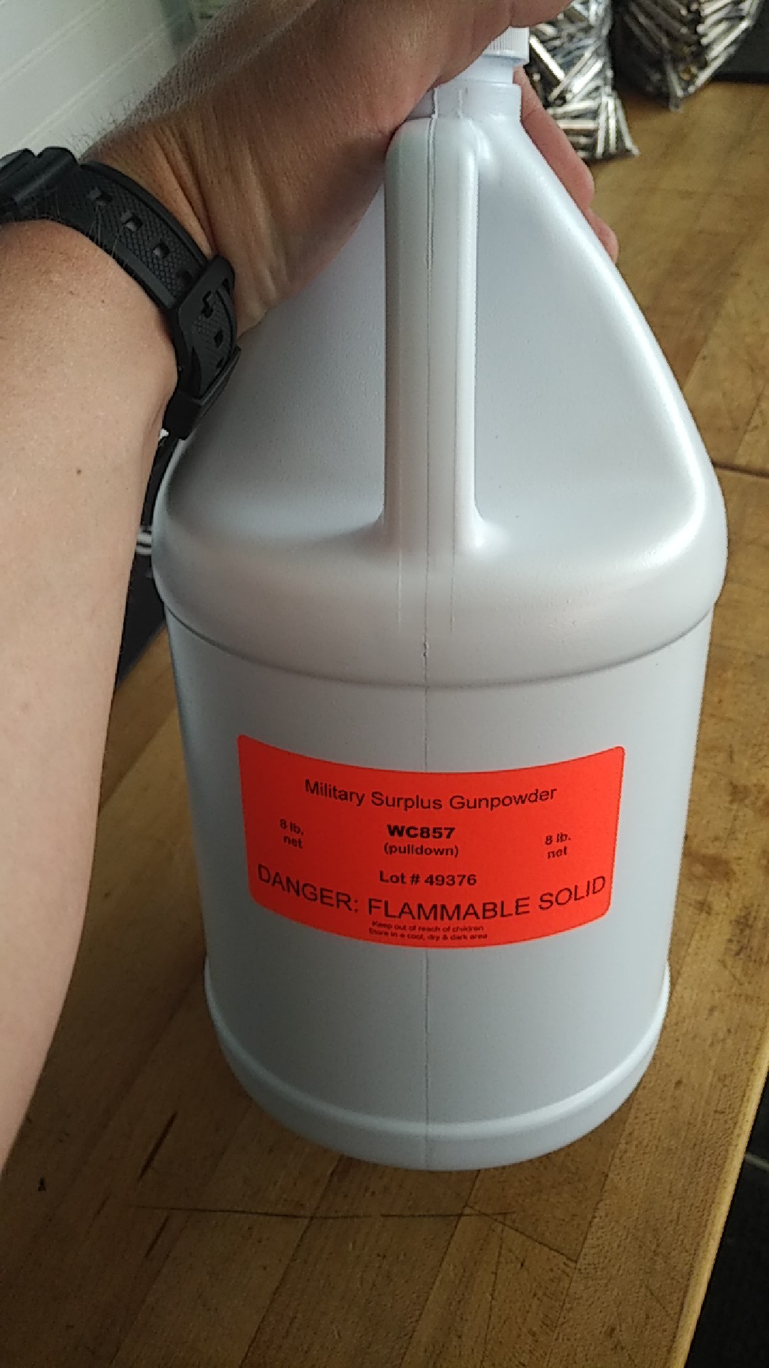

    Pulled the trigger on a jug. For $80 per 8# jug + shipping ($30 Hazmat) and a burn rate which hovers around H1000-ish... sign me the fuck up. Beats ~$30/Lb for H1000 at all my local joints.
    It should bode well for my 7mm RemMag shenanigans with 168 and 175 grainers. (T minus 14 hours, 52 minutes until my Tikka T3x gets out of Commie Cali Gun Jail)
    WC857 Powder $80 a jug!
    From the website:
    "WC857 New item. A slow burning ball type powder developed for the .50BMG tracer ammo. This powder burns faster than the typical WC860 thru WC872 series of powders. This powder has not been released as a canister powder. Loads can be worked up using H-870 or AA-8700 data, less 10%. Burning rate seems to be similar to Hodgdon H1000 or Reloder 25. An excellent choice for the .300 Win Mag, 7mm Mag, and other magnum type calibers. Good results in .25-06 with heavy bullets. This is pulldown ball powder from Lake City."

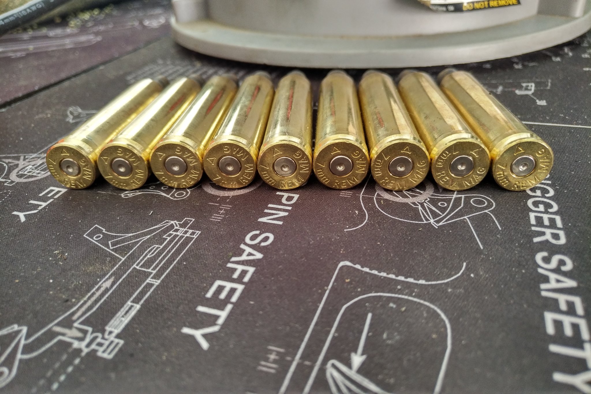

    Since I just got me some of the brand new, beautiful Atlas Development Group brass, I'm gonna load up some blem 175 ELDx's and use a lighter load (60 grains or so) to fire form that brass to my chamber for their first firing. Gonna hit a 400 yard range early next week. Should be fun.

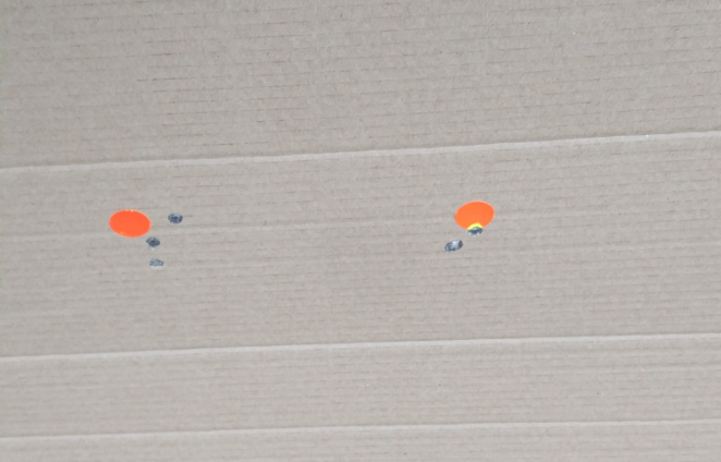

    Was able to fire 30 rounds of my "fireform" load: 64.0 grains of WC857, 175g ELD-X, Virgin ADG Brass, 3.34" COAL. Didn't see any unburnt powder in the barrel when I was pulling the bolt for the first 5 rounds. Brass had some carbon around the necks. Obviously no pressure related signs at all with an average velocity of 2335 via magnetospeed.
    When I actually settled in and did my final 5 shot group with my very warm Tikka T3X Lite (Sporter contour) barrel.

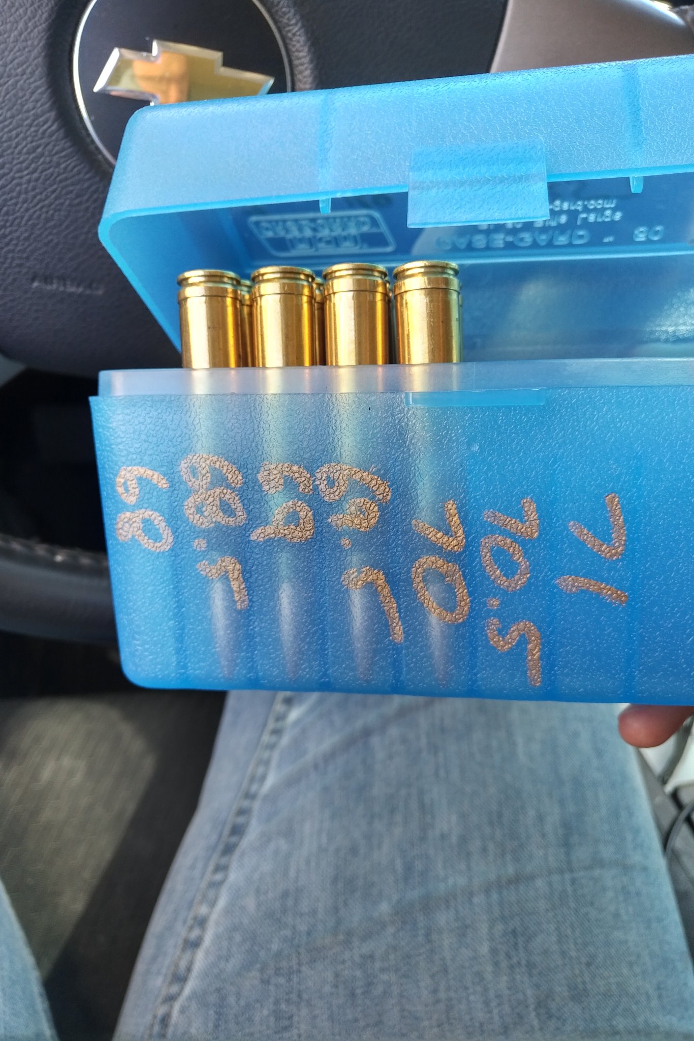

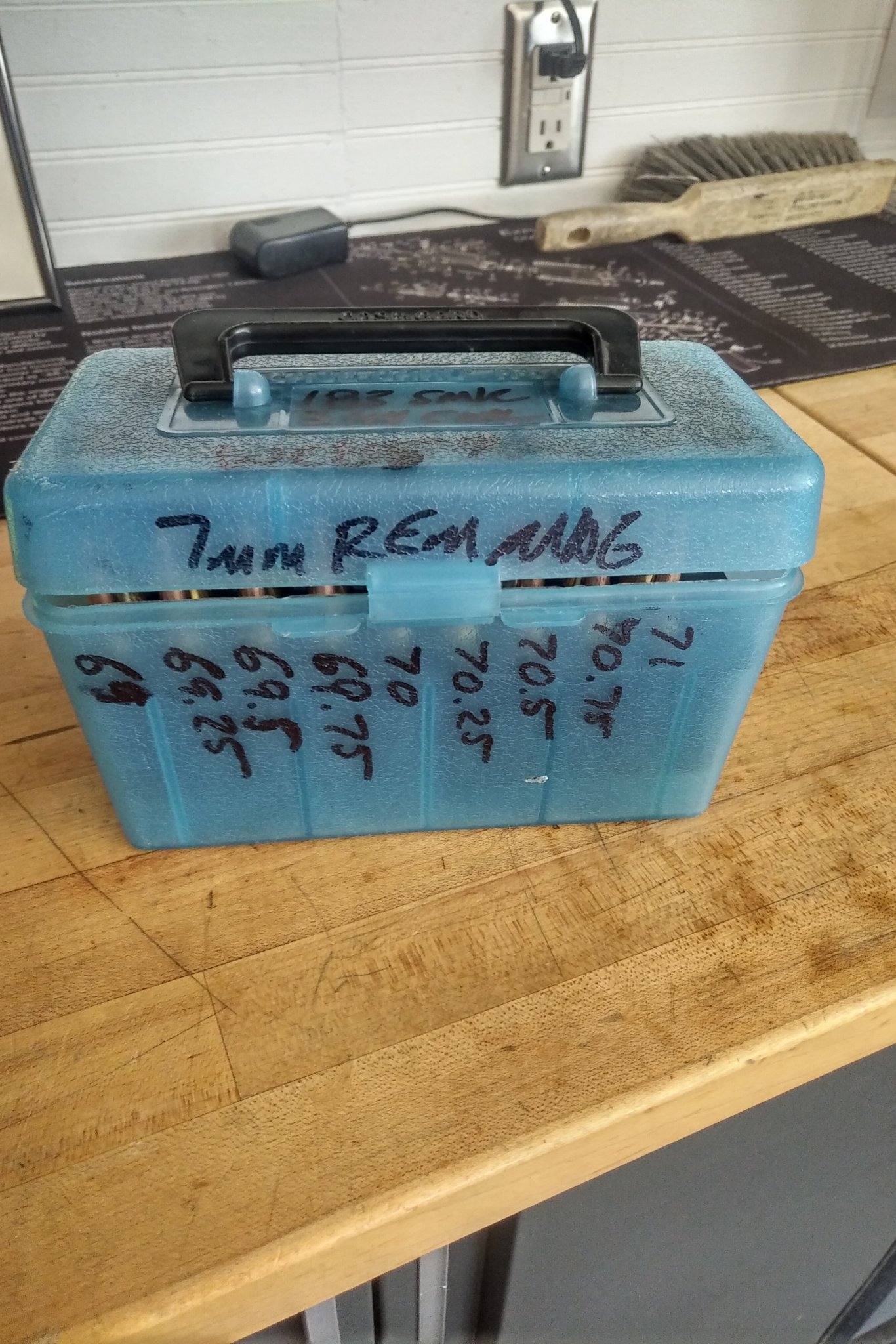

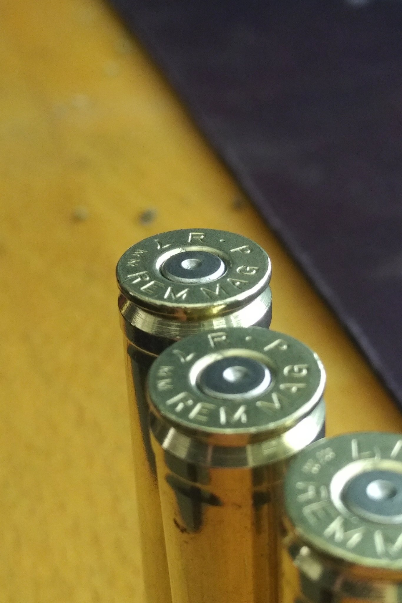

    On 4/22/19 Made a bunch of fireform loads with my RP brass, 168 SMK's and 67g of WC857. On 4/23, Velocity was 2550 and ping'd 2 MOA steel out to 600 with boring regularity yesterday. .020" jump.
    Today loaded up 3 each 68.5, 69, 69.5, 70 and gonna let you crazies know how it goes.

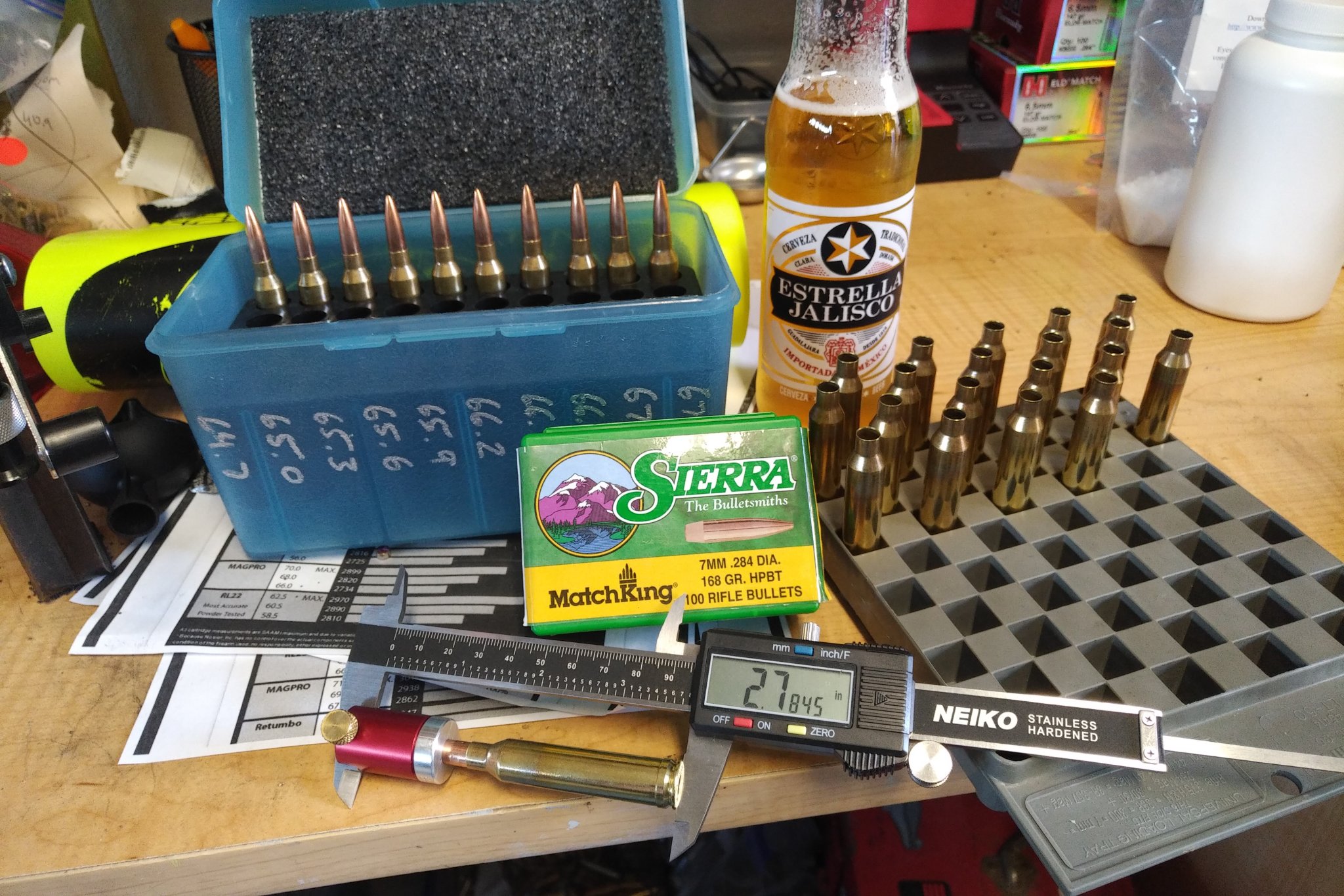

    Brass: RP, full length sized, annealed
    Bullet: Sierra .284", 168g Matchking
    Primer: FGMM 215M
    Powder: WC857, 68.5g-70g, .5g increments.
    Length: 2.785" base to Ogive ~3.34 COAL (.020" jump)

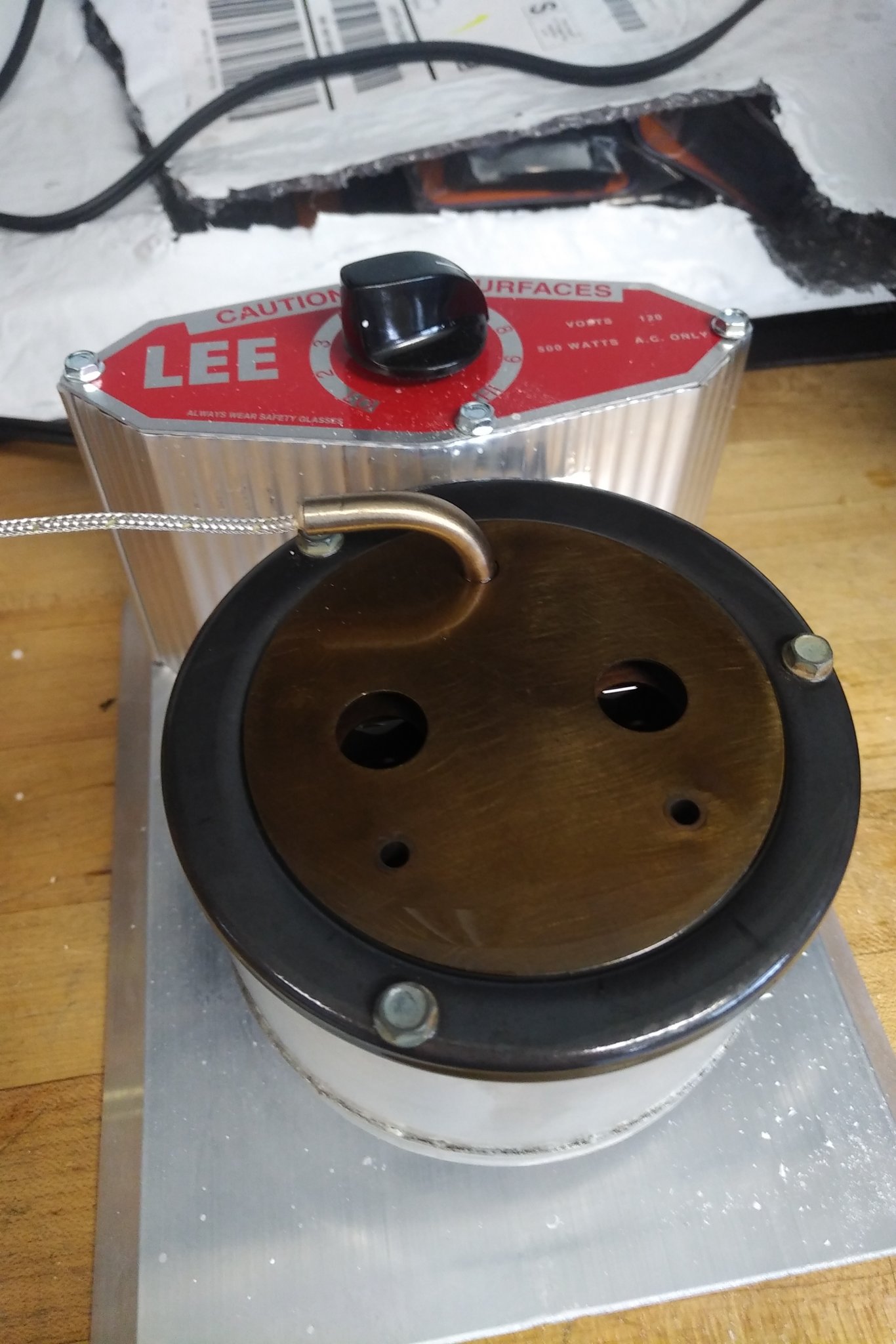

    What are you using to anneal?

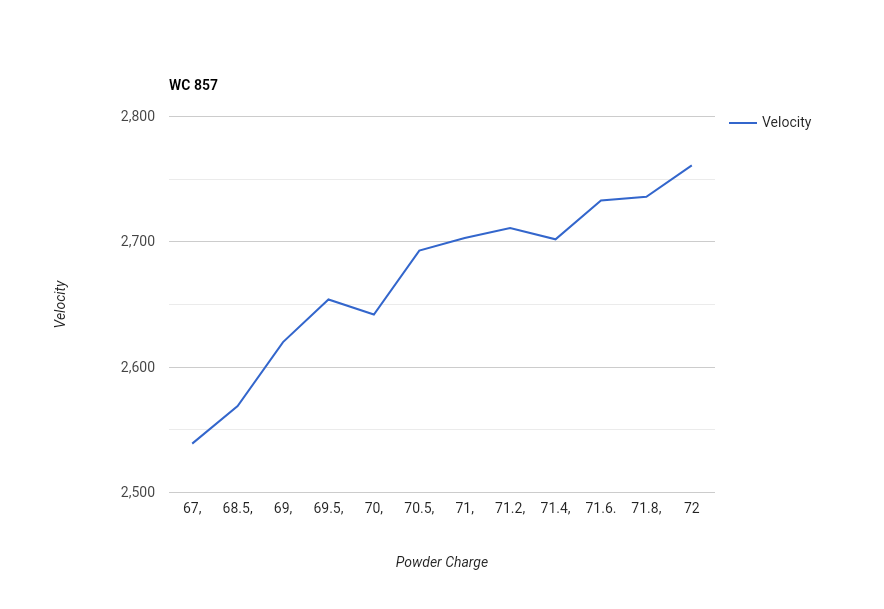

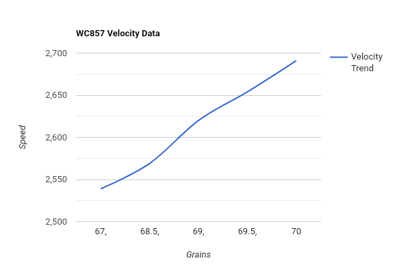

    For those interested, here is the velocity graphed out.... Fairly consistent trend working out to be about 50 FPS per grain increase. Which shows I would need 72 grains to get to my desired velocity of 2875-2900fps at 75*f.

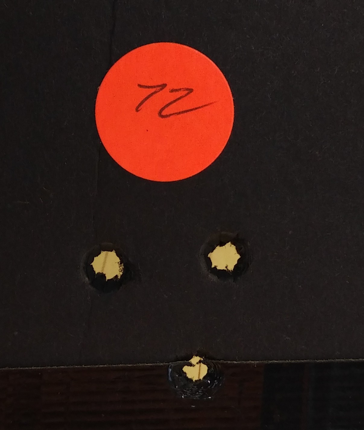

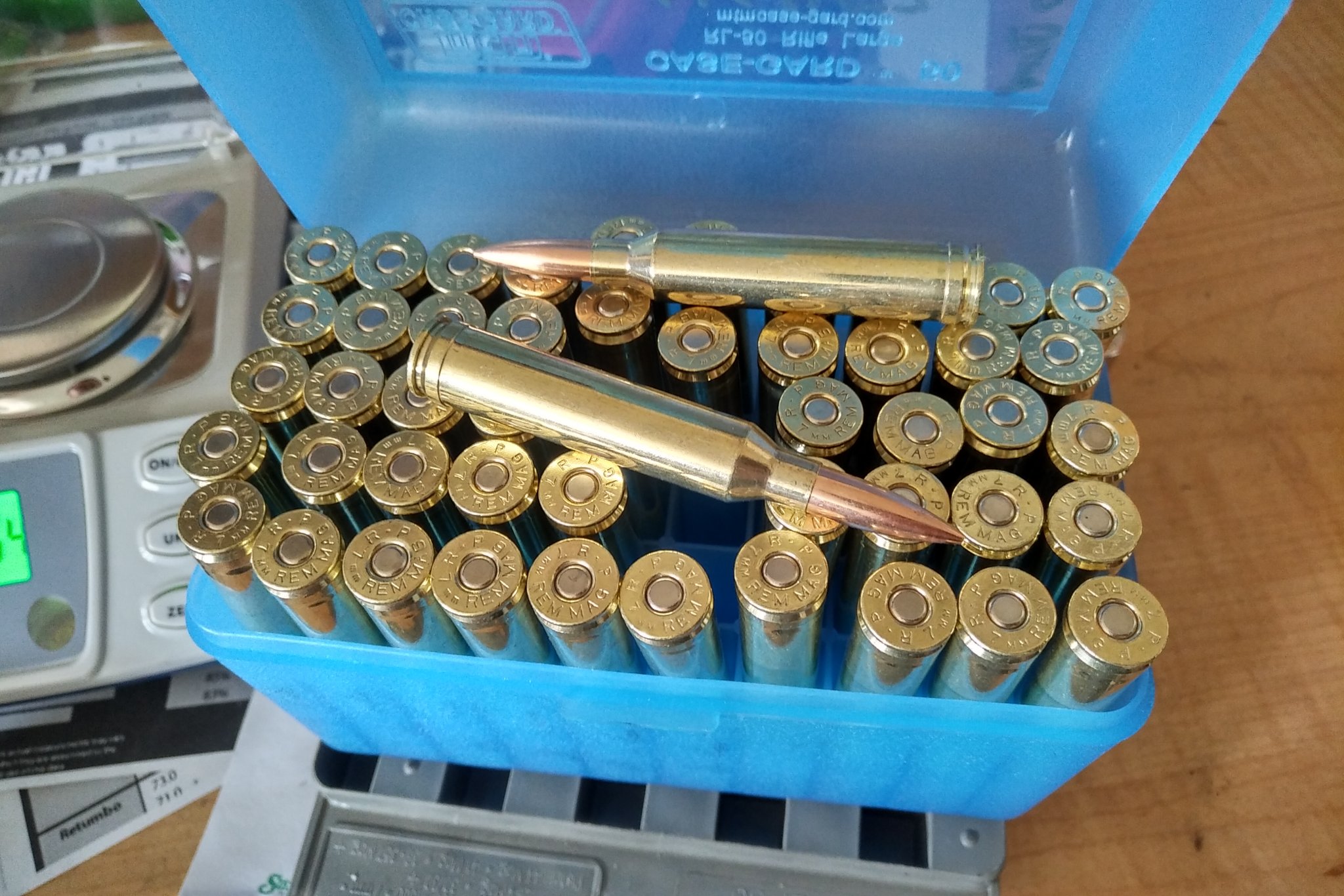

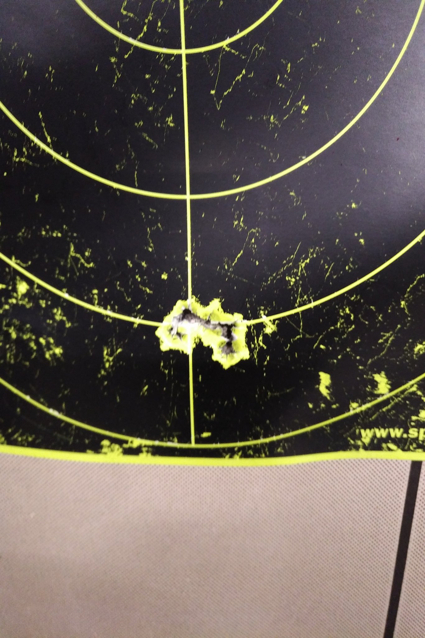

    OK, so..... The orange dots are .75". Overall satisfied with the 72g load. No signs of pressure at all. I have loaded of 5 more at 72 as well as 3 each at 72.2-73 in .2g increments to see if the "node" I may have stumbled upon at 72 will extend out to 72.2 or 72.4
    72g: AVG: 2761, SD 6, ES 12. .697 MOA
    Here is the velocity line graph from 67g up to 72g:

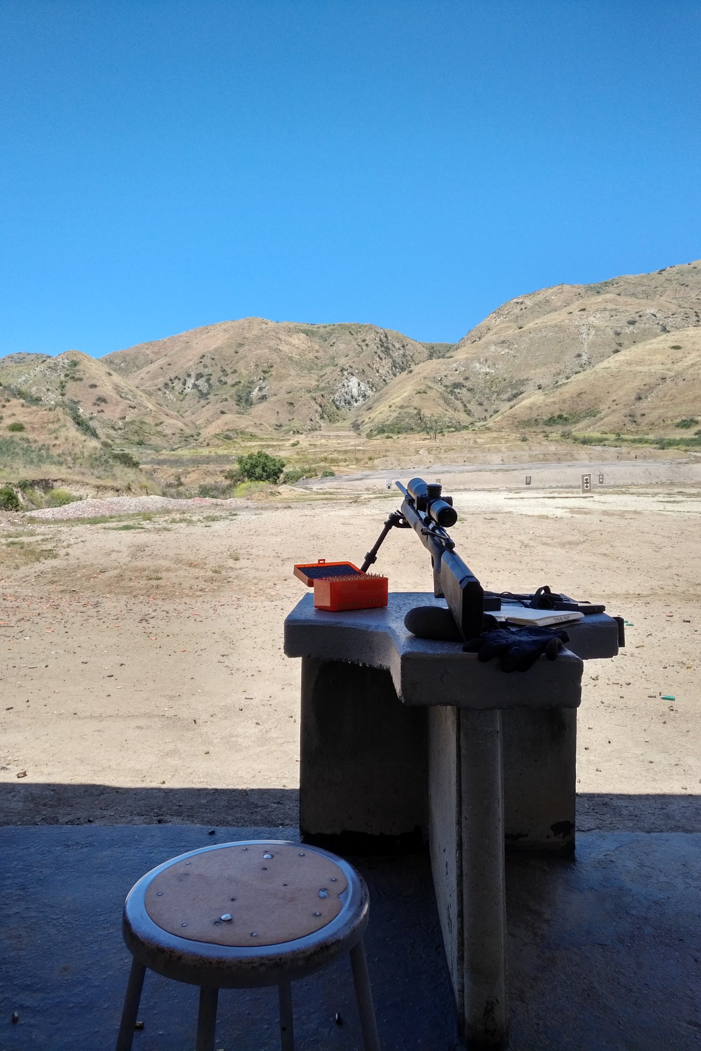

    Slight change in plans. I'm headed out to the desert tomorrow to shoot all day from 100 to 1300+. I loaded a mess of the 72g load, as you can see. I actually loaded a total of 70 rounds of that load. I'll throw my magnetospeed and check speeds for a few here and there during the day to see how the velocity marches out as the heat goes up from 65 to 90*f or so.
    I also made a bunch of my pet 6.5CR loads with Reloder 17 and H4350. I'm predicting my Reloder 17 will probably go from 2680 (at 65 degrees) to probably 2750 at 90*.... She get pissy when it's warm out.

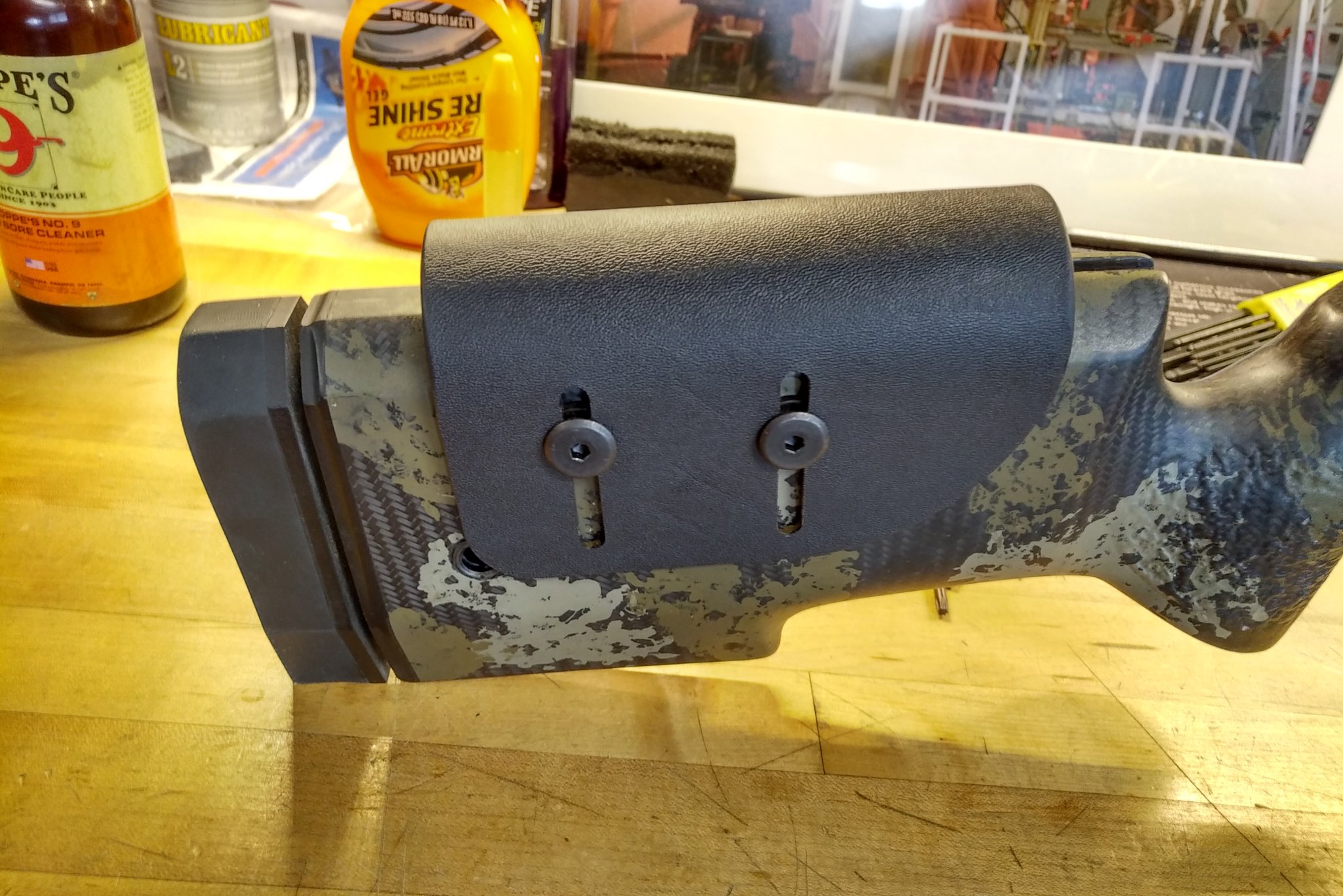

    My cheek was definitely smoked from my new kydex cheek riser. It works very well, but after 70 rounds of 7mm RemMag.... It just kinda makes you go "OUCHFUCK" after a while.

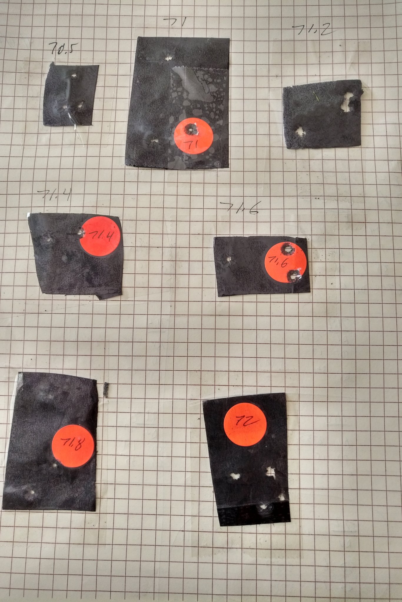

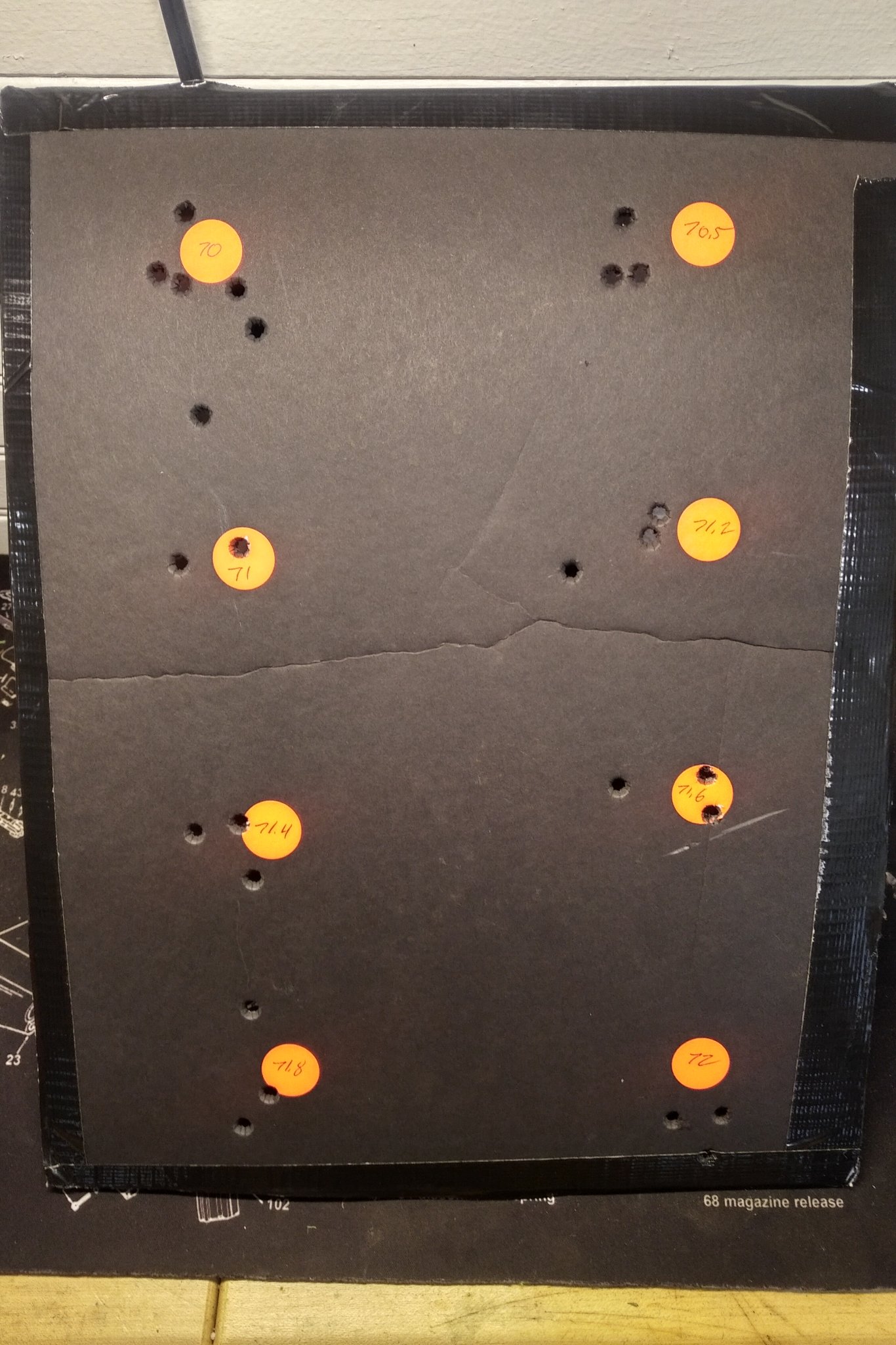

    FINALLY!! Tomorrow is the day I'm gonna finally be able to test my 72-73g load series. The weather looks like the weather is gonna be sunny, 76* and winds 10 and under.
    I'm glad you asked....
    Date 5/31/19
    Temperature 72*f
    SP: 25.47 inHg
    RH: 44%
    DA: 6400
    72g: V 2748, SD 6, ES 13
    72.2: V 2764, SD 2, ES 7
    72.4: V 2776, SD 14, ES 29
    72.6: V 2768, SD 13, ES 26
    72.8: V 2794, SD 9, ES 19
    73: V 2777, SD 14, ES 28
    No pressure on anything. None, save for some slight primer flattening on 2-3 random cases.

    As far as group sizes go.... While I was shooting with the 168 Matchkings, the MagnetoSpeed kept sliding forward after each successive shot and I believe that caused harmonics to change and groups to vertically string. The MagSpeed normally causes a consistent 1.3mil vertical deflection at 100 yards. I usually just put the MagSpeed on, dial down 1.3 mils, and take a couple confirmation shots at another area of the target. Today it varied from 0.9-1.4 mils.
    I finally ended up cleaning the exterior of the barrel and strap of the MagnetoSpeed before I shot the Nosler 168's, Hornady 175's, and Alco 168's.
    That seemed to settle things down and all those groups were sub-MOA.
    Overall, with RP brass, FED210m Primers, and either 168 Matchkings or Nosler 168 CC's loaded .020" off the lands, 72-72.2 is what I'm sticking with differing conditions and velocities caused by different powder temps... 72 maintains single digit SD's and low ES's

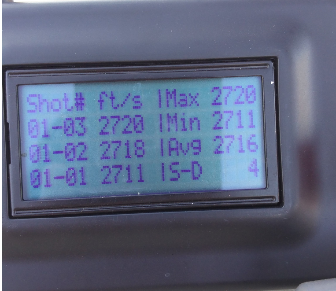

    78.0gr produced a three shot average of 2673 fps with a SD of 3
    79.0gr produced a three shot average of 2716 fps with a SD of 4
