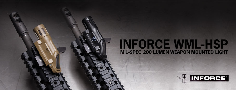

On my 11.5" I use an Inforce WML mounted on a HSP keymod thorntail mount. I also use a surefire X300 on the 12 o'clock position on my other rifles. Surefire makes a pressure switch also.

I just picked up a HSP thorntail SBR mount for my surefire mini scout. I run it at 1 o'clock with the surefire pressure pad snapped at 12 o'clock behind the buis. Works well for me and I use the thumb break technique.
I used a Inforce WML last hunting season and loved it, no bulky or heavy stuff in the way and the slant cut rear switch is nice. Plenty of light for walking out at dark.

DocUSMC makes a good point. There are a ton of good options - you even have 4 different cord lengths to choose from on a SF pressure switch. I love the design of the inforce but I don't care for the power source it uses, the beam pattern or the level of output.
