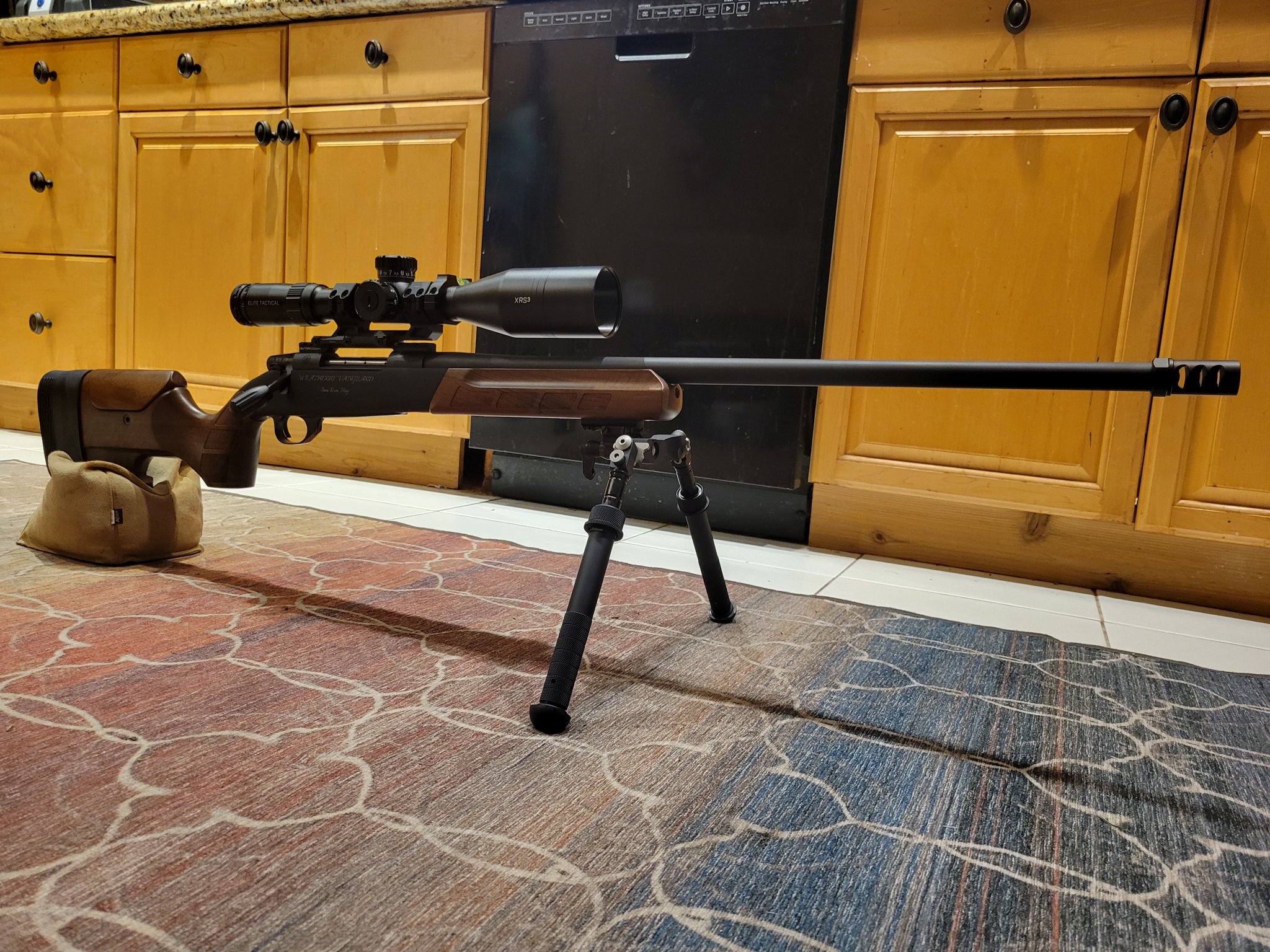

When I was growing up everyone talked about owning Weatherby's but no one ever presented one because they were full of crap. LOL The Weatherby Mk V is a top notch rifle, but as someone above mentioned, there's not a lot of aftermarket for them as I can recall. I built my rifle on a Weatherby Vanguard 7mm Rem Mag action. Tons of stuff out there for that one. Factory two stage trigger is outstanding. This one is a one mile shooter in hands other than mine. LOL
