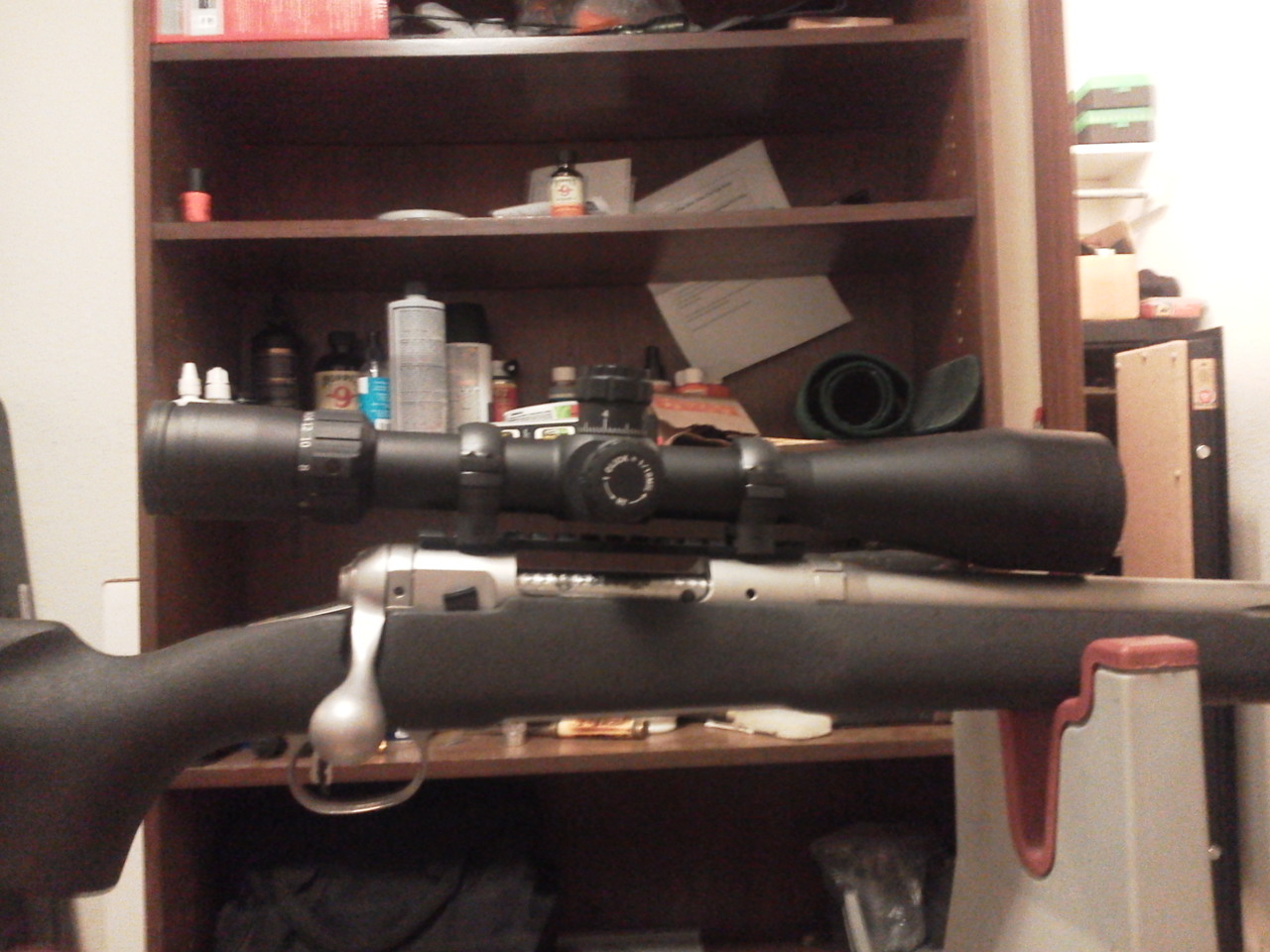

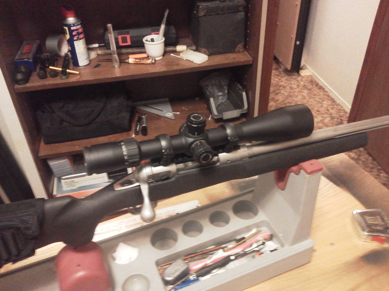

Weaver is only Weaver by name these days. I purchased the Weaver 4-20x FFP because it was cheap at about $790. It is not a bad scope. Standard mildot reticle. Mil turrets with each click more like .097 rather than .1, but even that is normal manufacturer deviation tolerances. Elevation travel is somewhat limited to about 800 yards for .308 Win. I used Burris signature rings with the +/-10moa inserts to get a 20moa lift. Really, this isn't a bad scope that holds zero. It appears to be a rebrand of a different scope that looks just like it but there is nothing wrong with it. It is on a Savage 12/Accutrigger with HS-Precision stock from Stockys. Shoots <4.5" groups at 500 meters. Not bad for factory shit all around. It also has the cheap ass Weaver scope 1-piece base as well. Freakin' scope weighs like 1.75 lbs.
