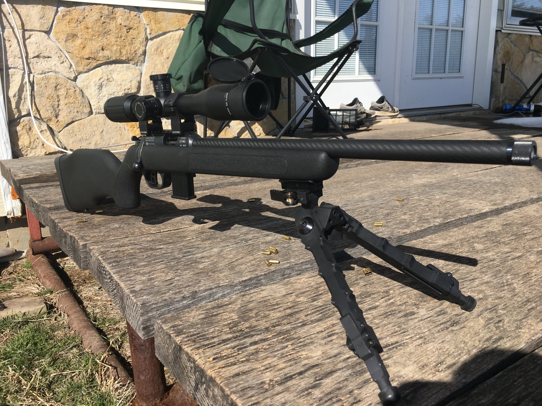

I recently picked up a Webley & Scott Xocet and wanted to give a quick review. The Xocet has a price tag of ~$180 depending where you shop for it. I’m lucky enough to have an FFL buddy that could get me one for a good price so figured I would give it a shot.
Online specs say it weighs 7.5lbs but upon arrival, it weighed in at 5lb 10oz’s on my scale. Pretty comparable to the average rimfire despite having a carbon fiber barrel. It is hard to describe how it feels in hand. It balances excellent with the balance point being centered in the rifle.

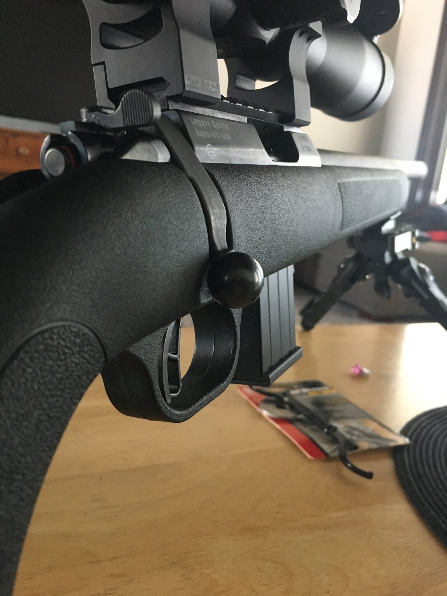

The best way I can describe the feel of the rifle is, a quality built cheap rifle. The bolt is smooth, but the knob feels cheap. The stock has great ergonomics, but feels like your typical Tupperware stock. Trigger is crisp, yet heavier than my liking. I would estimate it to be about a 5lb or so trigger. The trigger has an Accu-Trigger look to it but the center “blade” does not press into the center of the trigger. Kind of odd feeling but crisp as previously mentioned.
The rifle comes with two, 10 round magazines that lock in and drop freely, as a quality rifle should. The rifle feeds flawless and extracted every round flawlessly. When cycling the bolt, at times I would reach and miss the bolt due to it having a much more flush fit to the stock versus a typical bolt rifle that has the bolt extruding from the stock a bit more.
Now for what everyone came here to see, how does it shoot? I robbed an SWFA fixed 10 power scope off an AR15 I had so I had to deal with rings that are too tall. With a less than ideal cheek rest (or should I say, chin rest) due to the tall rings, I am blown away by accuracy thus far. We have had loads of snow here so I only tested 25 yards, but so far things look promising.

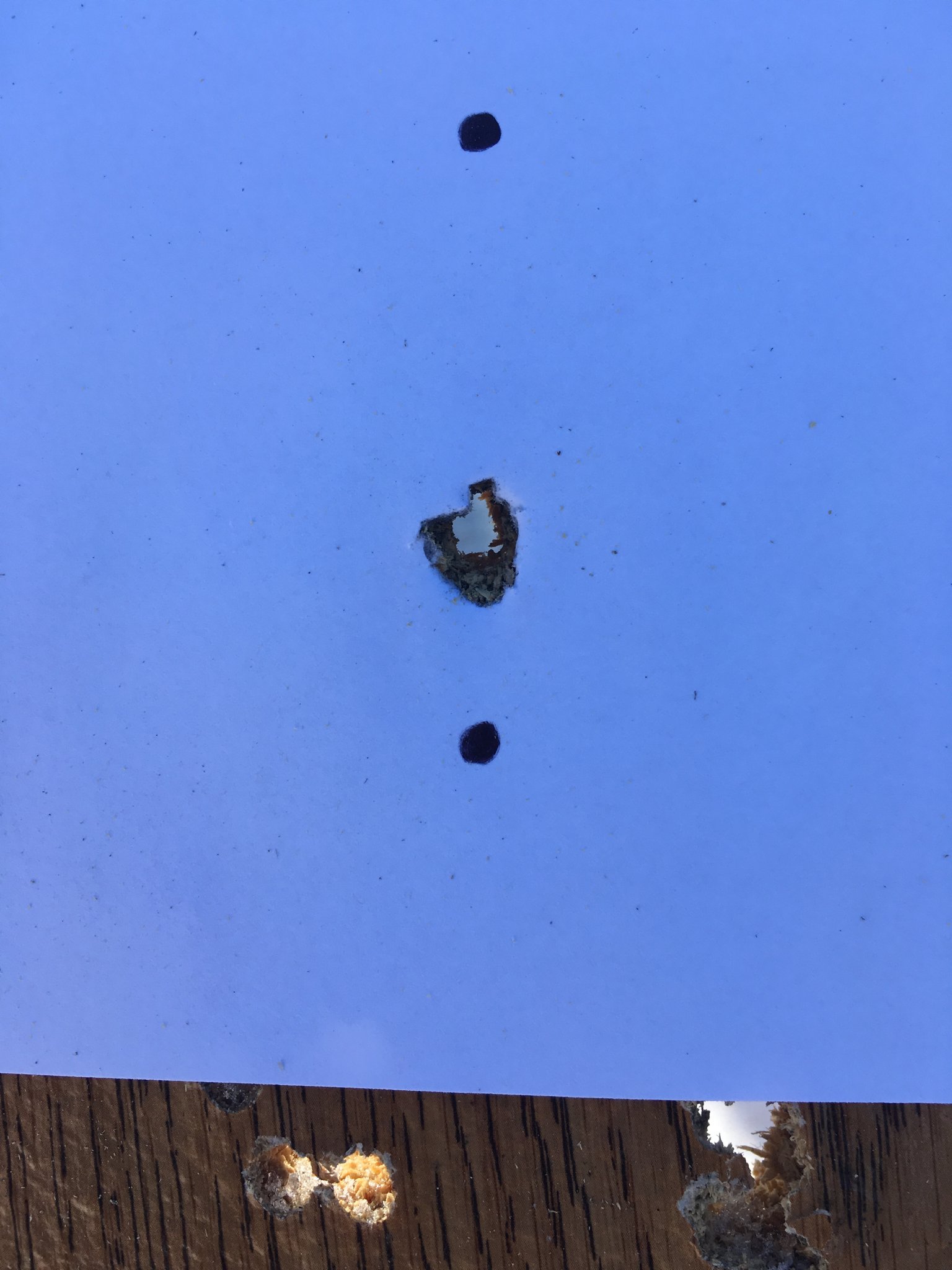

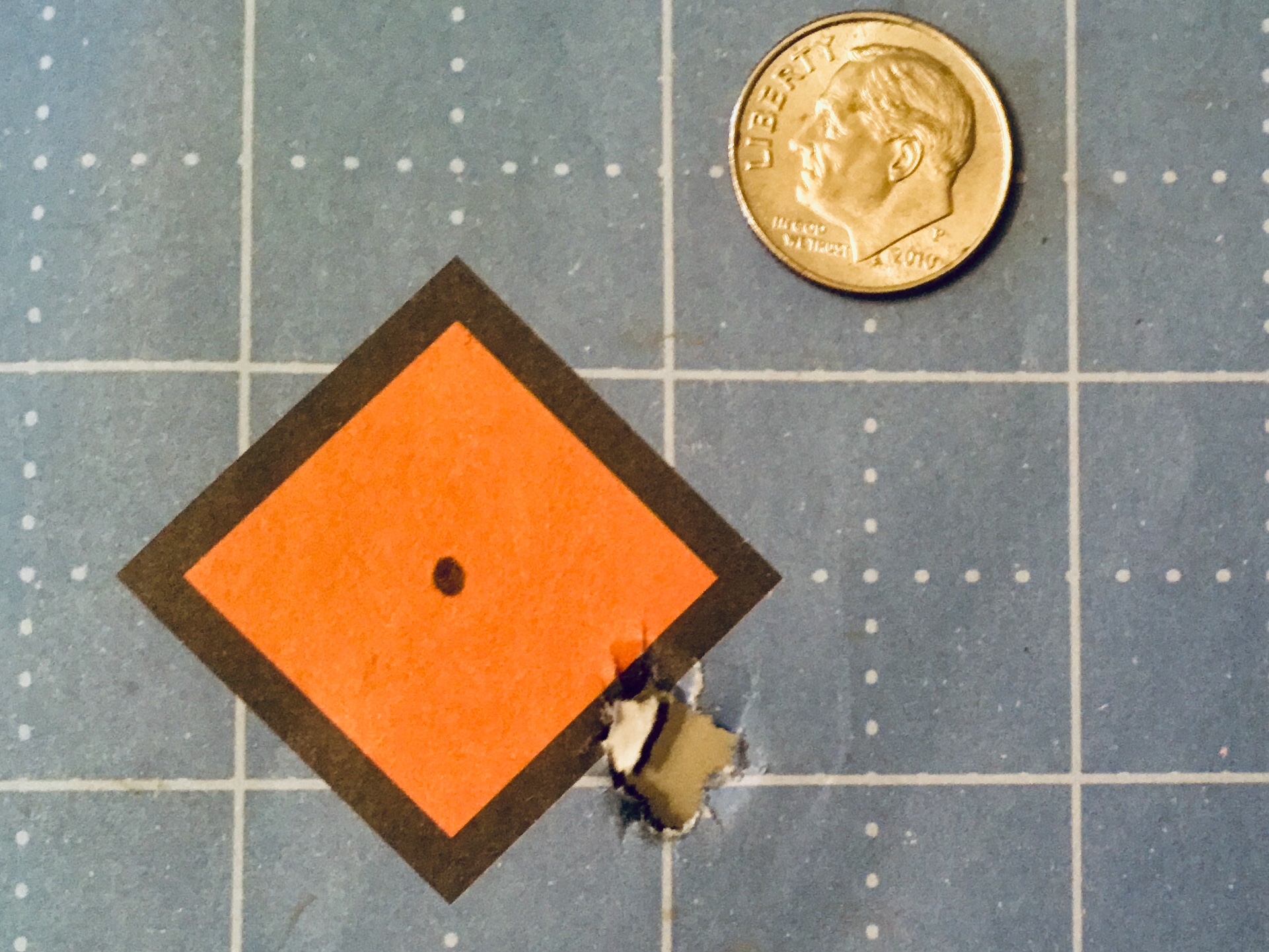

Shown above is a 5 round, 25 yard group shooting CCI SV. (For reference, the dot I was aiming at is about the size of a match head). I do not believe in 25 yard groups for proof of accuracy, but it still says something for a $180 rifle. Groups like this were easily repeatable. Once it warms up a bit more, I will shoot some 50 yard groups and feed it some higher quality ammo to see what it is truly capable of. If it deems a shooter, it may fall info my wife’s hands for an NRL22 rifle. Stay tuned for more groups.

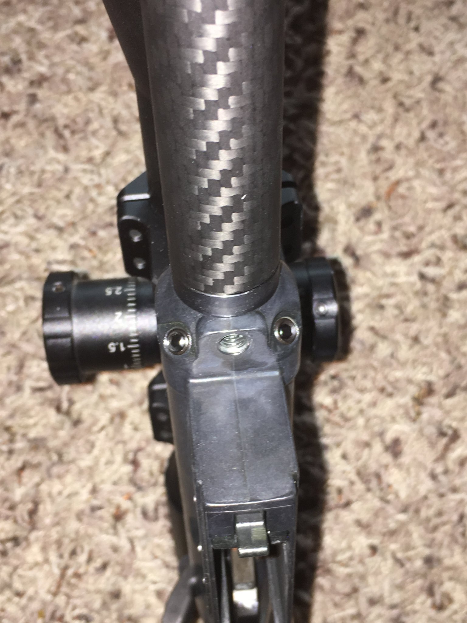

The barrel is retained by two screws like a CZ 455.

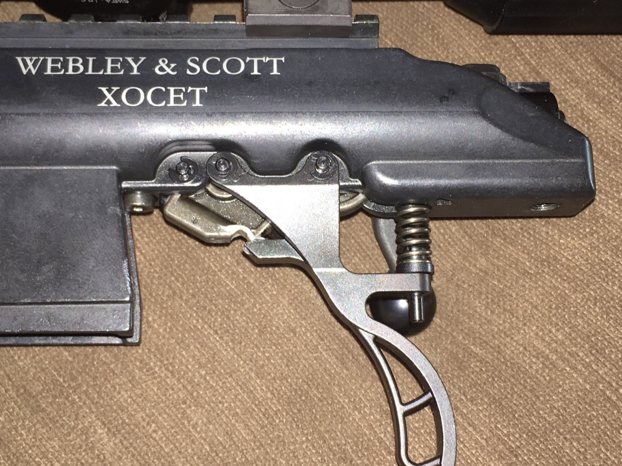

The trigger is adjustable but it is set at the lowest setting. It would be fairly easy to swap to a lighter spring though so that could definitely be an option to improve the trigger pull. If I find time tomorrow, I can post some pictures of the barrel screws and the trigger with the stock off.
Here are the pictures I mentioned taking. Barrel is held in by two screws similar to a CZ 455 and the trigger is adjustable but is currently at the lowest setting. That spring could be replaced though.
Update: I did replace the trigger spring with a spring (Item# 54009 - Ace Hardware) and it significantly lightened the trigger. Passes all safety tests. Cut the spring in half as it comes long and I’d estimate the trigger pull to be closer to 1.5-2lbs now.

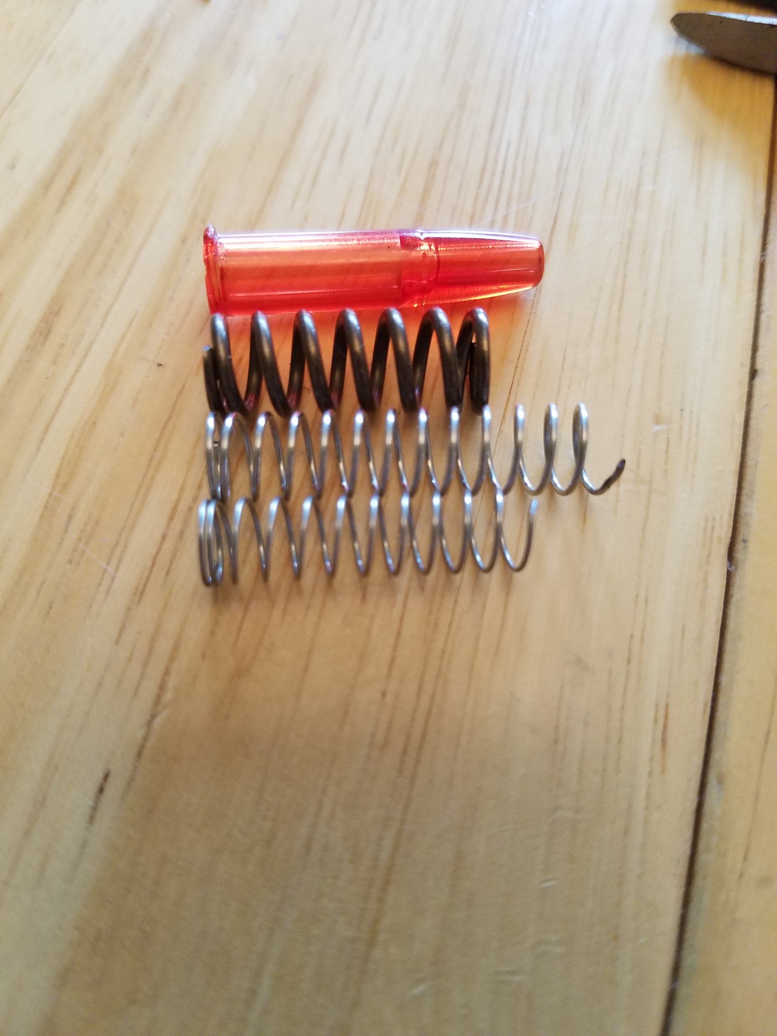

I just finished swapping the trigger spring and it is much mo betta. Stock at lowest setting is 6lbs. Swapped in a cut in half Hillman #3 (Ace #540009) spring and achieved 2.5lbs. Pretty good but wait for it...... a Hillman #9 (Ace #540027) spring cut in half yielded a consistent and drop safe 1.5lbs trigger pull. I'm liking it much more now. Only things I may do to it is add an over travel screw to the trigger. That and I am so, so tempted to cut that fake blade off the trigger but I'm afraid of f-cking it up with no chance of a replacement
Picture shows from top to bottom
- 22lr dummy round
- stock trigger spring
- #3 (Ace #540009)
- #9 (Ace #540027

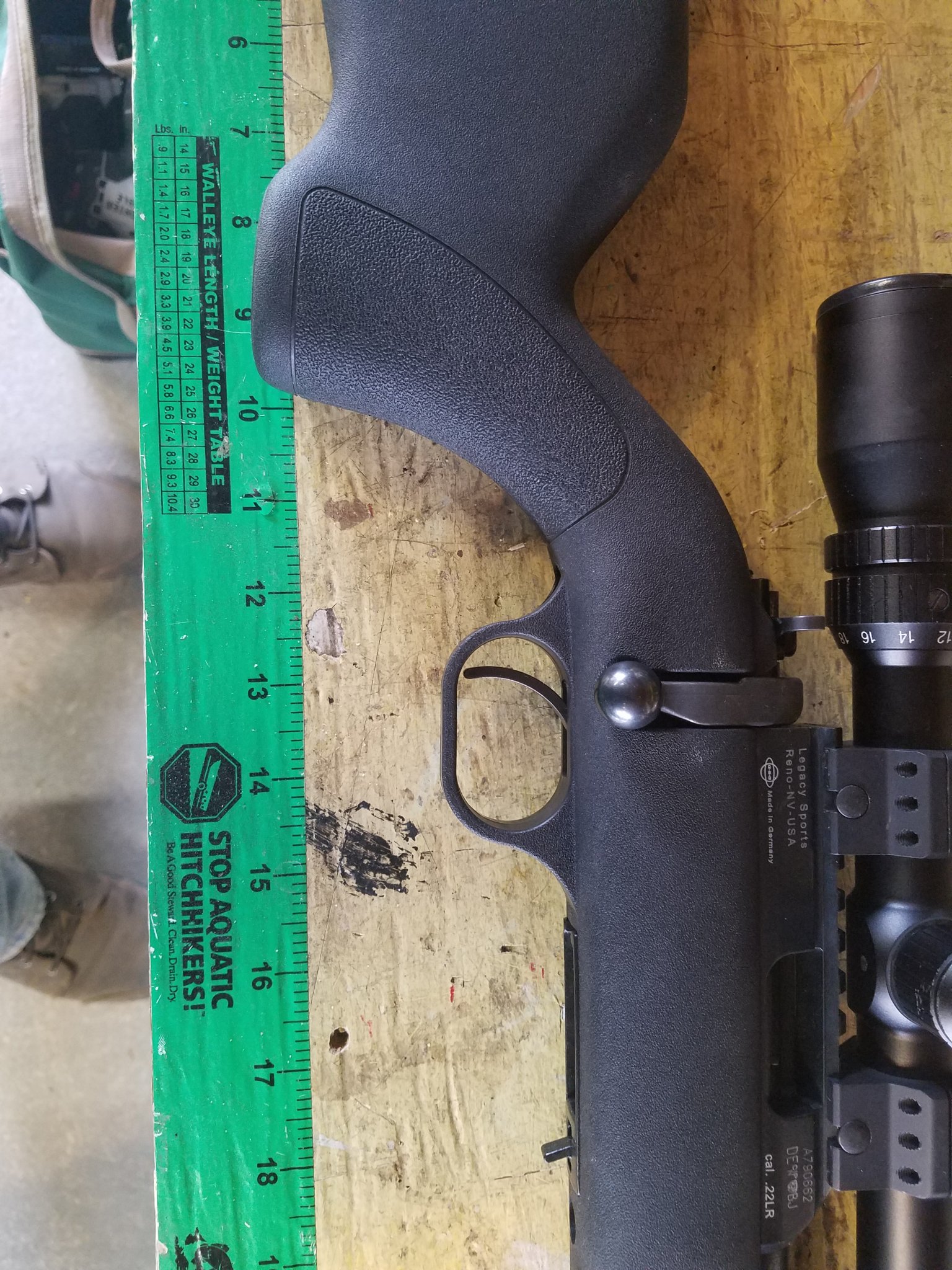

Well, I couldn't take that goofy trigger anymore. After watching my dad search for the trigger it got a trim. Super easy and well worth it.

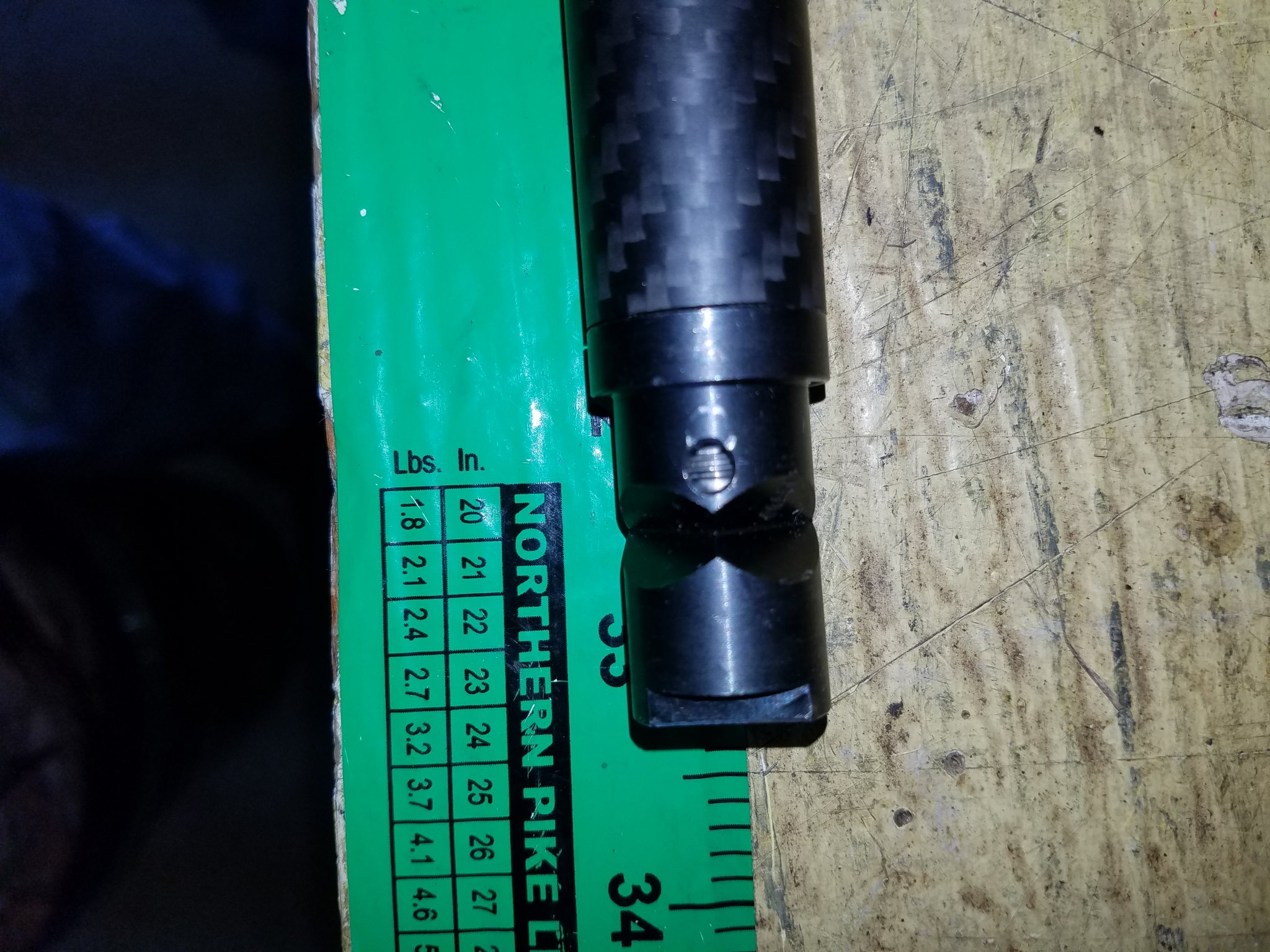

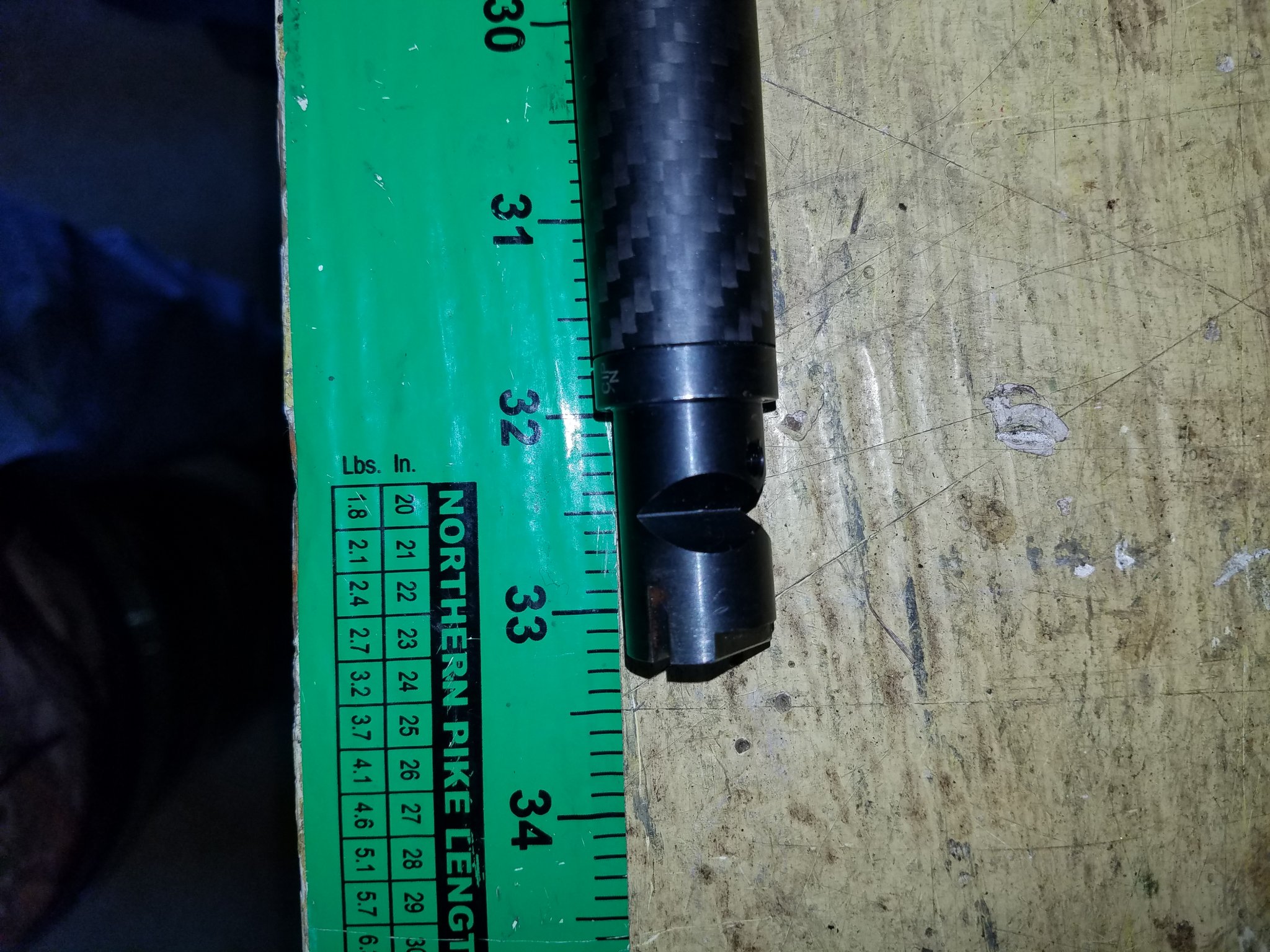

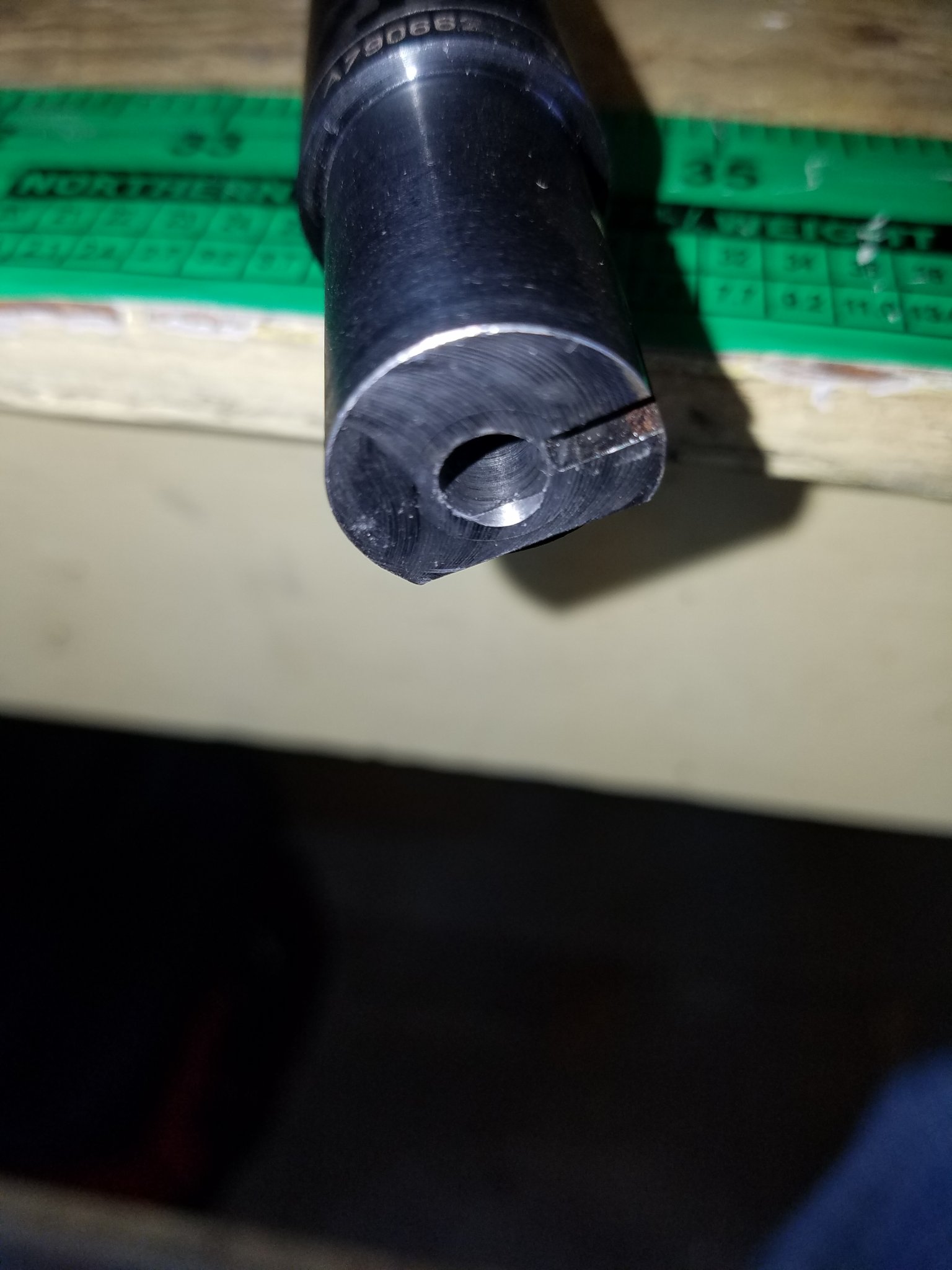

Barrel tenon is 18mm wide and 29mm long with a shelf cut for indexing on bottom. V cuts for set screws are at 16mm and are approximately 4mm deep. The chamber has a minute feed ramp also. I did not notice till now.
