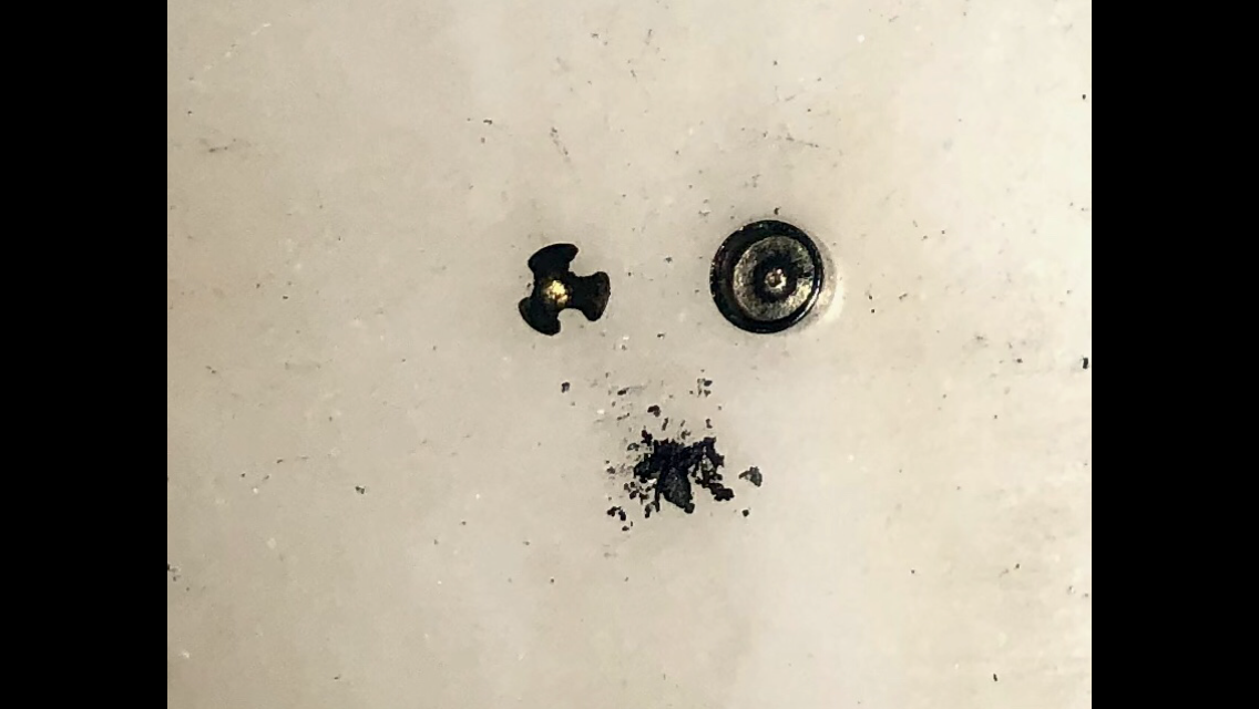

Yes: The combusted primer compound left in the primer cup is troublesome. Have to take the used primer apart and scrape the ash out. Otherwise the results are wildly inaccurate.
Short summary is that i cannot detect an improvement in SD, maybe 1 fps, but qualitatively, there might be a useful improvement in ES (Since ES is often 4-5x bigger it stands out more). Stats says the SD reduction result is inconclusive. If my SD was around 2-3 fps already i guess i would have seen it, but i get 6-9 fps most days. Anyway, if the effect (in your own unique situation) is not strong enough to jump out at you, how can it be of much practical benefit, so i have moved on to other issues/challenges.
Clearly I have other bigger problems that dominate my SD...
Picture below: Primer components. The ash has to come out before weighing the metal components and subtracting from the original unfired weight.

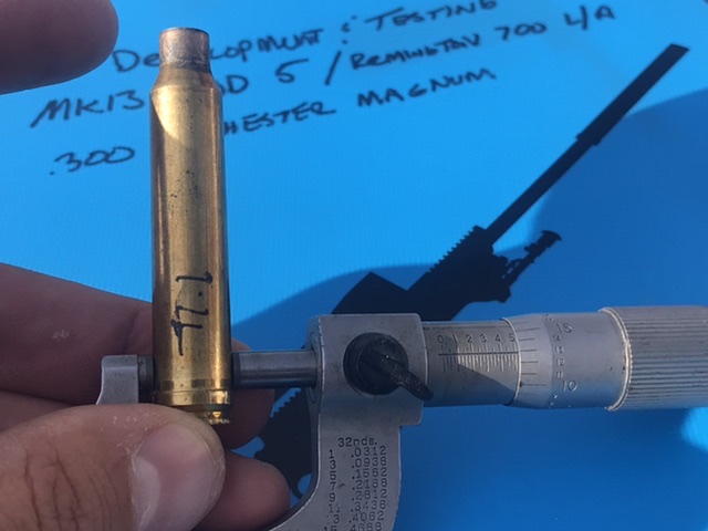

Also, do you measure the case diameter just above the extractor grove after sizing but before assembly/firing your test rounds?
Replies in your text below:
“Above groups look good. I’m assuming your 2.8 above is the base to ogive length?”
N: COAL, 6.5 CM has a shorter case.
“Have you tried Remington primers?“
N: Not yet, will give it a go!
“Not sure about their SRP counterparts but I often switch back and forth between F210M and Rem 9 1/2 once I have a single digit SD to see if I can drive it lower. The F210M is a little hotter than the Rem 9 1/2 (many of CCI primers are said to be “in between”.). I do this when loading for my .308s, 300WM and .338 Lapua. There is usually a clear difference between one or the other for whichever load I’m developing across all of those rifles.”
“Also, do you measure the case diameter just above the extractor groove after sizing but before assembly/firing your test rounds?”
N: No, can you explain the objective? I do check primer pocket diameter. Still tight.
“Also, do you measure the case diameter just above the extractor grove after sizing but before assembly/firing your test rounds?”
Ye I toss brass with loose pockets.
As far as that case measurement, I do it for two reasons:

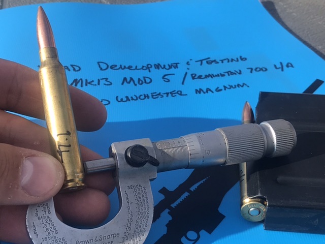

Reason 1
Detect variance in case diameter across sized cases before loading so I know every case has the same dimension
For example, my .300 wm cases are all .512 just above the belt after f/l sizing and belt sizing, for the most part. Cases not of this dimension are put in a separate bin based on their measured dimension. This simply eliminates one more potential area of variability and is easy and quick to do (I usually sit in front of the TV and measure 100-200 cases at a time) and throw them into a few different bins based on the different sub populations that arise. Generally, 80-90% of cases have the same dimension with the rest which I consider “deviants” and attempt to size them to dimension that matches the main population.
Reason 2
2) Determine when I’m at pressure. After firing each round in a test lot, I measure the case in the exact same area to see how much it expanded. Any expansion > .0015 tells me I’m at pressure. Beyond .0025-.003, I start to see visible pressure signs on the case head, primer, etc.
Here are some pics illustrating what I’m talking about
View attachment 7203950View attachment 7203951
In the above, the pre-fired case measured .512 (my mic shows a hair over but I was holding it with one hand and it slipped a bit)
The fired case below shows .513 or .001 expansion, which is fine. No visible pressure signs on the case head.
Reason 1
Reason 2
