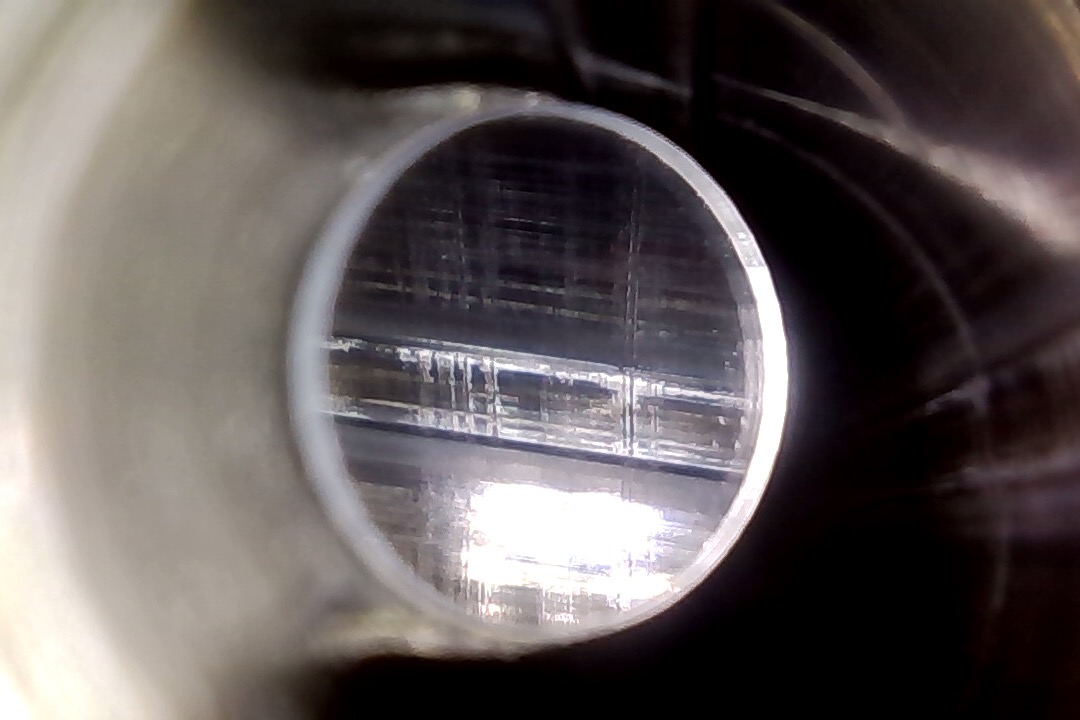

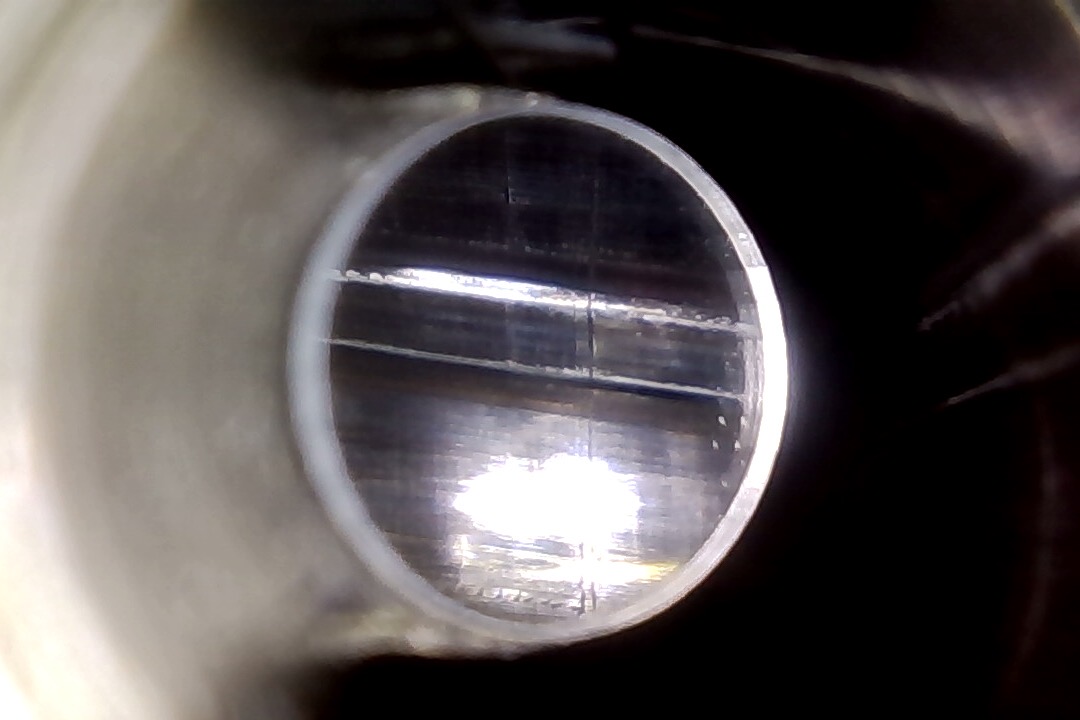

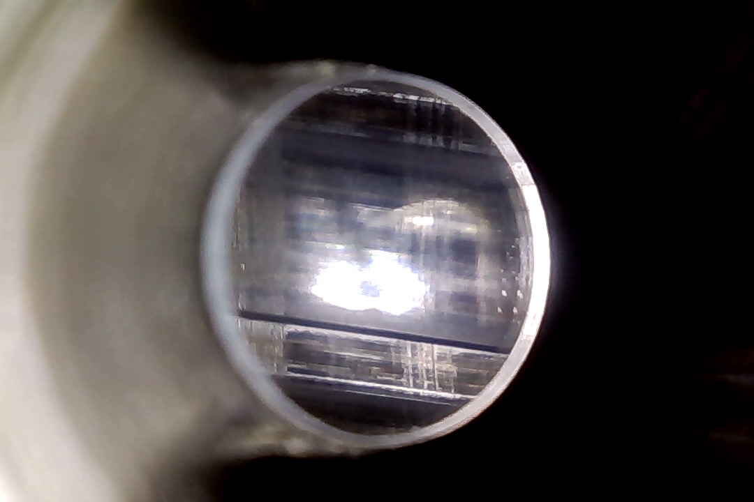

Check out the bore. These were taken before I shot it, when it was brand new.

Your bore isn't pretty but mine is no Bartlein either. Depending on the barrel I will Iosso it before ever firing. I mainly worked on the leade/throat. I don't waste my time doing this on a lapped barrel but did do it to my RAR. Like I said, mine was not pretty either but it didn't expect it to be a beauty (you probably didn't either). I probably have 500 rounds through it now and it doesn't foul any worse than any others.

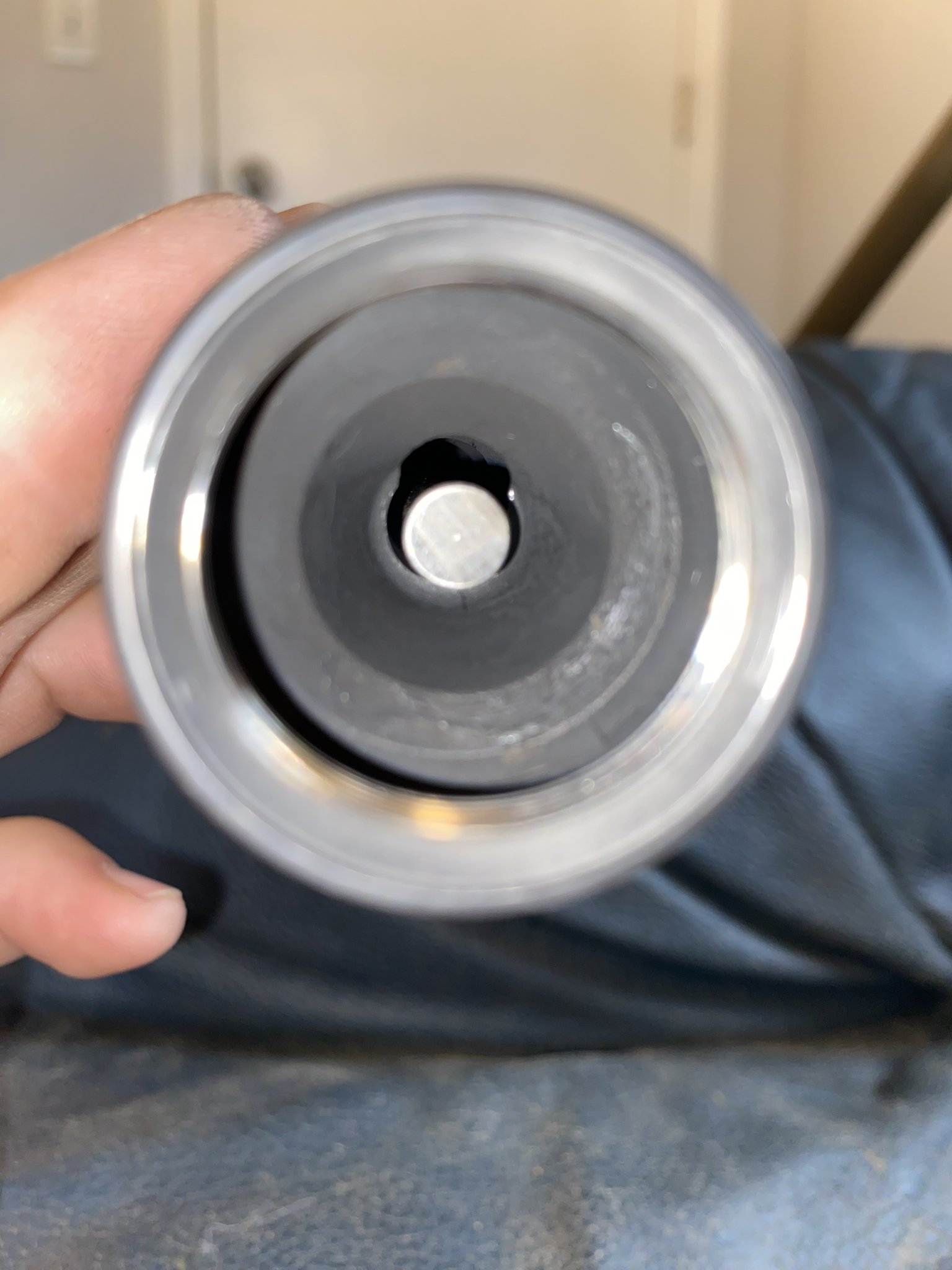

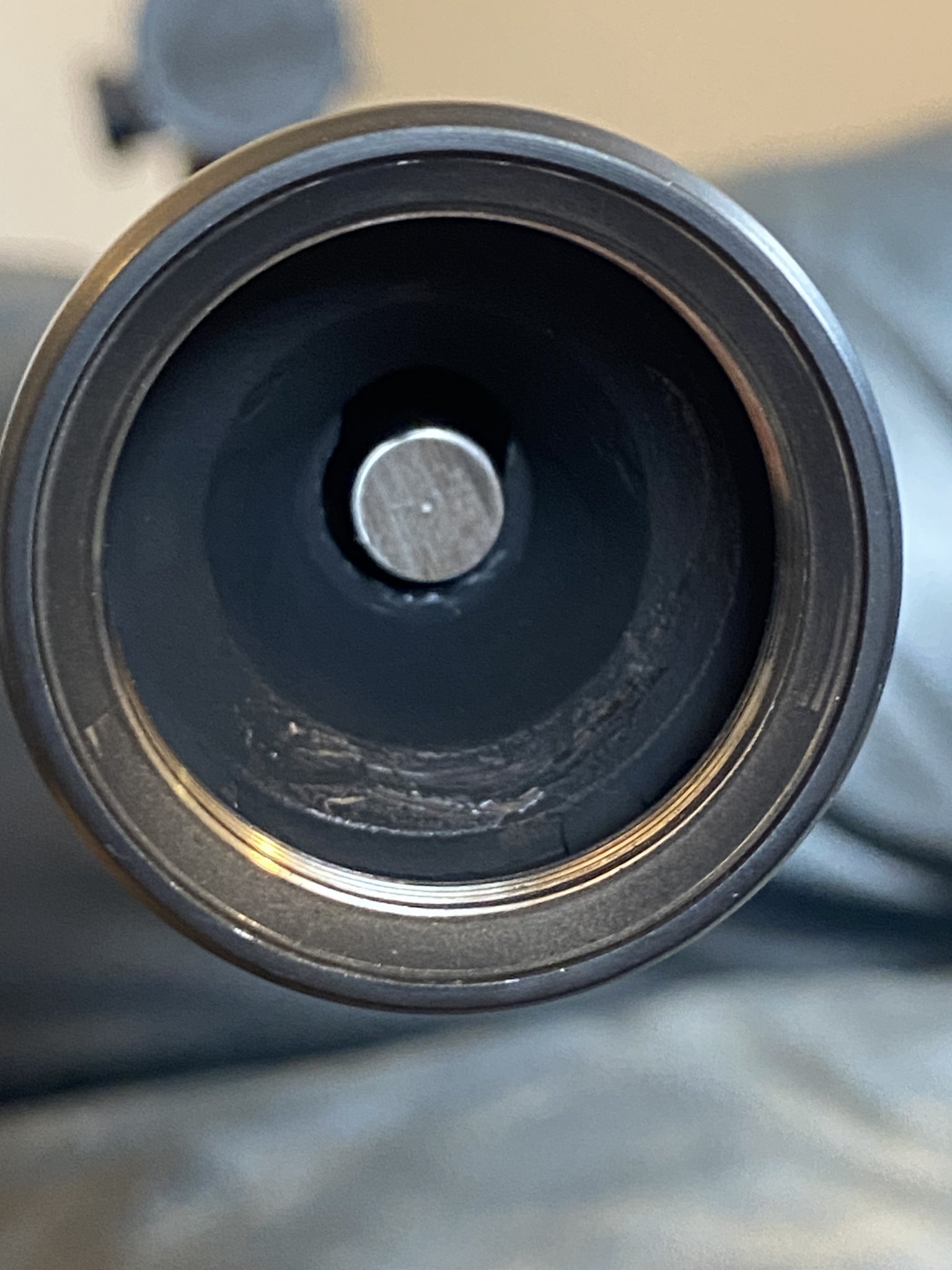

there are no baffle strikes on supressor. Like none at all.
And you confirmed this with a bore scope?
I ask because from the experience of a good friend of mine, a very, very light baffle strike is sometimes quite hard to see with the naked eye...or even an eye in a three piece suit (sorry, couldn't help myself).
And from these VERY light grazing strikes, he was getting impacts up to 5-7 feet from POA. 7"....might be the tiniest of strikes, no?
Glad you found it...in my friend's case, it resulted from a very minor amount of run out on an adapter he was using and a very, very minor amount of run out on the barrel shoulder. Added up to this grazing strike. Then we both bought alignment rods from
Griffin. Way cheaper than a suppressor. :cool:
Yea I took my borescope to it for a good 20 minutes. You could still be right though. If it is striking baffle it’s not much. I wish I could rent one of those rods somewhere lol Yours alignment rod doesnt happen to be in 30cal does it? 😂

You could try to sharpie a bullet. It's easy to see on target, perhaps it'll show up on the baffle.
Sorry, no. .264.
But they are worth the $65 or so for one.
Best of luck and thanks for the reply.

Just ordered the Geisselle alignment rod from optics planet.
