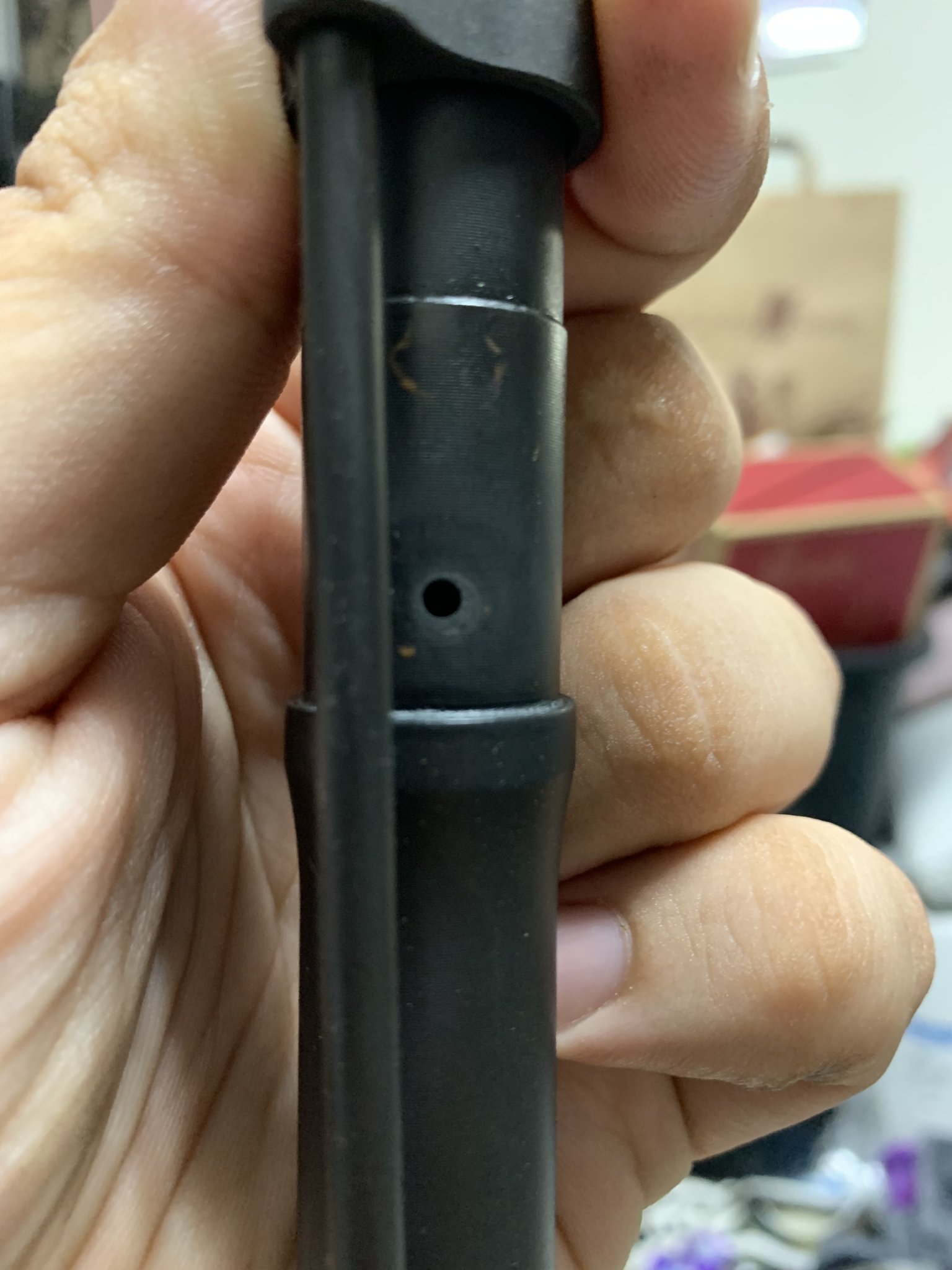

    So I looked at the gas port and it’s definitely not under sized, if anything it looks huge.
    That it is, now I’m wondering if it’s an over gas issue. I’ve only been shooting it indoors, so it’s hard to see what the actual ejection pattern and no one wants to be near me with this indoors.
    That hole might be your issue...that is giagantor of a hole...
    I would HIGHLY recommend superlative adjustable gas block...love that setup...it can also bleed off if you want...
    Should have checked that before I put it back together, but it’s easy enough to pull back apart. I might need to look into one of those, I’ll have to check brass next time I shoot to see if it’s trying to rip the rim off.

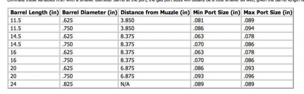

    The gas port is at least 50% larger than typical as indicted in the attached image. note this is a guide but I have found it be useful

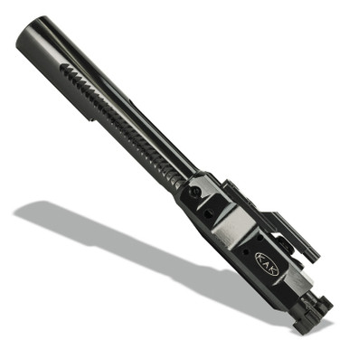

    I have a new lantac .308 BCG in the black DLC, if you're interested shoot me a PM
