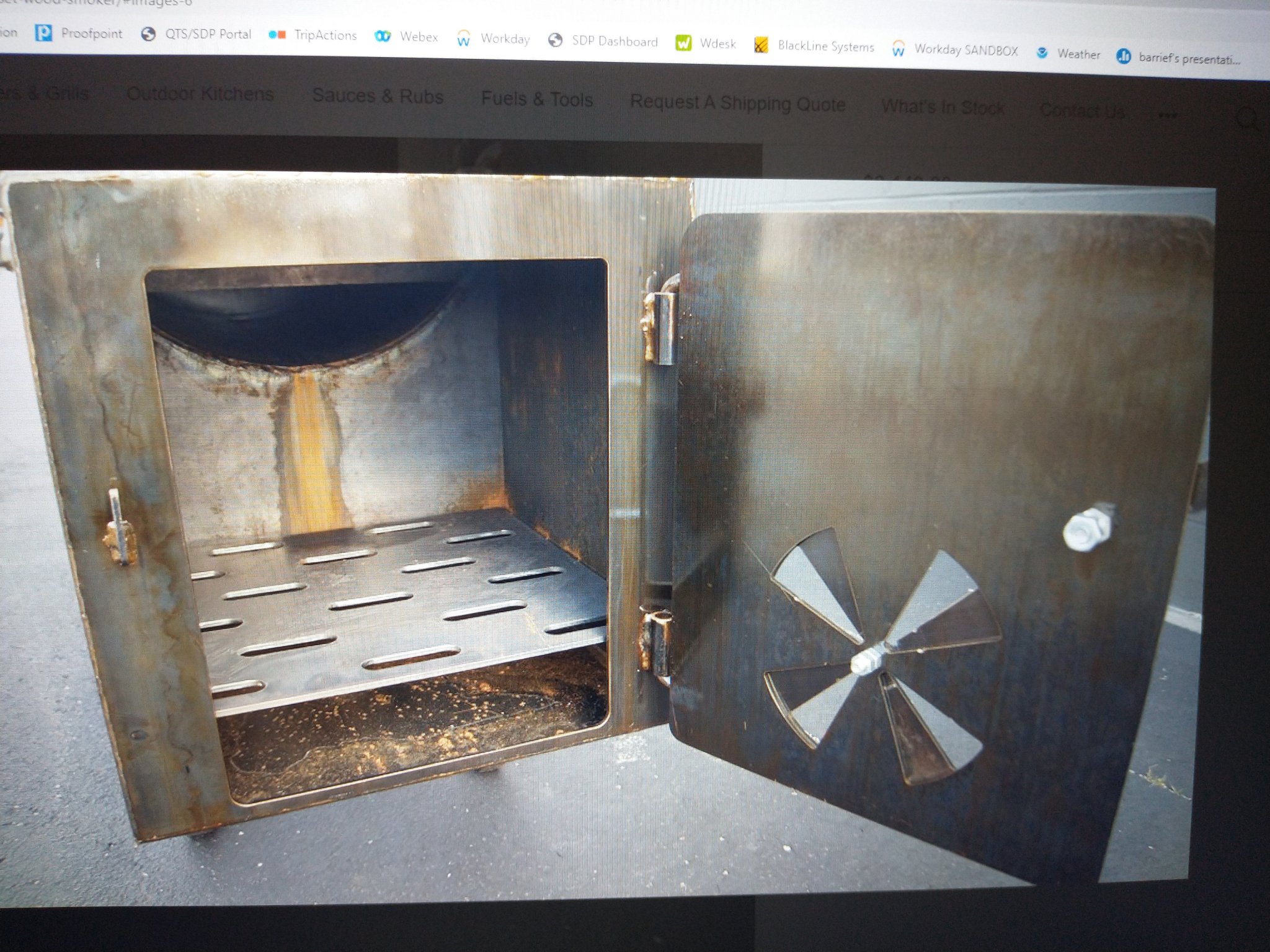

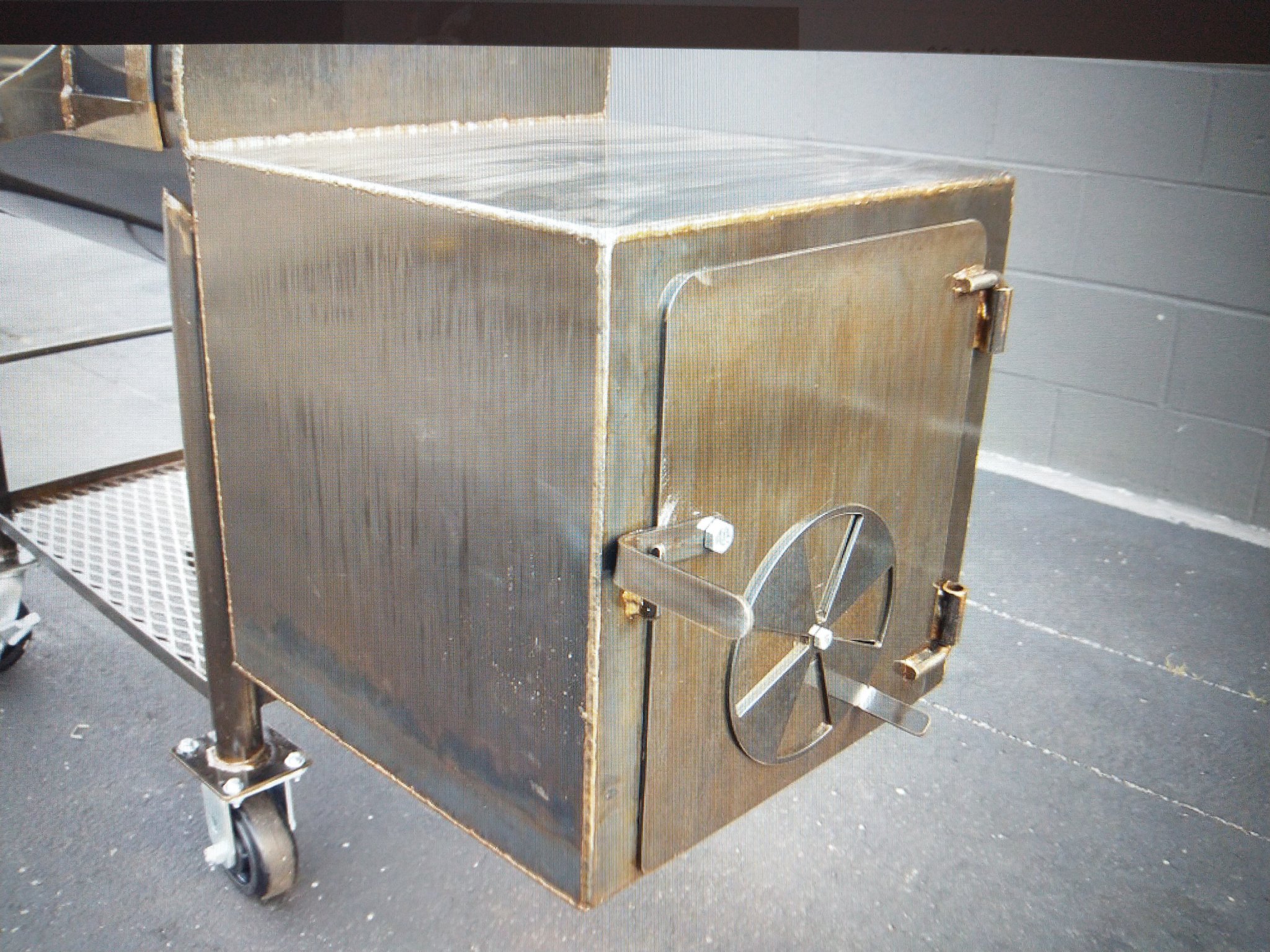

Wanting to replace the rusted out firebox on a Brinkmann offset barrel smoker. Cooking chamber is still in really good shape.
Put out an ad on Facebook looking for local welders/fabricators and had one guy reach out to me.
I asked for something similar to the below, maybe in the 18x18x18 or 20x20 range and was quoted "somewhere between $250-300." No specifics discussed on steel gauge etc yet.
That smoker wasn't much over $600 10 years ago so I balk at that figure a little, but if that's reasonable, and dropping that much now can keep me running for another 5 years or more, I'd probably say that's good enough.

Price of steel is 3-4x what it was 3 years ago. If you go stainless that’s going to add to the cost. $250-$300 was probably just labor to do it. For stainless .1 it’s going to be 4-500$ for material. Is the picture of the one you want to replace? Doesn’t look like it’s rusted through.
It's a sample pic of what I'm wanting.
Appreciate all the replies so far!
It *looks* like it's stainless and I'm not seeing any issue areas.
Maybe post a pic of the bad spots ?
My bad, thought that was the actual smoker in question.
