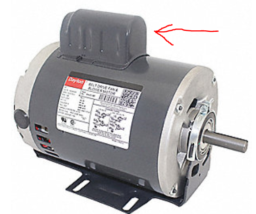

If the pump has a capacitor, there is usually a hump on the motor, like this:

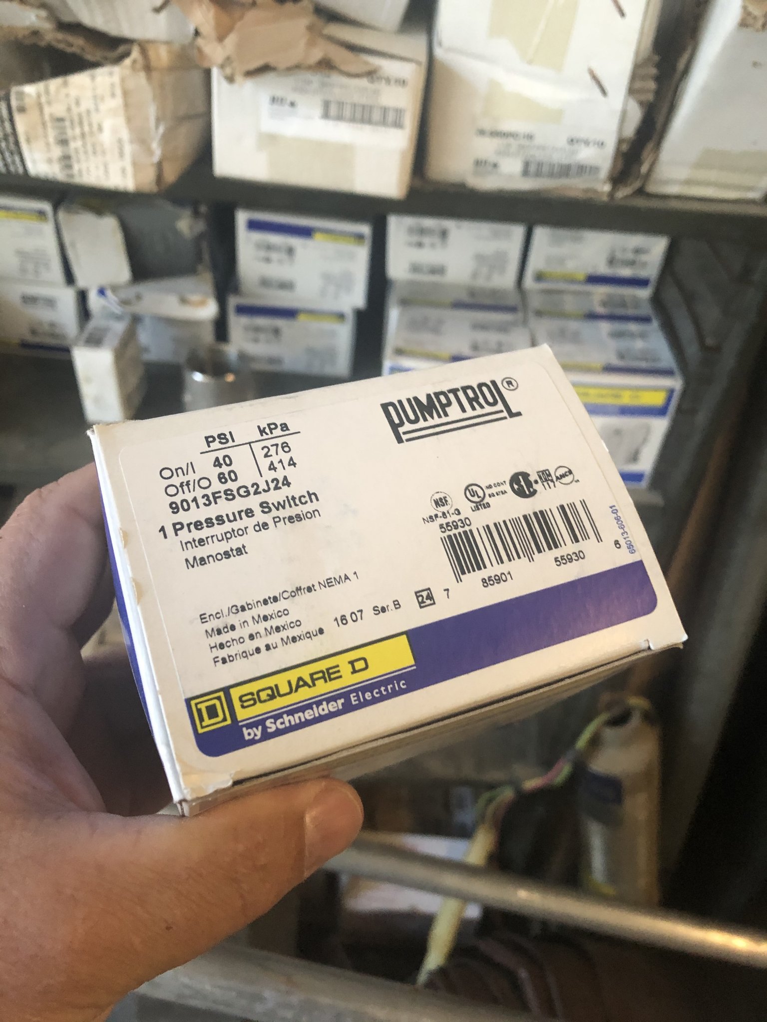

No, it won’t fix the issue, but you’ll be replacing it again I’m betting. This is a 40-60, but you could adjust it down to 30-50 or see if there’s a similar part number.
Reactions: Olen_4504

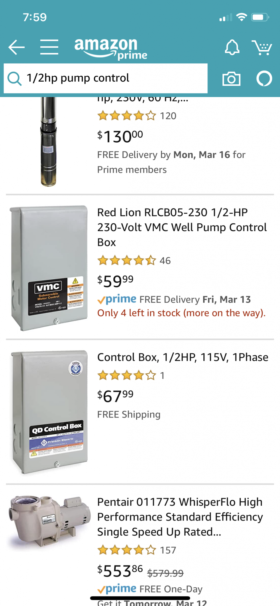

Is there a “pump panel”? It will have your start/run capacitors and relay all built in. I think a 1/2 hp can operate without one, but longevity of the system would improve with one. Just throwin ideas
Be sure to get the correct voltage if you add one in your setup
