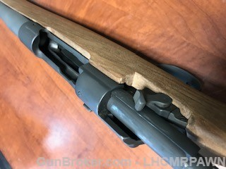

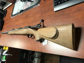

As I was helping Son of Darth out with his African rifle build and ran across this little unfinished gem... At $600 plus change, I doubt I could have barreled the action for that.
It's on what I think is a Brazilian ERA Mauser 98-style action. That is what it was sold as. But I can't find out much about those actions... whether they were made with hacksaws and toes like in Darra? Or whether they are creditable.
But I could not even barrel it with the McGowan barrel for what I paid for the whole project.
Of course, the fun begins with loading for it... 5.99 each for brass. $400 for a die set. Punishing recoil. And there aren't any Tyrannasaurs up here to shoot with it. But the journey will be the reward.

Not a Brazilian Mauser. Three possibilities here ...1) A Honduran Model of 1934 contract rifle with the receiver ring and bridge milled down...they were manufactured by Remington. They were manufactured from nickel steel and are fine from a materials standpoint. 2) Remington Model 30 sporter action...same comments as above. 3) M1917 or Pattern ‘14...could be done but far more work to get it to sporter configuration.
Thanks, DanM. Another possibility is ERA, a Brazilian make of fairly cheap modern guns... Possible they made 98 modern clone actions.
I can't find anything about it... the listing said ERA Model 98 action.
All I get from Google is a bunch of random crap. Including a mess about feminists and their Constitutional crap-out!
So any info you might scare up would be massively helpful!

The Pattern ‘14/Model of 1917 safety is the give away. Brazil did make domestic ‘98 pattern mauser rifles and they also purchased contract mauser rifles from DWM and Mauser Oberndorf...the rear of the receiver ring at the ejection port is straight. The receiver at the ejection port is curved...that is a Pattern ‘14/M1917/Rem 30/Honduran 1934 feature.
If I had to bet the ranch, I would say the information provided by the seller is incorrect. ERA was the code for the Eddystone Plant of Remington Arms. It could be an ERA Pattern ‘14 receiver or someone assumed it is an ERA receiver.
@Dan M https://www.gunbroker.com/item/825072438 Here was the original listing (more pics). Looking at it, here's what I figure. If it was a straight clone of the Mauser 98, why have the Enfield-style safety on it? It's definitely an Enfield-type receiver and safety, the trigger guard looks like the military P14/M1917 ones and not the Remington 30 that I've seen, and if ERA was the Eddystone plant, then I'd say this is a sporterized M1917. Except for one problem: The Eddystone sporters I just looked at, none of them just have ERA and a serial # on them in that same location. Wasn't an exhaustive search, of course, but they all have the full rollmark and not just "ERA"
Well that is making me feel better!! Because the Brazilian maker ERA is a maker of kind of POS stuff. If it's a sporterized military, whether Rem, Eddystone, etc... is very, very good news!
I honestly don't know the details of the Mausers like you guys do. So this is excellent feedback. Thanks, too, Dorn!

A M1917 is marked Eddystone...a Pattern ‘14 is ONLY marked ERA. i have two in original as issued
condition, one in the 6000 range and the other in the 10,000 range.

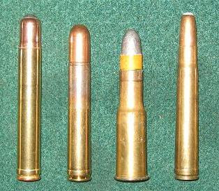

A 'technical' question for you guys, is whether to fit a recoil lug through the stock. They not only do the Mauser-style recoil-lugs look good... but I think with the energy generated by the .470... even with bedding, the stock should probably have every bit of support it can get!
BTW, to put the Capstick into perspective... the .458 puts a 500gr slug out at 2000 fps. The Capstick is 300 fps Higher... it is beyond cannon!
.470 Capstick, .458 WinMag. .577/.450 Martini and .375 H&H Mag.

Dropped the Capstick off at NECG yesterday!
Went over it with gunsmith and first need to solve an action problem, which is that it dropped firing pin once (on empty chamber, of course) while taking safety off.
And bolt handle needs bending or sculpting.
After that, we will likely fiberglass bed and then do a stock fitting for length and final shaping. Figure out a checkering pattern. And metal finish.
It has grey park on it now and I like it. But bolt handle change will mess that up. And striping parkerizing for bluing is stupid expensive. So debating that now.
Well, I have 6 months before they even look at it to decide... see you on this thread around, say, March!
Cheers, Sirhr
Well, it is almost March... 2021. And they are moving forward with it!
Yay!
Going to be a fun build. They are re-shaping the stock to somewhat of a Rigby style now. Going to be an oil finish.
More to follow.... But things are moving forward!
