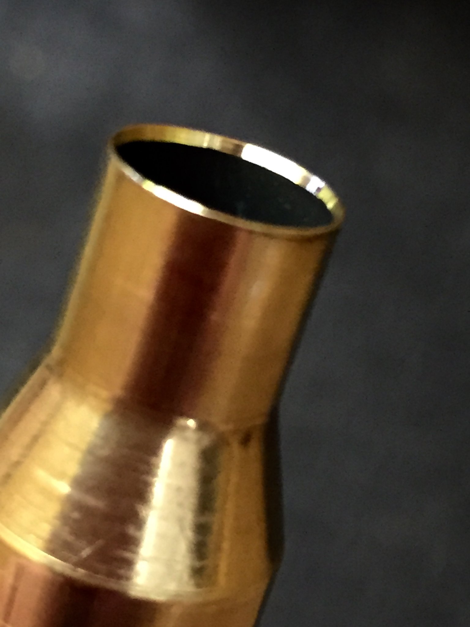

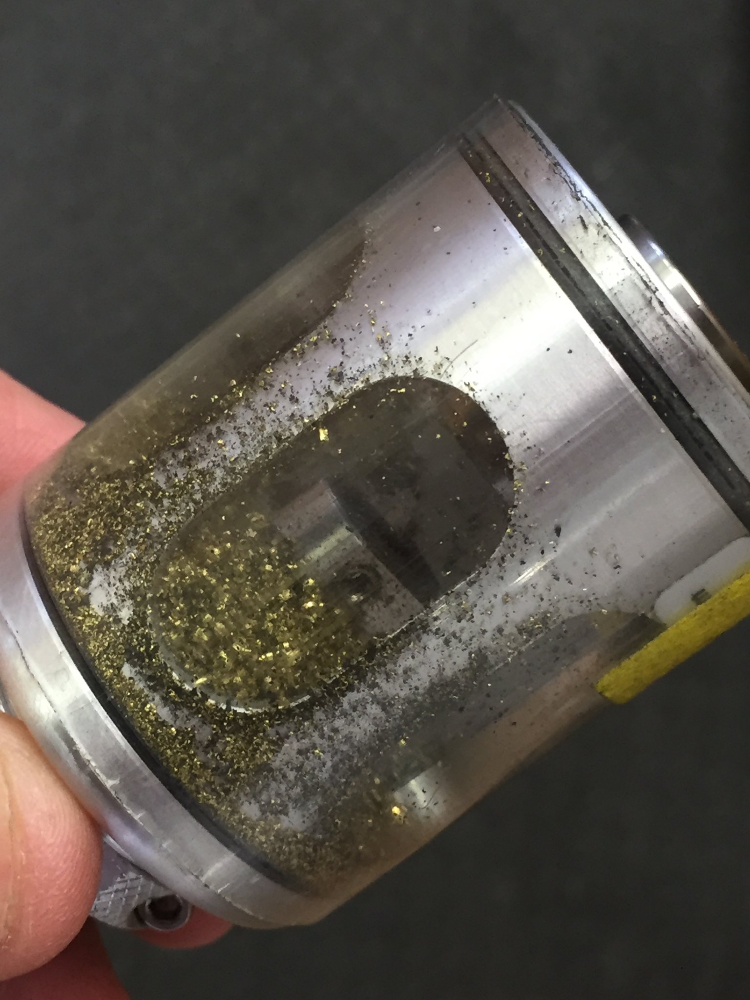

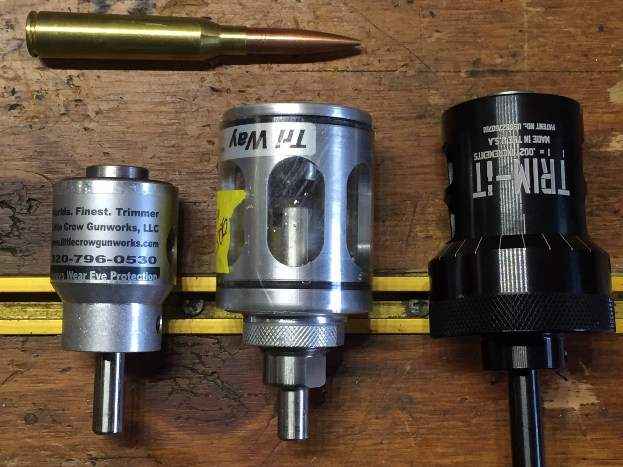

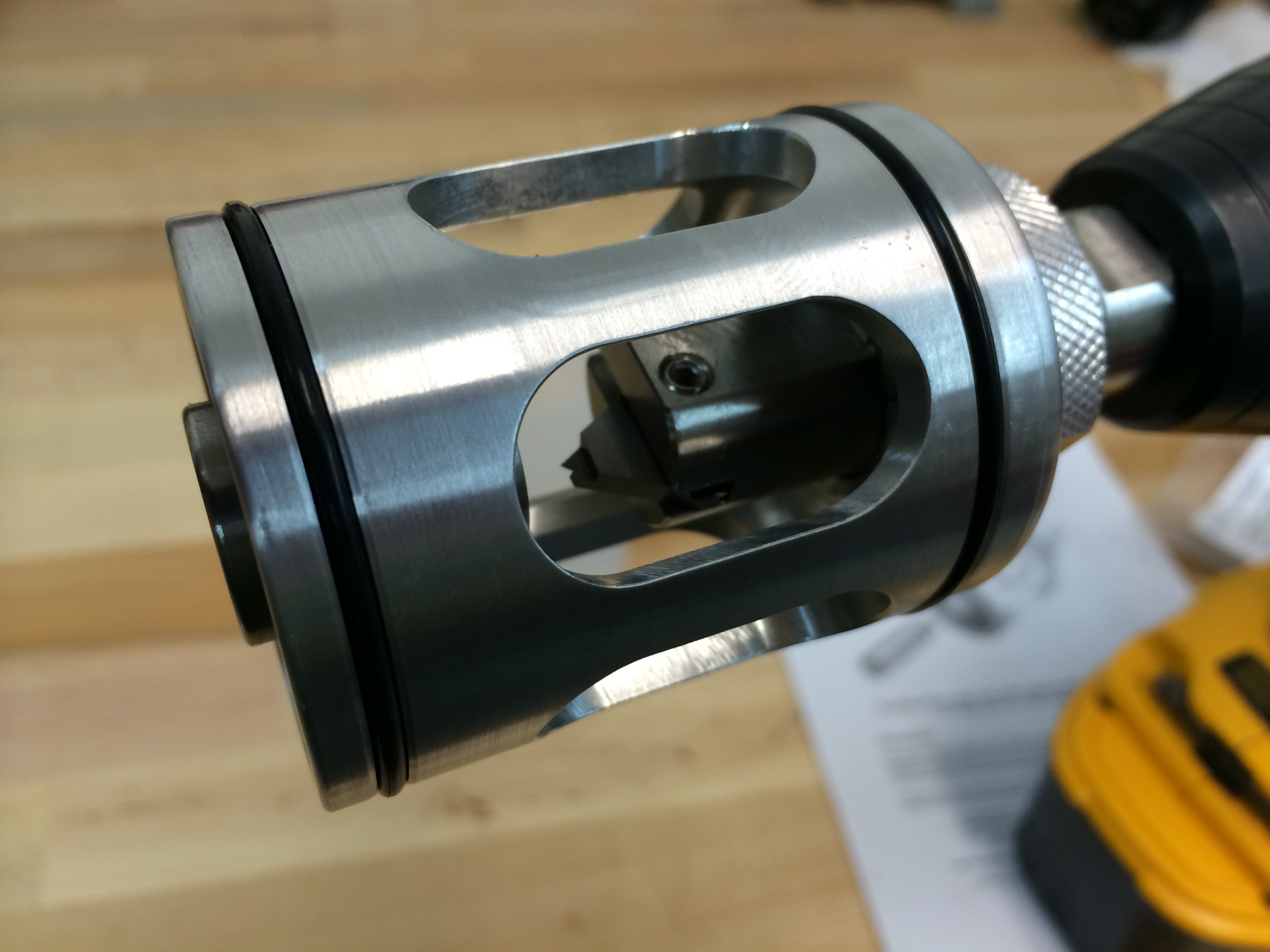

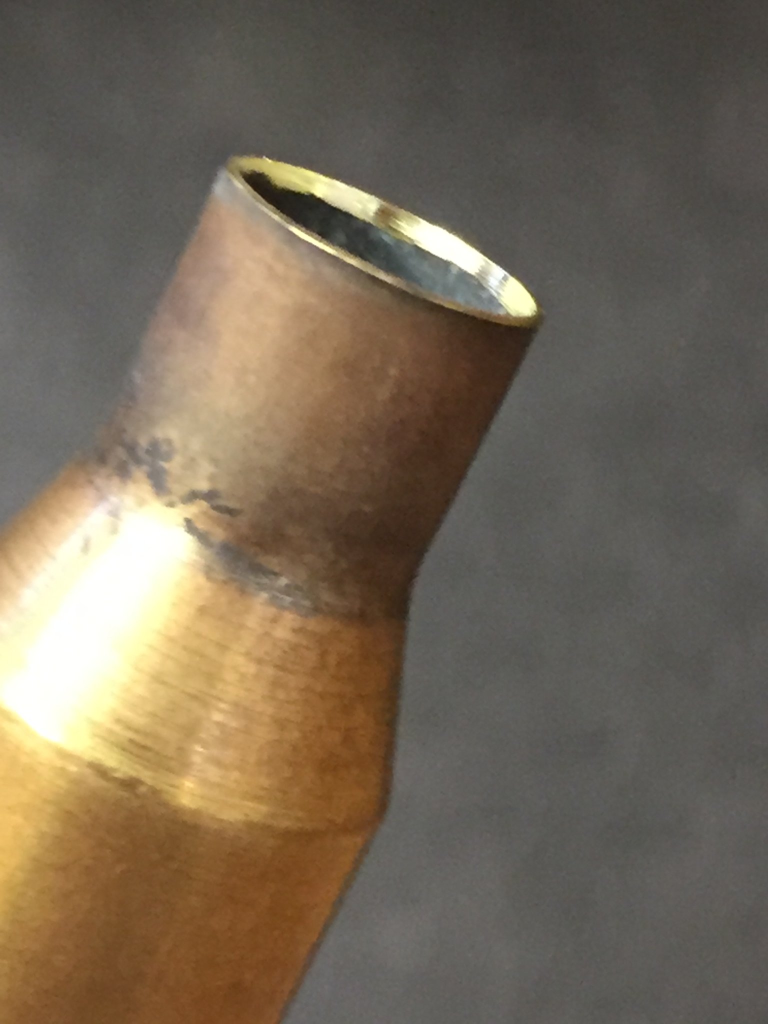

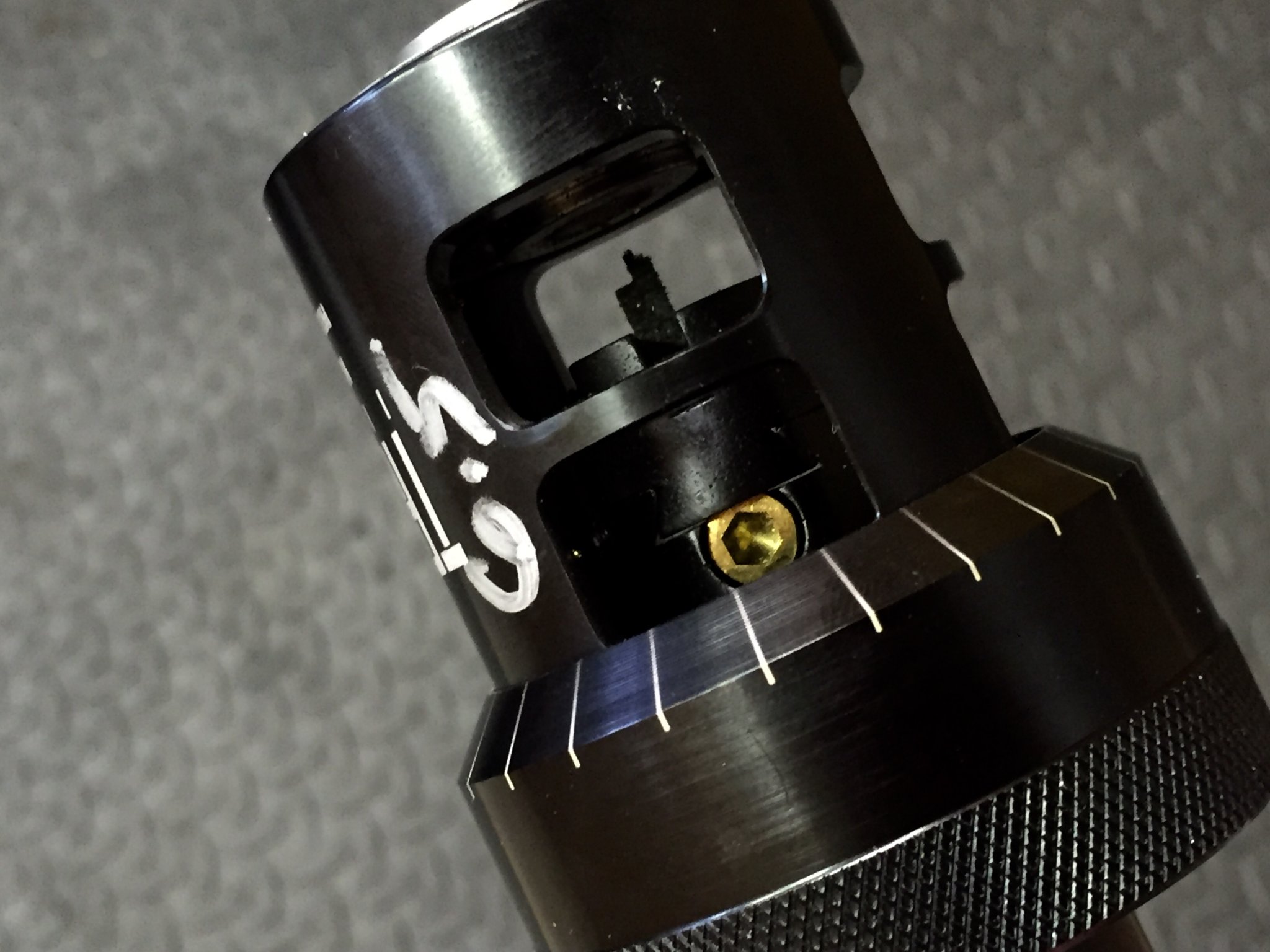

I have all three in redundant calibers. Here are some images I did a review on them somewhere in the hide a while back. Cases shown are 338.
The Trim-it is by far the fastened to set-up and I get the best results. The image below it, is the brass trimmed by it, nice ready to load brass.
The Gir. keeps all super clean and does chamfer both sides but is hard to set up and limited on the ratio. Below it the brass from it.
The WTF is not even on the same league

you like the trm it out of all 3 ? thank you for the pics.

In fairness I have not tried any of these on a 223. But all of them on many other case sizes. The WTF is the easiest. It is a simple trim. The others are far more complex operation.
If you try to cut to much they all will grab and spin out of your hand.
I also have a Wilson Micrometer and K&M chamfer, but these Benchrest tools are not fast.
My input is NOT to compare one of these to other hand tools, only each other.
