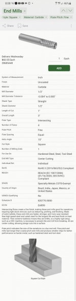

The HS steel end mill on my WFT2 is starting to chatter. It's just a standard 1/2" end mill, right?
Would a carbide fine-finish end mill like this one be a good replacement?

A carbide endmill (EM) replacement may last longer than a HSS EM. If the OP wants to go that route, I’d find a cheaper carbide EM than what was posted. Reason being, the finishing EM that the OP attached has fancy cutting flutes that may show benefit in a cutting application where the flutes are actually used to side-mill a workpiece…but only the bottom cutting edges are used to trim a case neck…a more expensive ‘finishing’ endmill is a waste of money, IMO.
It seems to me, something like this (https://www.mscdirect.com/product/details/88246152) would yield similar results as the EM that the OP found…at half the price.

I saw this link for the replacement cutters after posting my previous comment… @Agent Entropy if it were me, I’d go this route for a replacement cutter…another, cheap HSS endmill.
ETA: but, if you really want to go the carbide route, see my other reply.

Yep, I agree that an unfavorable RPM will contribute to chatter. I also agree that in general, brass should not chip HSS too easily.

3-4k pieces...that seems like a decent bang-for-the-buck to just get another HSS replacement like @supercorndogs suggested.
It’s got me wondering how much longer a carbide endmill would really last over a HSS replacement. I say this because trimming brass sucks! I don’t know anyone who looks forward to wasting their time trimming. As such, most people that I’ve seen trim brass just shove cases in and out of the trimmer as fast as possible, so they can be done trimming as fast as possible.
Trimming this way…with impact-after-impact of case necks slamming into the cutting edges…may not yield a big-enough improvement in tool-wear using carbide, to justify the 2x-3x cost over HSS. You could buy 3 HSS replacements for the price of that 1 carbide cutter that I linked to. Would one carbide cutter trim 9-12k pieces with your setup, if all else was equal in the process? Let us know, if you try it :)
