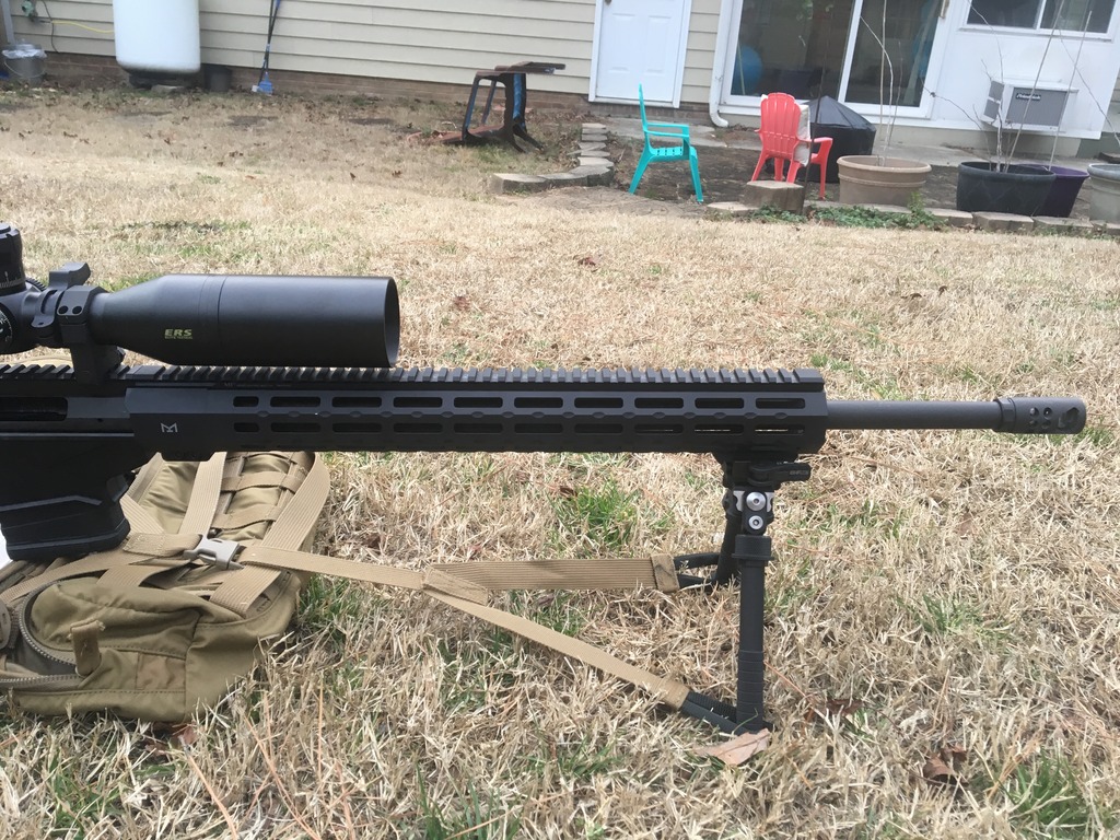

You should look into the 18”one from Midwest industries. I have it on an RPR here:

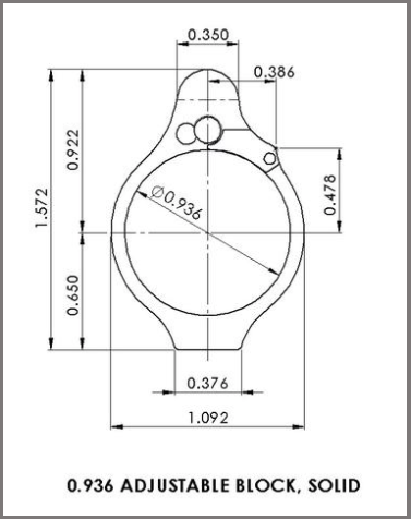

I've never seen a free float handguard that looked so tight I would worry about fitting a 0.936" gas block in it unless it's some huge aluminum clamp on thing.
A micro gas block like in the drawing should fit fine, it's only about 0.080" bigger on each side.

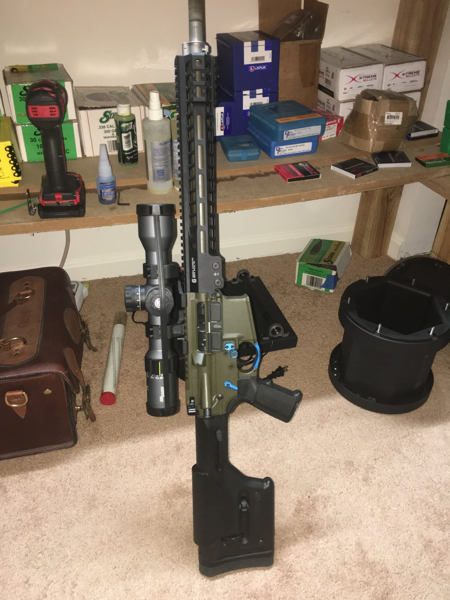

I started a 6.5CM gasser build about 2 months ago. I went with the ZEV AR10 upper/lower with their matching 16.6" wedge lock rail. The quality of the receiver set/rail is top notch. I initially went with a JP adjustable gas block but that didn't workout because the adjustment is on the side and the rail blocked the key hole for the adjustment. I picked up a SLR adjustable gas block and it fits perfectly. Below is a mock up pic prior to installing SLR (still waiting on my precision armament accu-washers:
Reactions: demolitionman
Nice rifle
This is what I was referring to and options like the SLR can remedy it by having access on front.

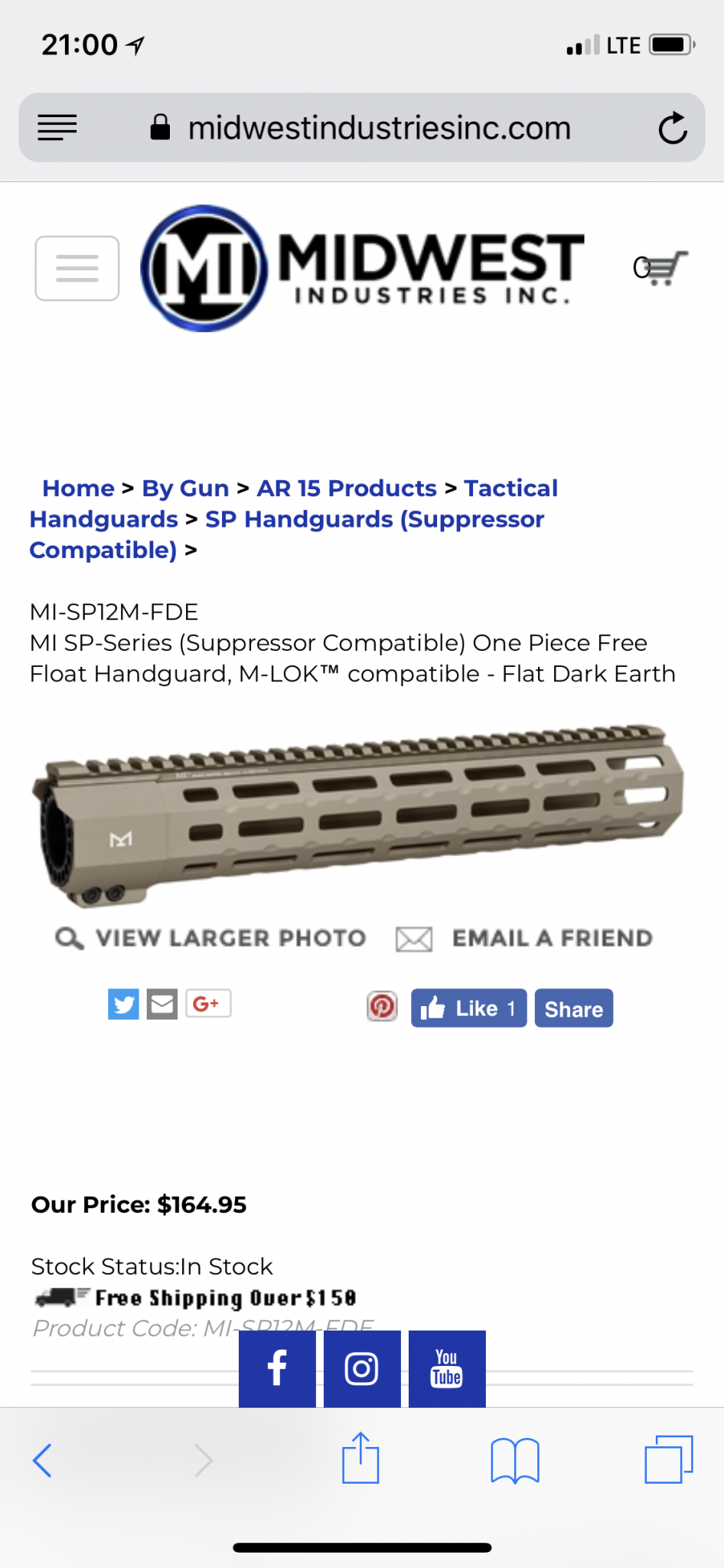

I went with the Midwest Industries SP series 15" length handguard. Should be an absolute no brainer for whatever combination bull barrel + .936 gas block I go with, adjustables included. Thanks for the tip on those. Looks like Aero has a suppressor style one as well but I couldn't find it in stock.
