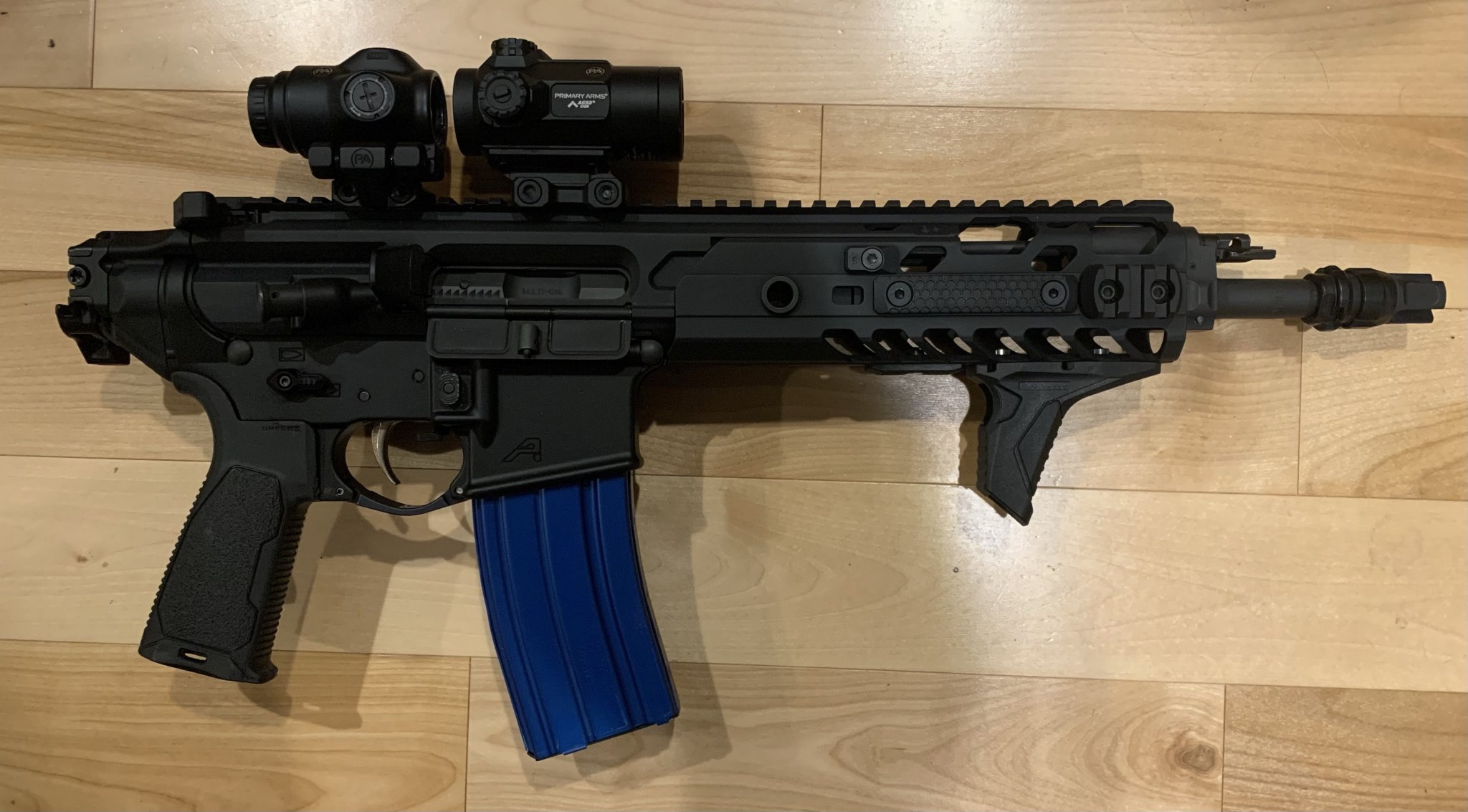

Pic of my own 11.5" using the 8" handguard (though you can also get the SD handguard and tuck the suppressor, which is nice)
Mine's built on an AR lower, but the actual sig lower ends up being about the same. The blue mag was purely to annoy a friend of mine.
