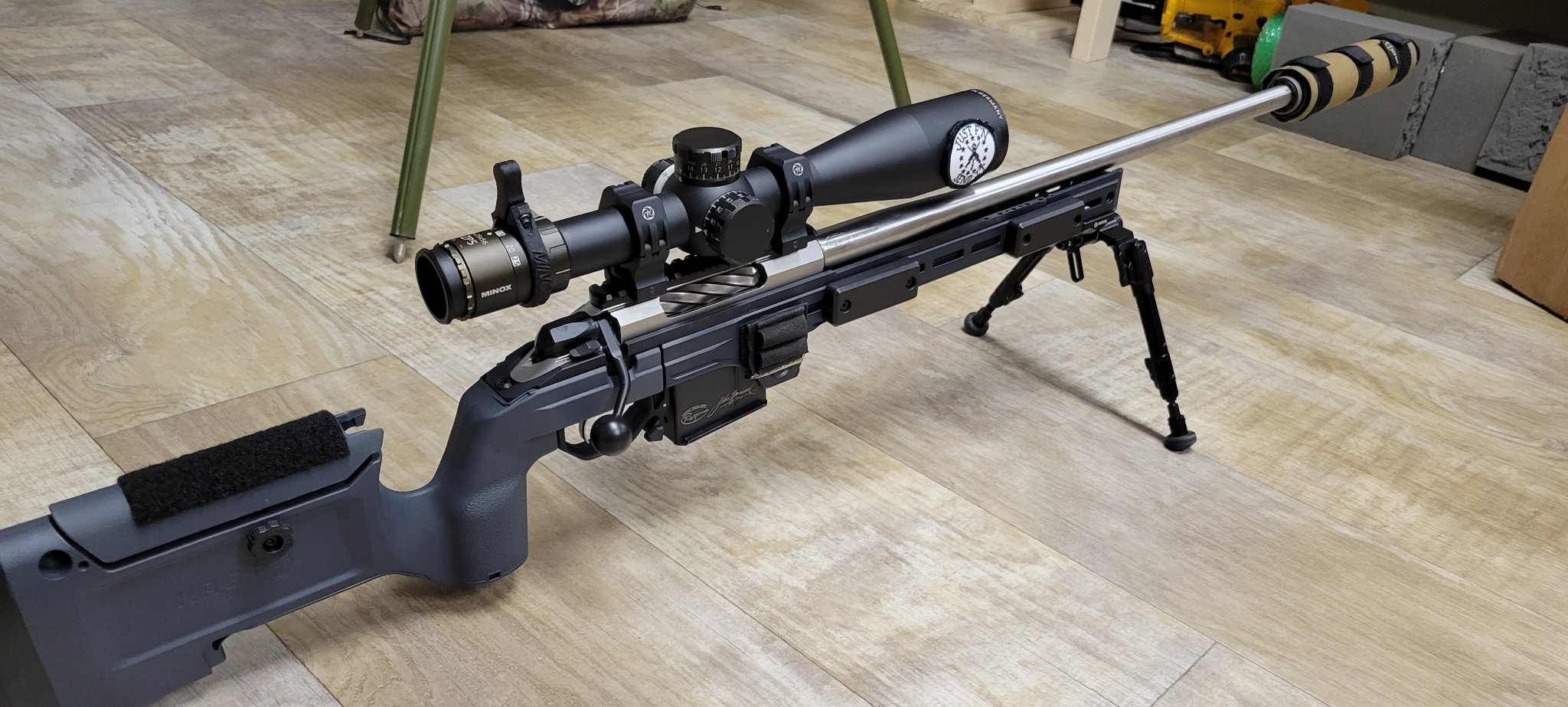

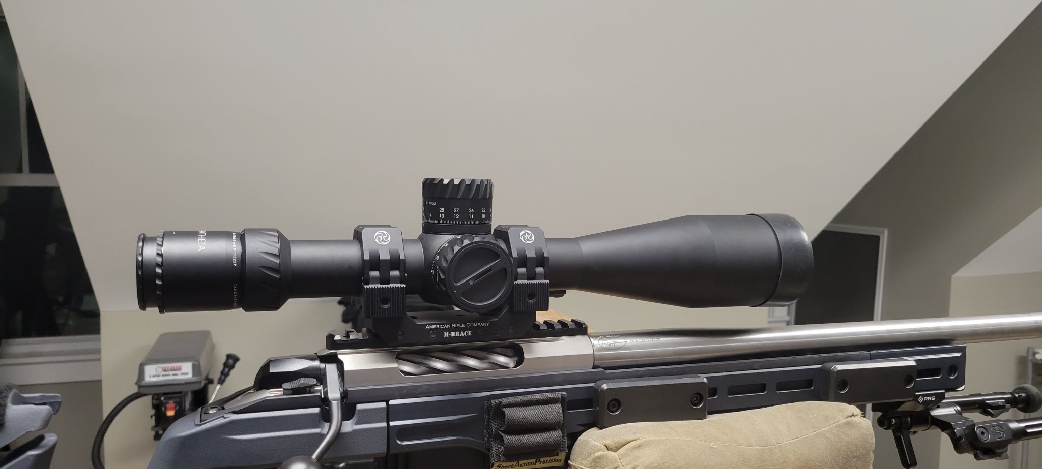

Shot new school vs old school today.
1. Tikka 6.5 Max, Vision Chassis, clipped lightened trigger spring, Bartlein 28 Med Palma, Ckyepod.
2. 700 full blueprint and fluted bolt by LRI in 300 RUM, A5 Sniper fill w/ cheek riser, Jewel BR, Krieger 28 MTU, LRA bipod.
Love them both, but old school FTW.

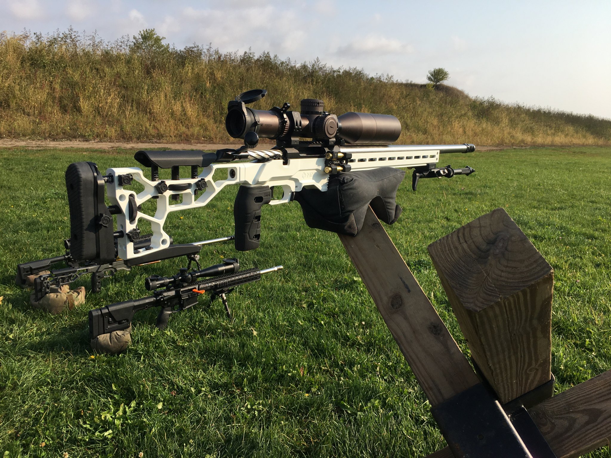

I'm a die hard tikka user, and have been using the T3 action in one form or another for about 20yrs at this point. My original T3 was a 25-06, had it faced off and now it's the base for my comp gun. Probably has about 10k on the action and trigger. That action setup is as smooth as any other custom I've come across, no exceptions. The one area that they win is bolt lift, even with a longer tac handle on the tikka. A 90deg custom just has less work to do since you can spread the lift out across 90deg instead of 70deg. The tikka loses nothing in parts availability short of a trigger, but then the stock trigger can easily be made to be very clean and light with just a spring. I've thought about a custom a bunch before, but can't bring myself to spend the extra 800-1k and gain no real function advantage. Find a pawn shop tikka and build it, save to extra for barrels.
I started on a Tikka TAC-A1 in 6.5 Creedmoor and it's definitely one of the better factory platforms to start on. Now, my Tikka is in an ACC chassis with a Timney T3 trigger, Benchmark barrel, and APA brake on it. After market parts are plentiful. I've been running it for 4 years and finally decided to build a full on custom gun a few months ago. I can say that you're not missing out on accuracy at all. Tikka factory CTR magazines can be finicky, which is why I moved to the ACC chassis in order to use AICS pattern mags. The bolt throw on custom actions might also be improved. My T3 has around 5,000+ rounds on it so it's very smooth. I went with a Lone Peak Fuzion on my custom build and have tried out a handful of other top actions. Sometimes the Tikka felt better than custom actions, other times not so much - but my Lone Peak and a few Impacts that I've run were unbelievably smooth, reliable, and a noticeable improvement. A few times my Tikka's bolt throw encountered binding in adverse conditions. I'm still not 100% sure what caused this, but I found that if I run the bolt slow and deliberately - this goes away. You could definitely win a match with a Tikka if that's your bag of donuts. For target or hunting, I wouldn't hesitate to get another T3. They're a solid platform.
