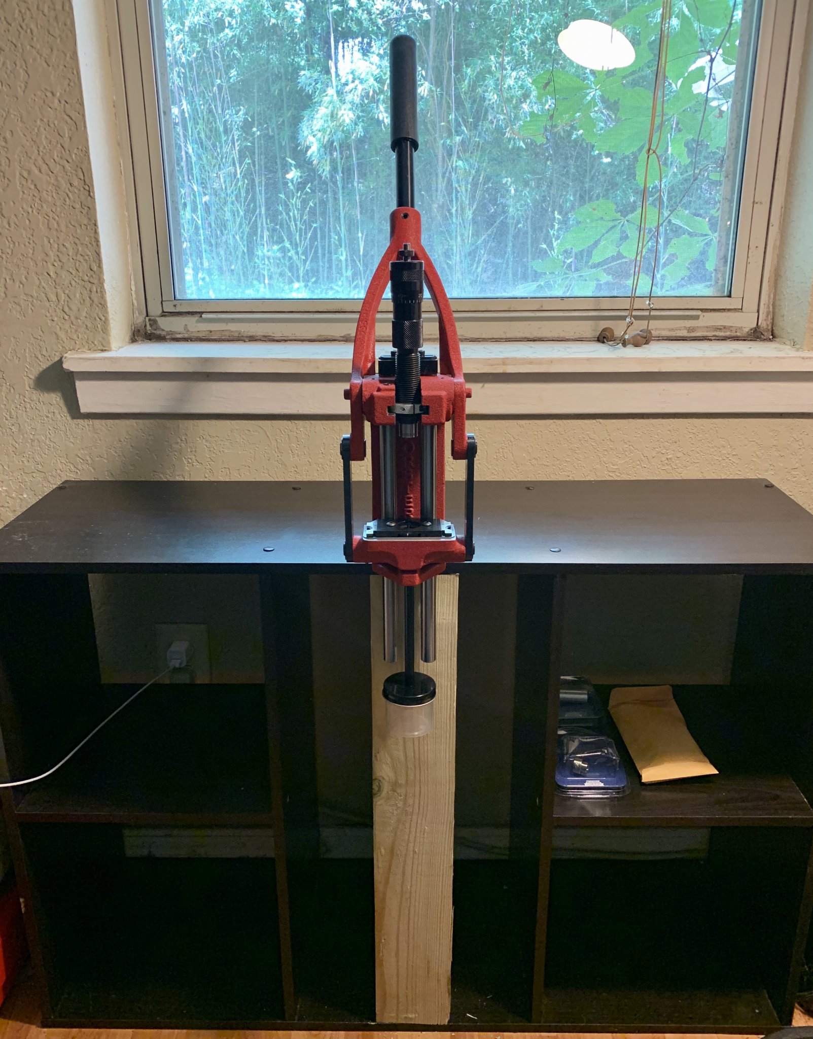

    So it's a little janky but the portion of my shop that I was going to set-up for reloading has some serious structural (read squirrels wrecked havok with everything) issues so I have a lot carpentry to do... In the meantime I remembered the spare bedroom / computer room has a crappy little cubby style sortage unit. Added a 4 x 6 to it where the press will set (need to paint it), lagged the 4 x 6 on both ends, and lagged the unit to the wall, and mounted the press. Pretty damn solid to be honest and TV, climate control, and the storage nooks are nice! Just need to add a power strip and see if it works!
    Does the handle clear the die? or is that just the angle and some photo-trickery that I'm seeing?
    Reactions: nikonNUT
    It is the weird-ness of the handle being tipped back past vertical plus the angle I took the photo at. It clears the die just fine. :)

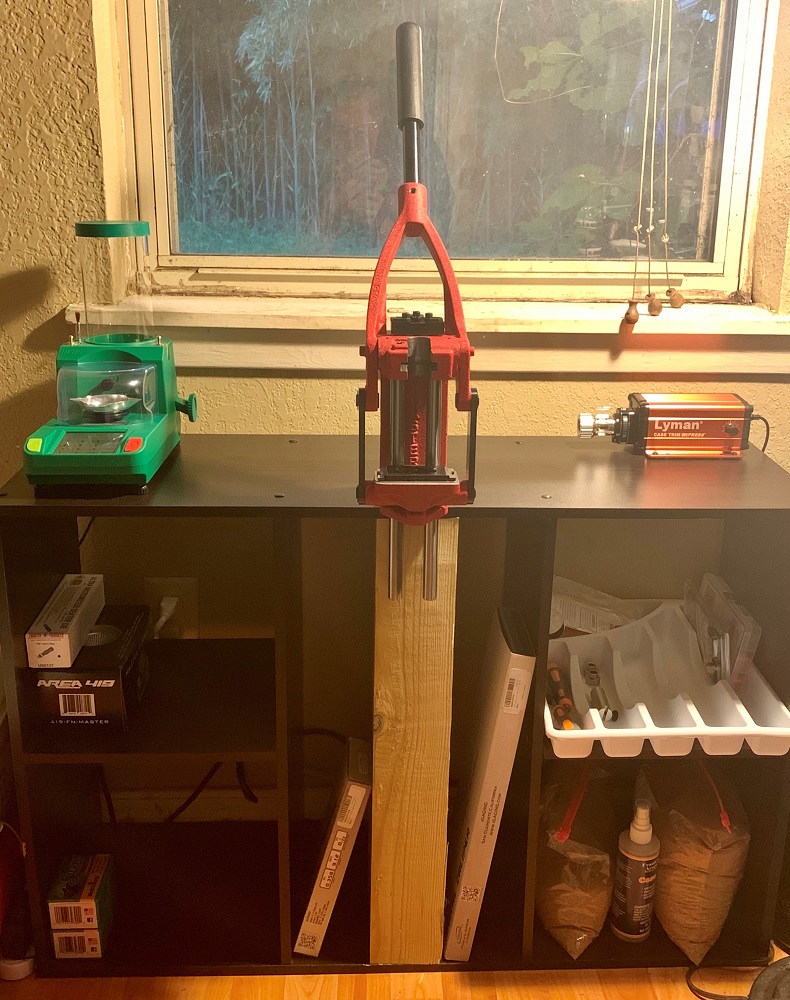

    Well it's starting to look like a reloading room! Or a tweaker shack... Not quite sure yet. :lol:
    P.S. FYI I'm too fat to be a tweaker!
    Reactions: Ravenworks
    I didn't see it mentioned, but a powder funnel will make things easier/faster for you.
    There’s an Area 419 funnel hiding on the upper left hand shelf :)
    I saw the Area 419 box there but didn't zoom in to see that it is a funnel.
    I have the same and it is a joy to use. Hard to get excited over a funnel but it is really good.
    Not gonna lie... I got excited over that funnel. :LOL: The machine work is beyond exceptional!
