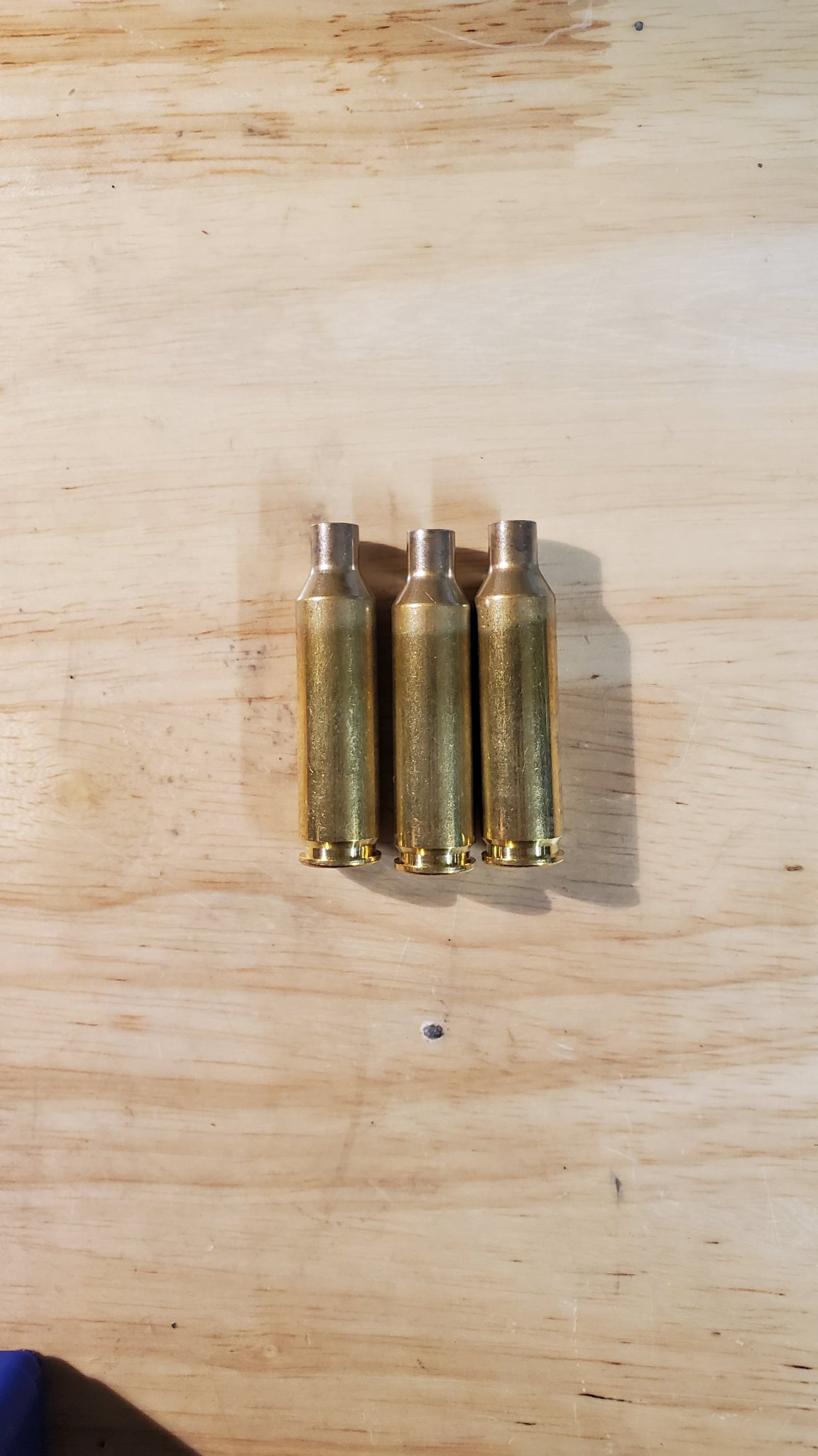

    Below is three pieces at 0167 code

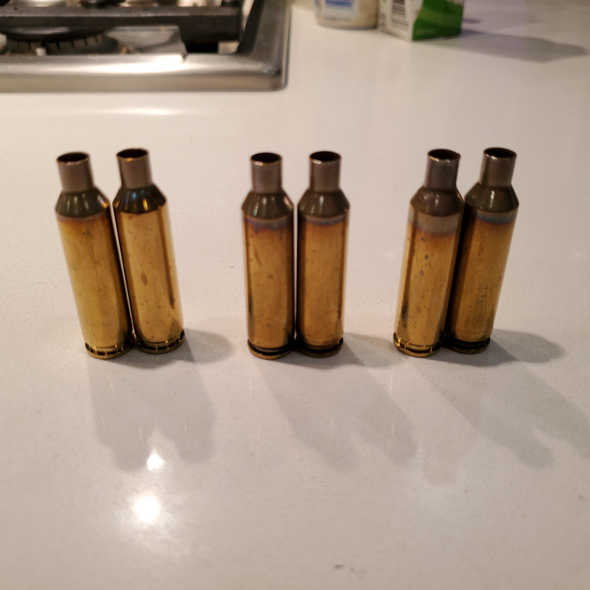

    Update:
    I reached out to AMP to share my experience with different Aztec codes. They were also confounded and suggested it had to be different headstamped brass, different pieces of brass from different lots...or variations in individual pieces from the same lot - though they didn't really see that being the case from quality brass like Lapua. I showed them that all 400 pieces I have were from the same lot they once echoed some of the comments. I'm not going to put them on blast or share their entire email here, but if anybody wants a PM I'm happy to share what they said. What I will say is that they attest to their product's accuracy and believe it is the brass.
    AMP did submit hat they would expect 6 Creedmoor Lapua brass to be much closer to the 0167-0172 range than the readings I got in the low 0150s.
    I went ahead and annealed two pieces at 0152, 0167, and 0168. I know "color and appearance" are not indicative of proper annealing....but here were the results..... 0152 came up short?
    At this point I know I should probably take five pieces of brass measure neck thickness etc and then record the Aztec code for each. But I really don't want to waste even $6 in brass doing that. Likely, I'll just stick with the 0167 for now.....

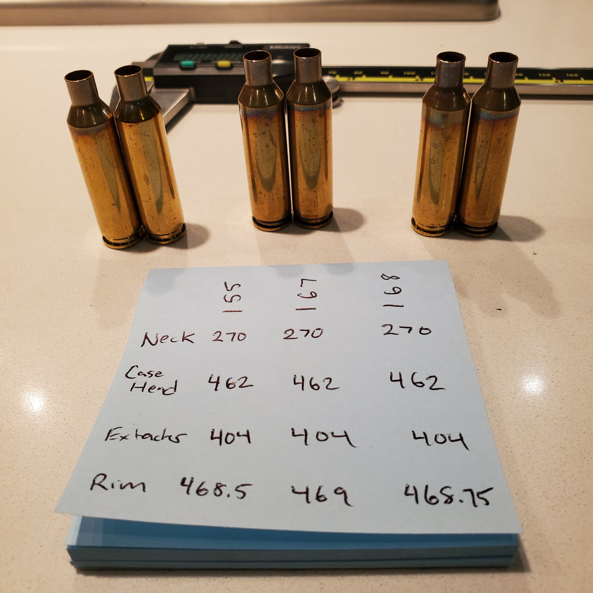

    FWIW, here are the measurements. I dont see how they would really be different given thwy were all fired in my chamber and should size out to the same. The weights did vary across the 6 within reason.
    168.72 / 169.14
    168.52 / 168.86
    169.60 / 168.72

    Trust me...my goal was not to measure items just so I could not know the relationship between any of it and my Aztec results. But....I did it because I saw the replies suggesting it and thought I'd appease.
    Right or wrong...for now I'm going with 0167 :)

    And the ones that you already analyzed (and produced different settings) were all 404/468?
    Likely....
    but The ones I analyzed are nuked and dimensions might be off now...probably still sitting in a tray on my bench and I'll grab them.
