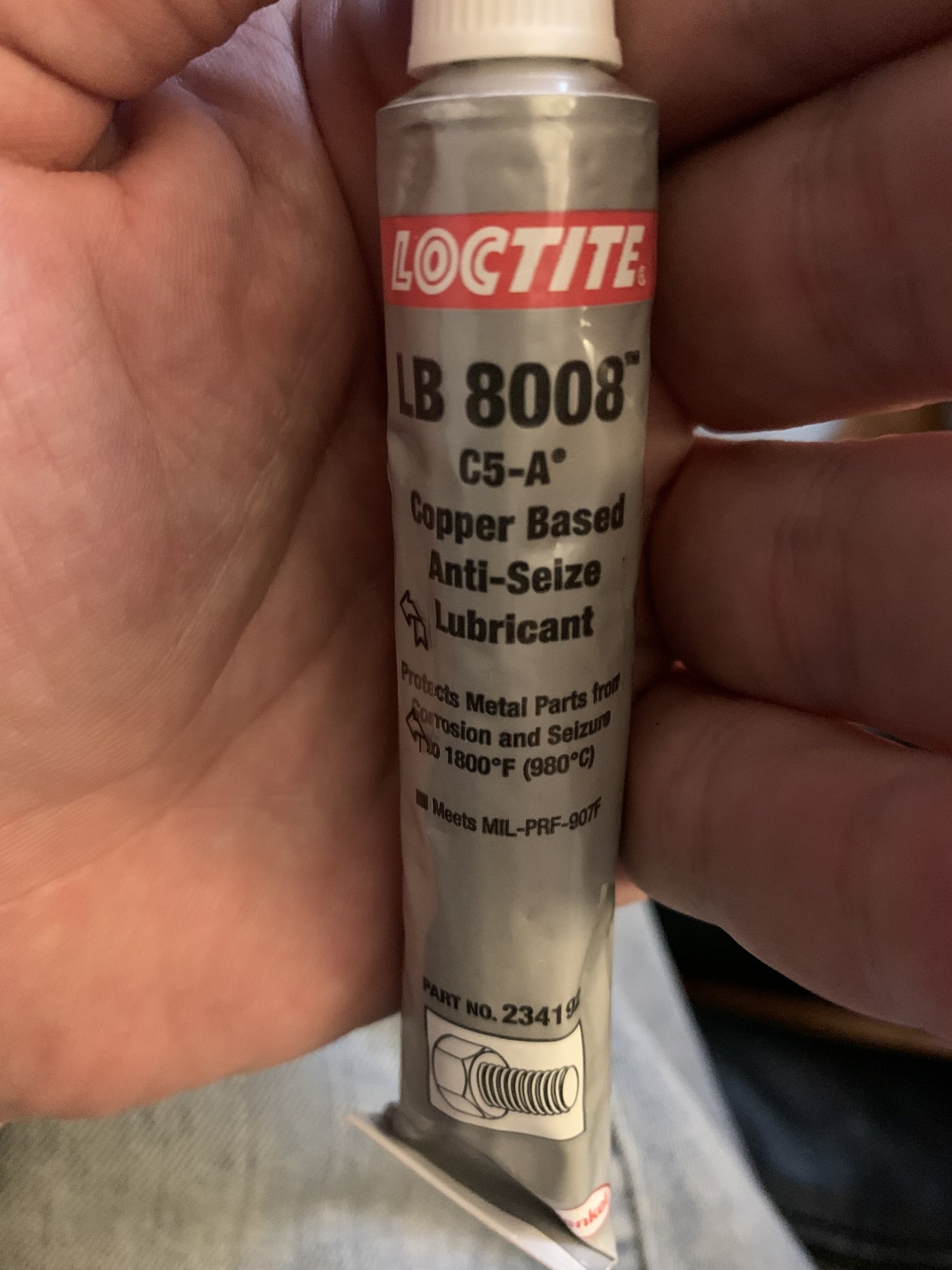

After our last go-around on this topic (sometime last year, perhaps?), I've been using Loctite LB 8009 Heavy-Duty Non-Metallic Anti-Seize:
The manufacturer claims that it "[p]rovides outstanding lubrication for all metals including stainless steel, aluminum and soft metals." This seems relevant to my interests.
