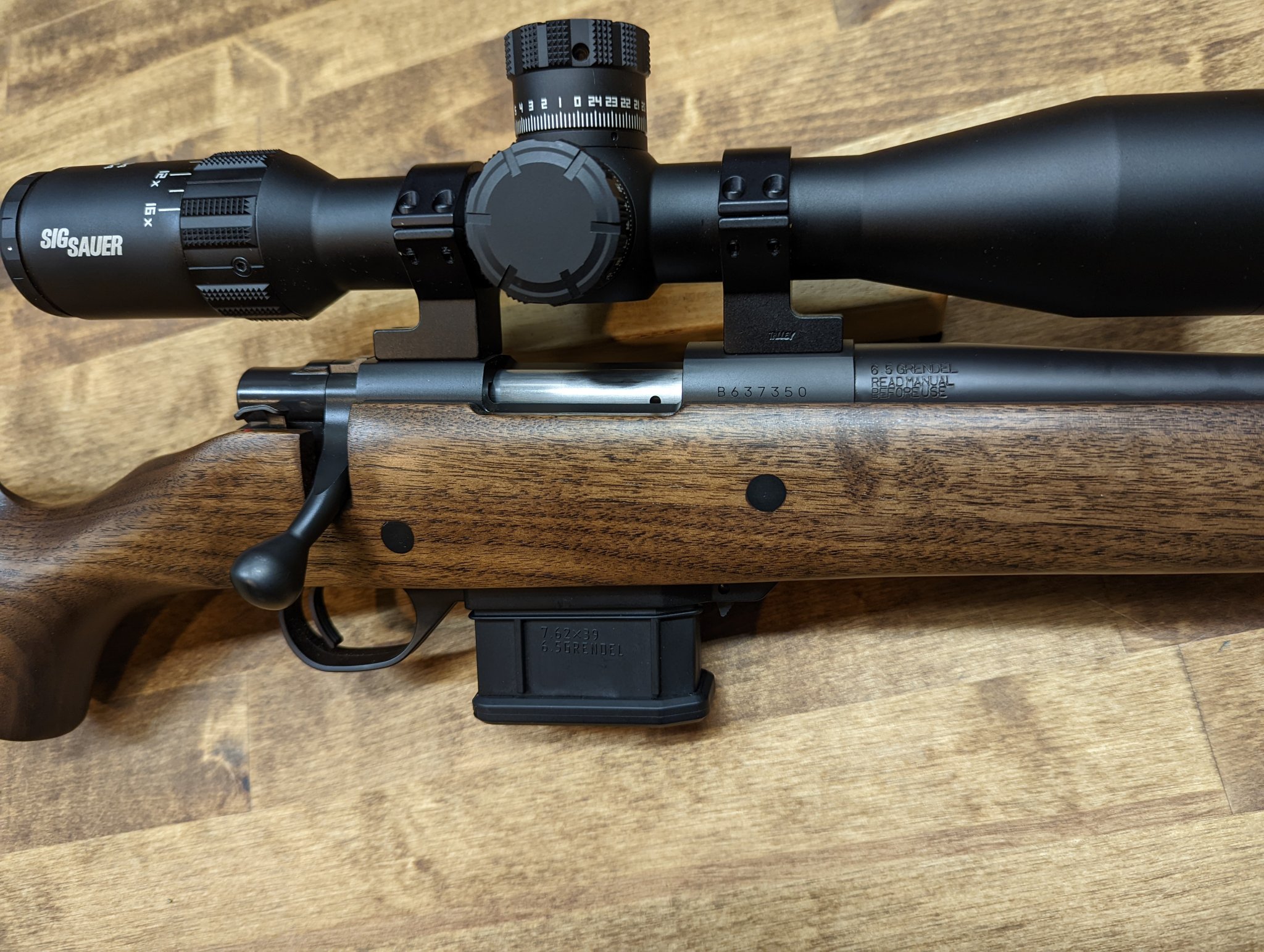

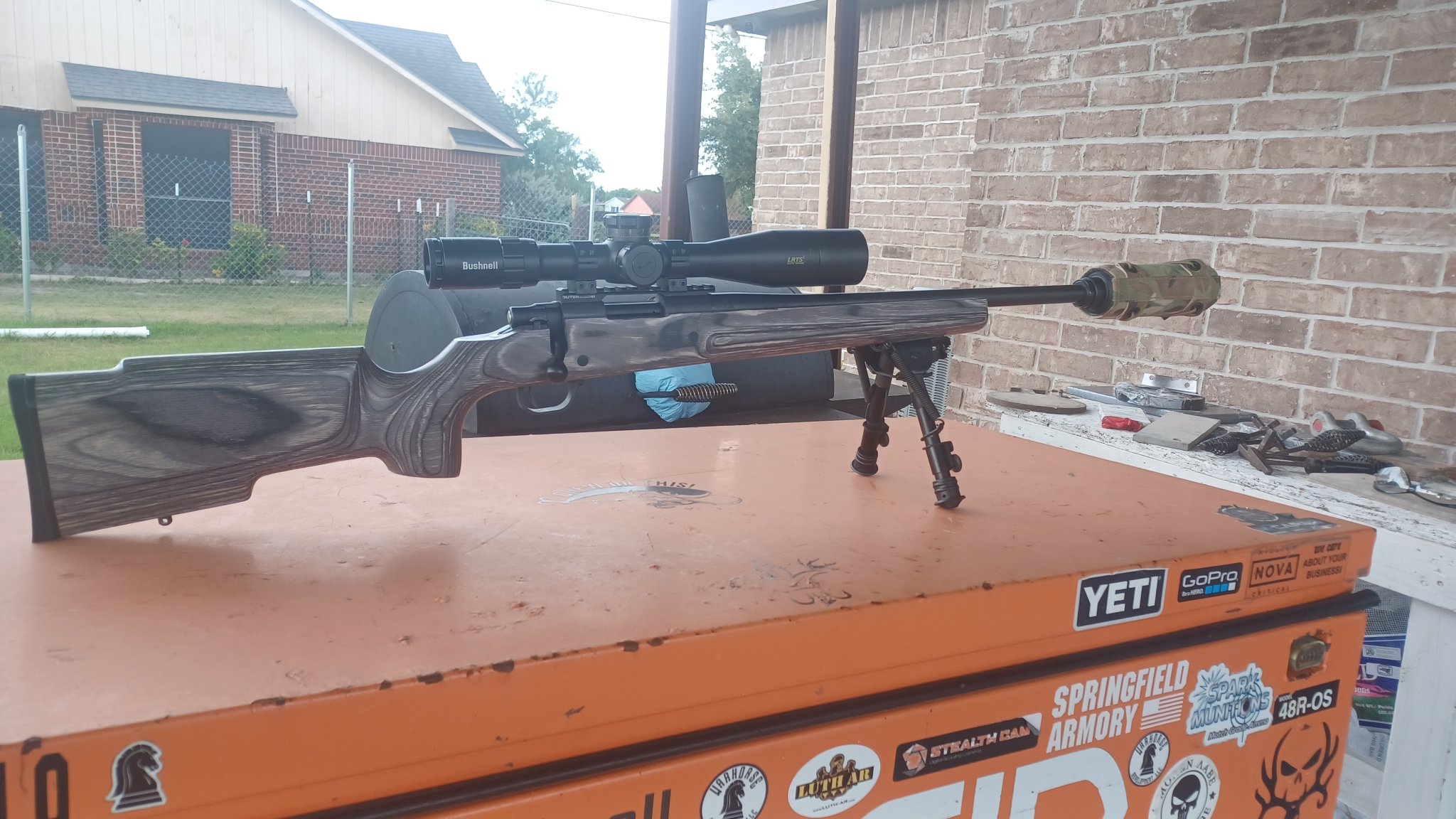

    The one I built for my dad
    VS the one I bought after the fact
    The one I bought new has some finish on bolt and it looks shitty. The one I bought from here has a stainless bolt and they are worlds apart!
