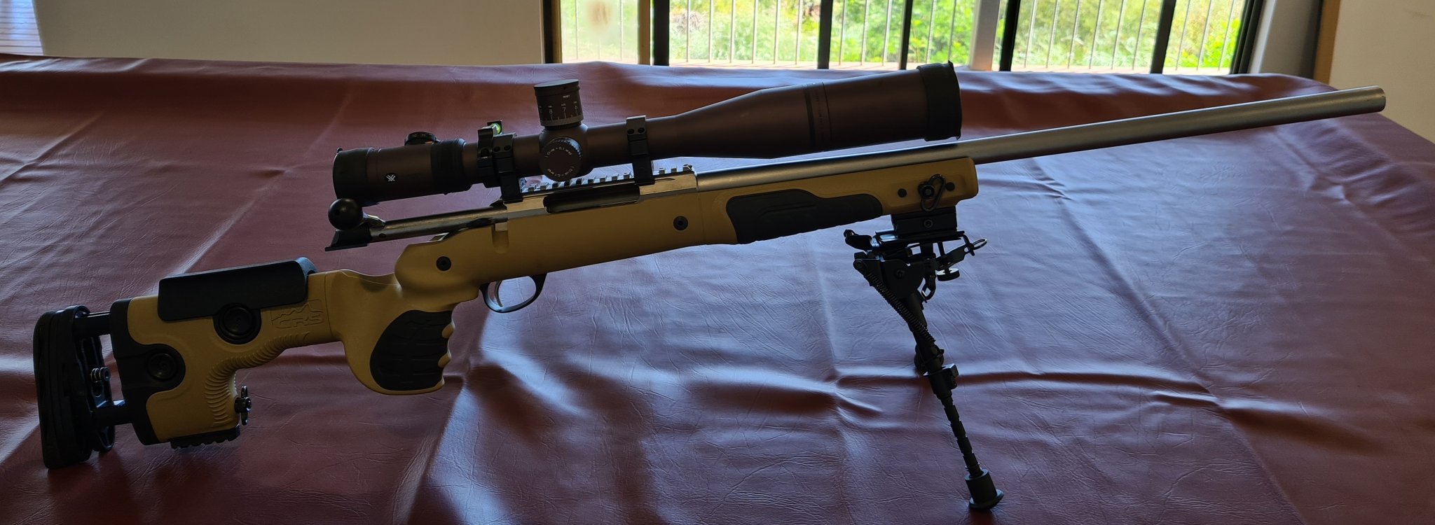

My Tikka T3 Tac A1 cost me 1800 and it is Left Handed. KRG makes a Stock that even takes CTR magazines which I had a Tikka T3x CTR and I like the 10 round Tikka magazines which I like better.

I put it in a GRS Bifrost stock, most comfortable stock I have ever used.
