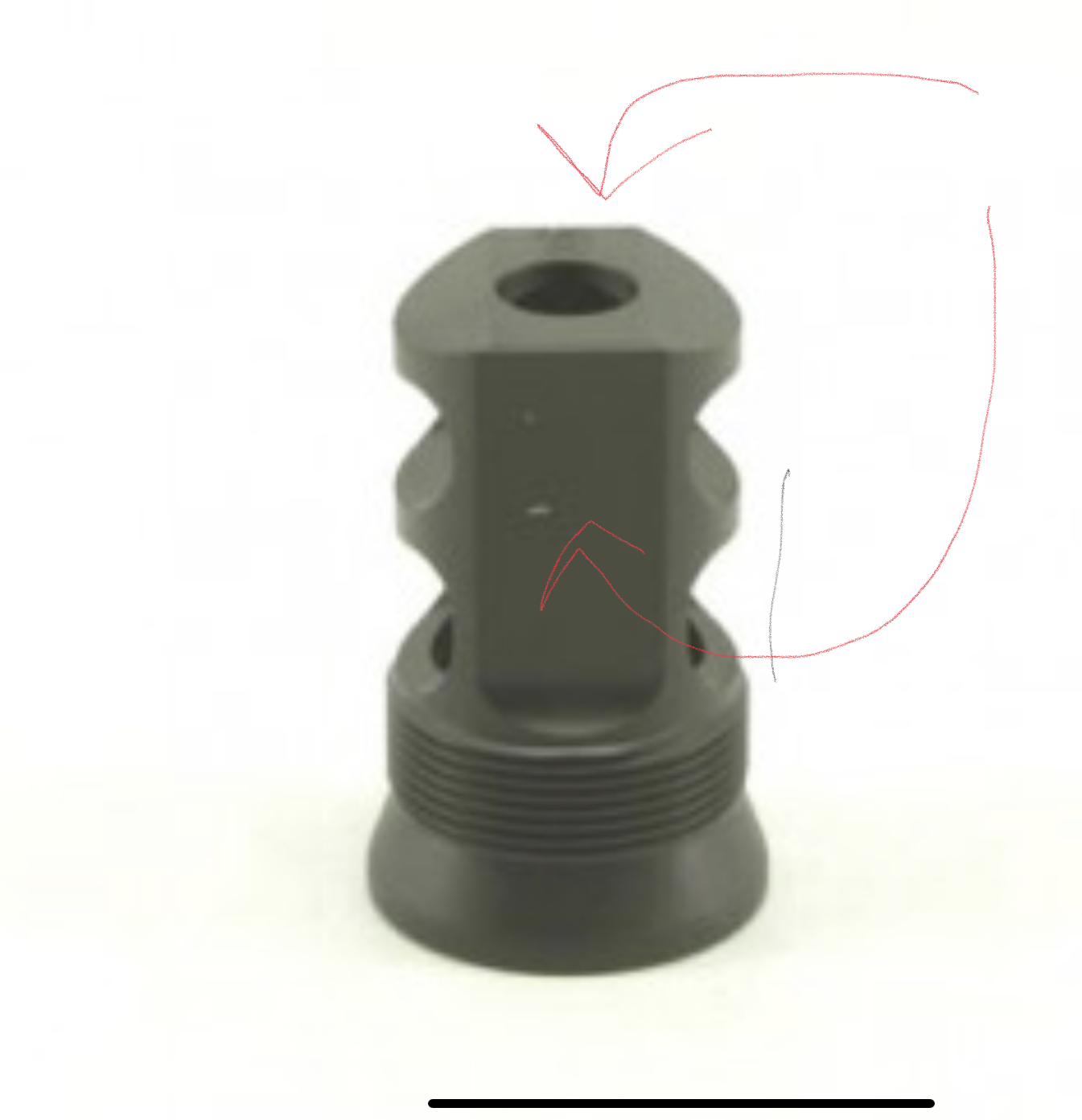

    There are no wrench flats on TBAC CB mounts
    Um. The whole brake area is flat on top and bottom.
    Or do you want a tool to get a stuck brake out of the can when you fail to follow the manufacturer’s directions for securing the mount to the muzzle?
    Reactions: Charger442
    Your presumptions are both false and rude
    Please, set me straight.
    There are wrench flats on the mount.
    Manufacturer guidelines say to red loc-tite the mount to the muzzle.
    “We recommend Loctite 272 (high temp, high strength) for mounting our CB and BA series muzzle devices to rifle muzzle threads”
    So, it seems like you are asking for a special wrench to correct a user error.
    Right, I've followed the directions, and still got one stuck. Do you want that torque going to the barrel? Receiver? To the barrrel extension pin on an AR? Or add a couple flats and isolate it to the muzzle. The point is, it costs almost nothing to include flats and I have a myrid of reasons why they should be included.
    Reactions: reubenski
