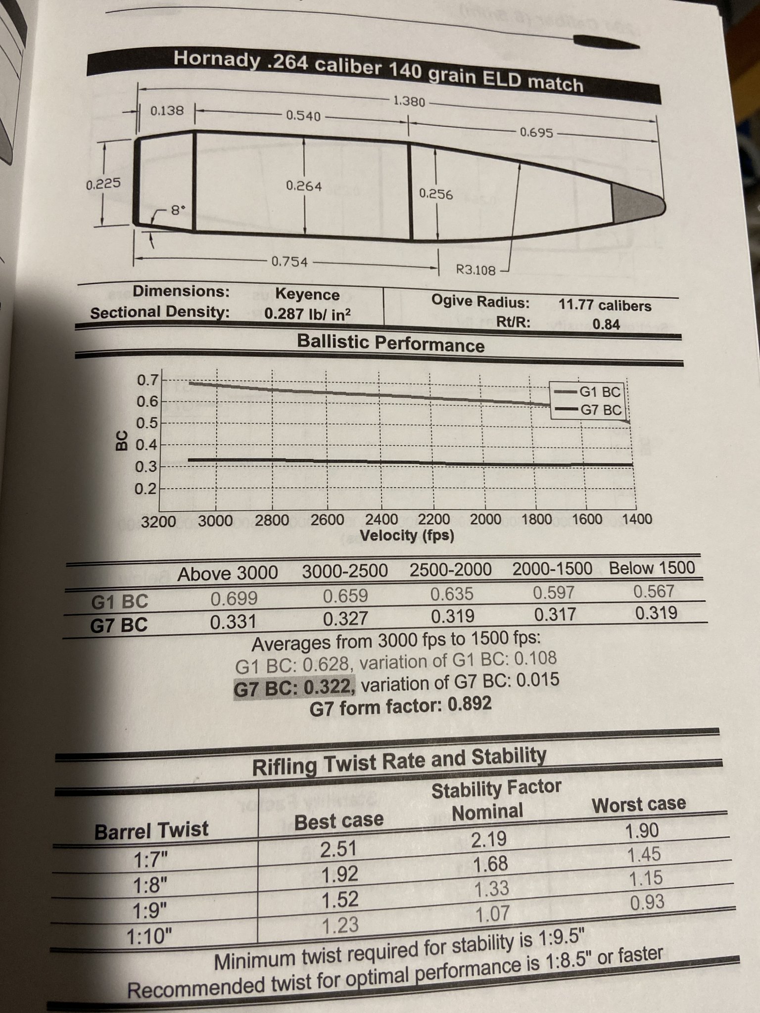

I've been using Trasol for years with good results. The ammo I use has published banded BC (Hornady .264, 140gr ELD-M) and I'm curious how this might look.
What ballistic solvers/apps utilize banded BC functionality? Another option is to try 4DOF, which doesn't use BC at all?

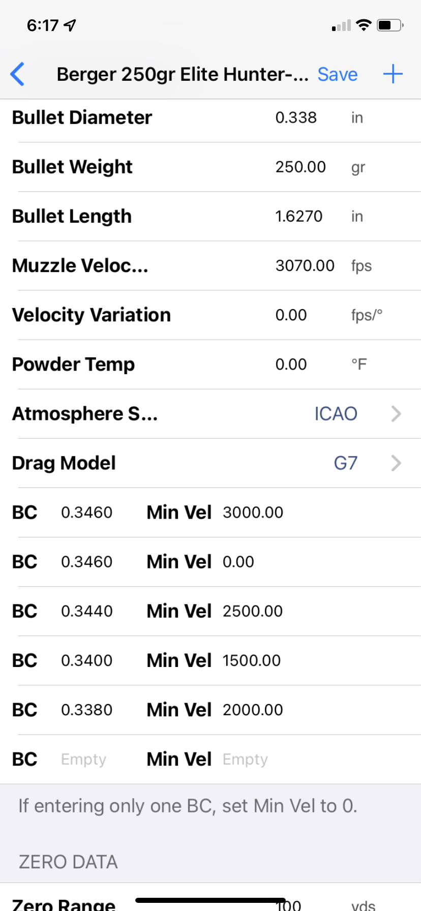

Strelok Pro, Shooter (basically an early version of AB), GeoBallistics (can use 1 rifle for free).

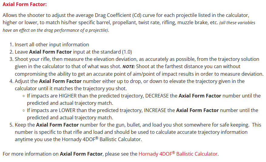

I've been playing with the 4DOF and comparing against what I currently use (Trasol). The results are similar. But Trasol's interface is so much better and easier to use. And I have to really go in an alter the data for each distance in 4DOF to make it line up with Trasol, which is spot on in the real world out to 1,000 yards. So if 4DOF and banded BC is supposedly better, why are the ballistic solutions off? I need to play around with it more.
And the reason I'm even looking for a different option is because I was contemplating getting a Kestrel with either AB or 4DOF so I wouldn't need my phone. There's no way for me to test out AB before buying (their online calculator is broken). And 4DOF only seems to line up with my DOPE after going in and doing a deep dive to change things at each distance and it looks like I have to do that each and every time? But I'm not super familiar with the app yet.
