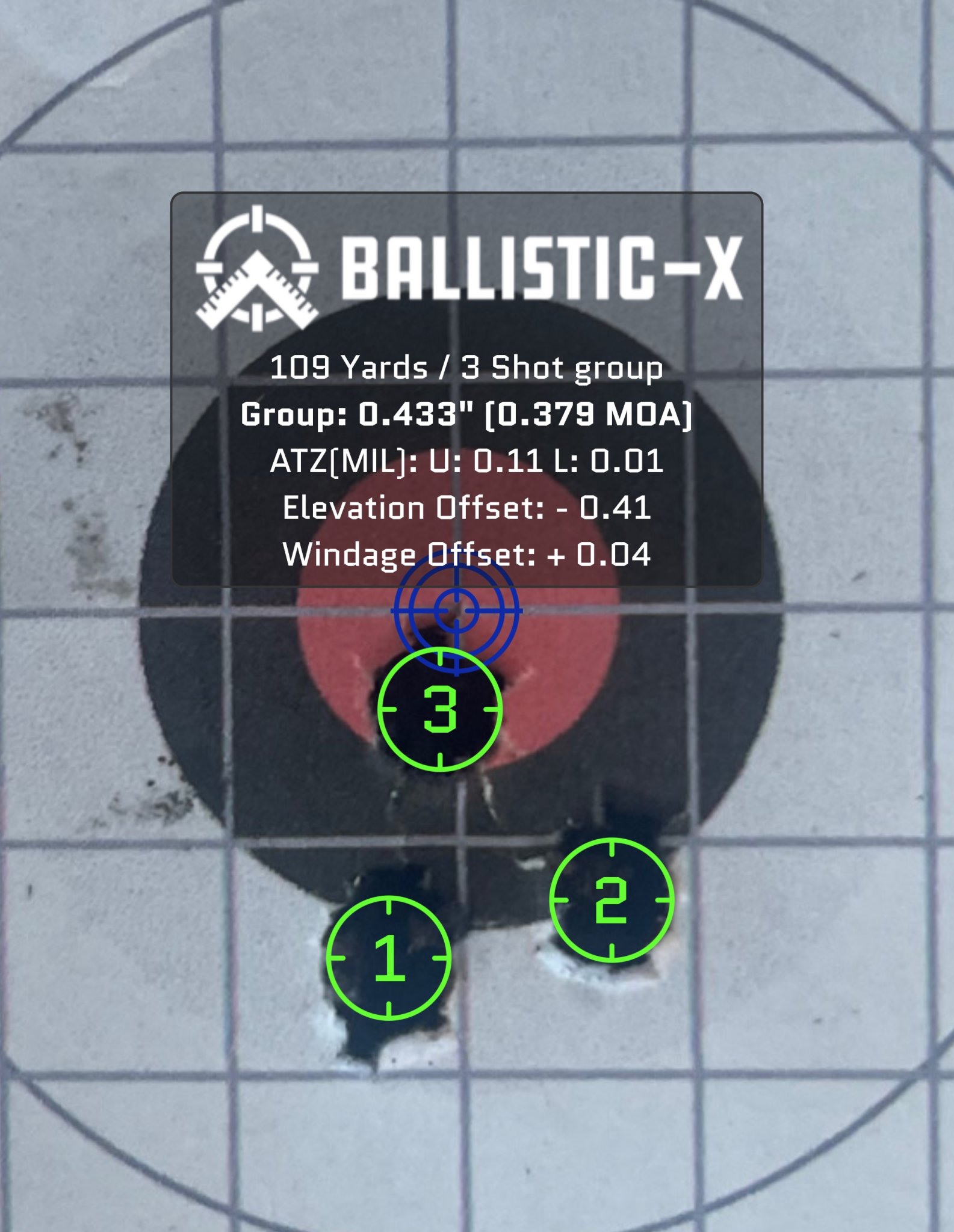

I’ve tried quite a few large frame barrels and can add a little insight on options:
Ballistic Advantage Modern Series 18” .308
- ok, shot around 1.2-1.5 MOA
Ballistic Advantage 20” bull barrel .308
- returned because bolt would close on NO-GO and Field gauge. Took a refund and stopped using BA barrels
Fulton Armory Criterion 24-inch .308 Win
- barrel shot well, usually MOA or better. I’m kinda annoyed with Fulton Armory though because he wouldnt sell me anything directly because I live in IL. Very odd.

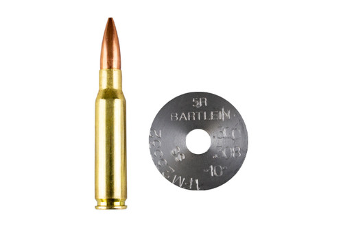

Craddock 20-inch Bartlein in .308
- out of the box, hammered with match ammo and a few of my reloads shot 1/2 MOA or better. Took this barrel out to about 750 yards no problem. 1 odd note about this barrel is that it developed carbon ring issues
Proof Research Stainless 24-inch 6.5 Creedmoor
- Accuracy out of the box was excellent. Shot 1/2 MOA right out of the gate with a random load I picked (140gr ELD / 41.7gr H4350). I did however have cycling issues and found that my gas port needed to be enlarged.
For less than $500 I think Proof stainless barrel is a solid option. The Craddock is great too, but will be around $700 or so with a couple months wait. As far as Ballistic Advantage barrels, I personally won't use them again for anything where I want a precision focus.
